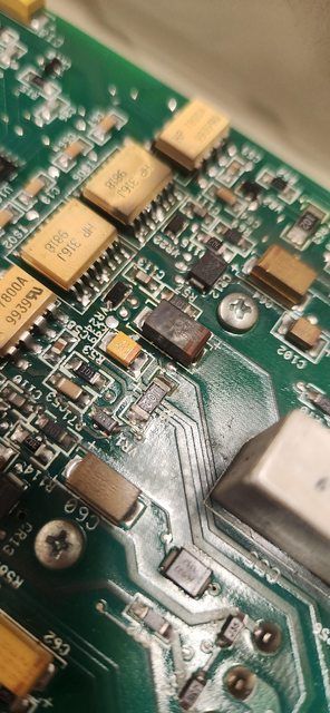

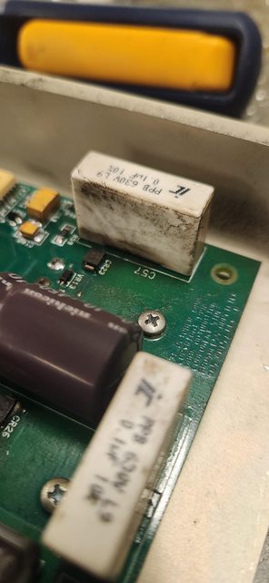

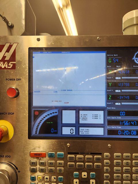

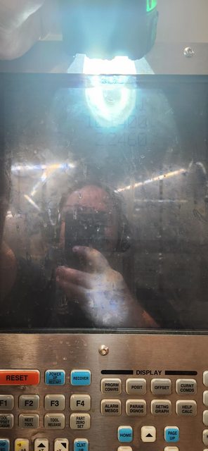

Greeted this morning with a z axis drive fault in our Haas VF2. Spent some time diagnosing that, and swapping servo amps to isolate the problem and save a service call, then the screen on the VF5 went black, so I spent some time digging around and figured it was just the LCD backlights that went out. Haas wants $1000 for the entire screen assembly, but I found just the backlights for $77. Still waiting on a quote for the servo amp, but I'm guessing around $1000-1200 from the last one I swapped last year in the vf5.
We used to have a guy that rebuilt them 10 ish years ago, but he's no longer in business. Would love to find another, or be knowledgeable enough to do it myself but I'm not quite there in my electronics knowledge yet to be confident enough to not fry someone elses machine......If it were mine, sure I'd roll the dice and poke around. There are some caps on the board that look like they got pretty warm....It's 23 years old.....If I had to guess just by looking at it, I'd start there and see what else got fried when they did.
VF5 still works, but it's pain holding a flashlight up close to see the #'s. Luckily muscle memory lets me move around the menus pretty good blindly, but for the onsee twosee stuff I'm doing right now it's a pita. It's funny how much of it is simple repetition though. Got through the entire power on, door lock disable, and homing routine with warmup first try with no light lol.

No brightness adjustment on the LCD VF5. We had a power outage last week, and the screen developed a slight pink hue in the one corner that stayed when it came back on. Found a few posts on PM and other places outlining the same symptoms and fix, so I'm pretty sure this is the cause. It could also be the inverter board, but I didn't have a multi meter to check it's output today, so I gambled on the cheaper fix lol. For $100 shipped for the backlights, I'll give that a try first.

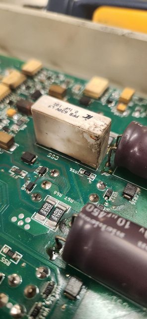

Just taking a long shot from way out here but you mention that the LCD of the monitor still works (no back light) and the 23 year old caps look like they got pretty warm, would they be electrolytics? Are they bulged? I think your instincts are correct, those are flags that have me replacing caps in the inverter power supply.
I have seen so many electrolytics, typically in power supplies, that have bulged and often split the ends where they are scored in a cross. I'm sitting in front of two monitors right now that cost me maybe $10.00 between them for caps, the office was going to throw them out.......

2 separate machines/problems. The caps were in the 2000 VF2 servo amp. The backlight was in the 2008 VF5. The inverter board in the VF5 looked great.
Those are a few of the suspect findings on the amp board. The backlights are ordered, servo amp not ordered yet ($1200 plus core). Decision out of my control now. The shop managers will talk it over for a week, then ask me what I think again and just do that lol.

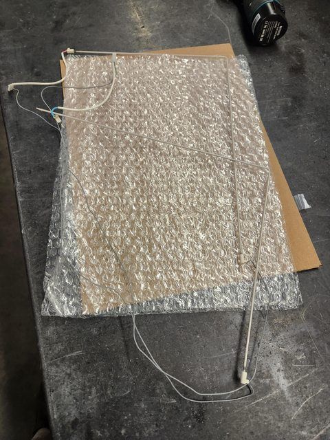

LCD Back lights, and servo amp arrived this morning. If I would have known I wouldn't have drank 6 coffee's this morning trying to wake my brain up, but it went ok. They are very tricky to install, especially with shaky hands. Would not have wanted to perform lifesaving surgery today that's for sure. lol
Those are the old ones. Tiny little CFL bulb with a 90* bend in it x2. I did break one removing it, but the re install went much better. Especially once I got it apart and could see how I SHOULD have done it lol. No pics of the install, just wanted it done.
This was a bit of a gamble that paid off. I didn't have a scope to check the inverter board output (nor do I really have the expertise to diagnose at the level......) and make sure that also wasn't the issue, which it could have been, but this was the cheapest part to throw at it, and my confidence was helped by two similar threads on the web both stating the same problem (pink hue) and same fix. I've read conflicting info about the screen going into fault mode if the inverter board is not working, so the fact that the screen was still working, and I could use it with a flashlight held just right, also gave me a bit of confidence that the problem was in fact just the backlights.
Servo amp installed in the VF2 also, and it's back up and running. I did a little bit of everything today, from fixture design in the morning to some programming and machining, to machine repair. Sometimes I love the variety of my job. I need to fix a leak on the pressure switch on one of the compressors too, but there's a machine running a longer cycle. Might duck out to the driving range and hit some balls, then come back later to fix it before going home. :D
