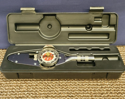

Hi,
I need a torque settable/adjustable screwdriver to tighten in the range of 1ft pound to 5 or perhaps 10 ft pounds. There are a lot on amazon - not sure what to get. There is a fancy wera brand at kms tools. $90. https://www.kmstools.com/wera-series-7400-kraftform-adjustable-torque-screwdriver.html but it only goes up to 29 inch pounds. Any leads people? It would be nice if it was not $100 but still decently accurate.

Drive torque wrenches with dial gages
Janger
(John)
Are you particular about the drive system - like 1/4" square socket system or hex? I saw those digital in-between boxes too, but they look kind of clunky for any kind of smallish work.
The nice thing about the needle dial indicator style is you can see the torque value increasing & just stop when you need to. A lot of these settable ones I think are meant to clutch out, more meant as over-torque protection once some value is set.

Why not an inch pounds torque wrench? 5-10 foot pounds is 60-120 inch pounds, and they make them 1/4” drive

I am a self confessed torque maniac. My career exposed me to its importance. We had an entire division of people in the fastener division that I regularly had to talk to because of torque issues. Most people totally underestimate the importance of torque.
I have and use the Wera screw drivers for low torque. I check their calibration periodically and they are always dead on.
For torque in the range you desire, I think you will find a "screw driver" a bit hard to use. I know it sounds low, but 10 ft lbs is a lot of leverage to apply with a twisting hand motion. For that range I prefer to use a much cheaper in-lb click style wrench like this:
TEKTON 24320 1/4-Inch Drive Click Torque Wrench, 20-200 in.-lb. https://www.amazon.ca/dp/B00C5ZL2EG/ref=cm_sw_r_apan_i_4YXX0DJM5GXSYT5YGPXS
I bought that exact model about 15 years ago on Amazon. So I was a bit shocked when I saw the current price. I do not believe I paid anywhere near that for it. I'm sure there are cheaper versions. But in hindsight, I use it so much that I would say it is worth that.
This style can also be easily calibrated. But torque in that range is much easier to achieve and most wrenches like this are plenty accurate enough.

So ya John, given your needs, I'd recommend that you get a 1/4" drive clicker wrench for the range of torques you specified. And don't forget to set it to zero for long term storage. Otherwise the springs in them take a set.
