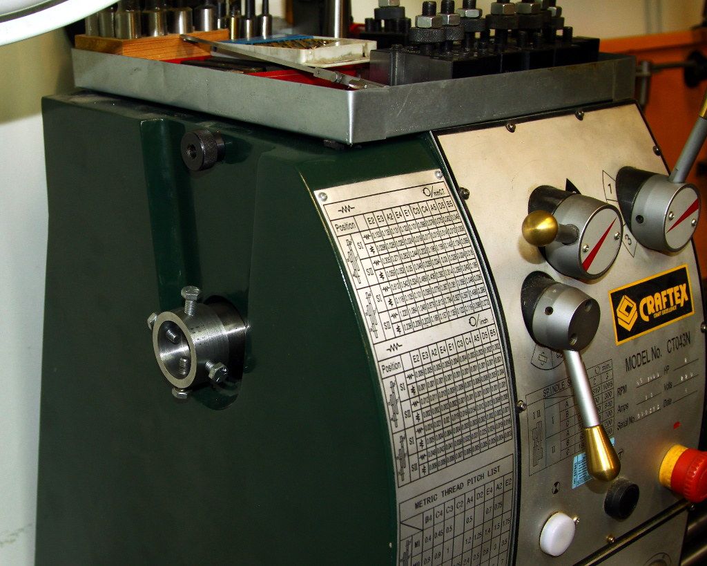

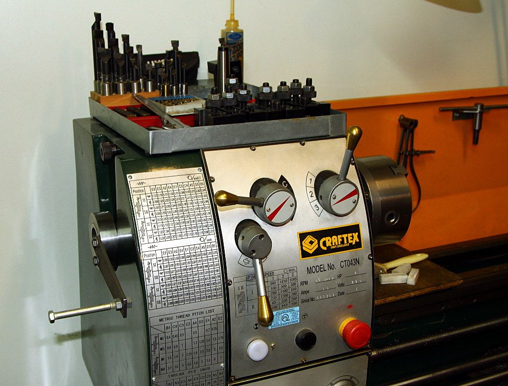

I made a cat-head to thread into the outboard end of the lathe spindle. I think that is the correct terminology
I also made a crank handle that fits over the cat-head.
I needed to cut threads on a rifle barrel the stop at a flange.
Make sure the lathe head-stock is out of gear and the breaker is off.

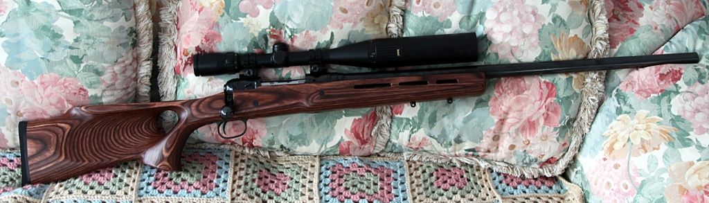

The last one I did lost accuracy because of throat erosion. It was a .223 Savage 12FV.
A small shank savage is 1.050" x 20 TPI if I remember correctly. It was 4140 not SS
I machined .200" off the breech end of the barrel and cut the chamber .180" deeper with a chamber reamer.
and cut '200 more thread on the barrel. A Savage barrel is retained with a lock nut.
It took a few tries but I got it clocked the same so the markings on the barrel were where they started
and I lost one proof stamp or you would never know I tampered with it.
It was once again very accurate.
Also a very nice rifle with a Boyd's thumb-hole!!

Fine looking piece I like Boyds stocks I think they're very underrated. Wood feels better on the cheek @ -20C than glass or synthetic.

Thats the very first piece I built & threaded with my lathe to steady the outboard end of barrels in the headstock...and then was taught that barrel chambering & threading set-up is easier done with a steady rest.
I also added a handle and crank for the same reason you did and it gets used more for that than steadying a long shaft.
