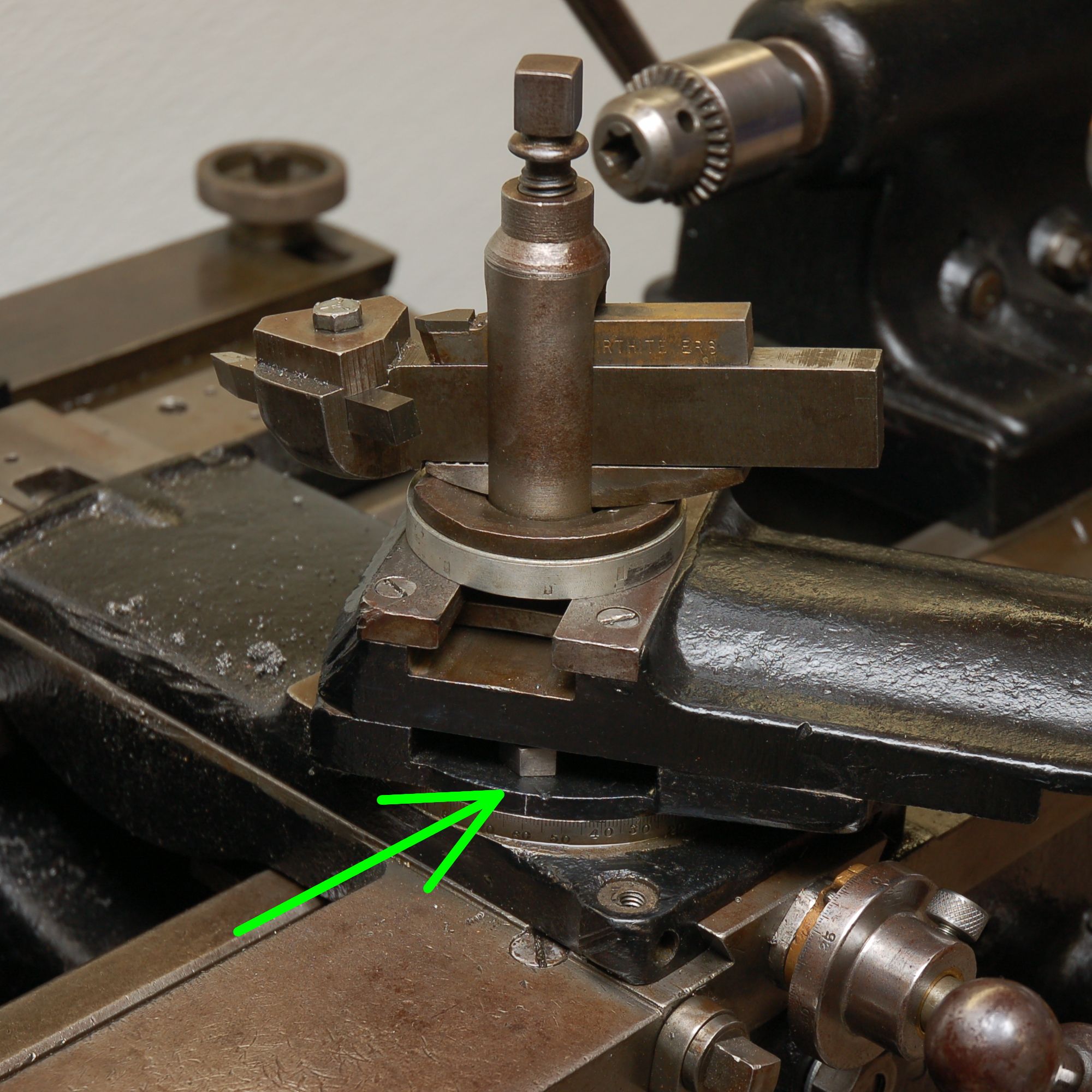

Just took a few moments over lunch to begin to dissemble and clean the new to me Tida-4A lathe i picked up yesterday. Taking my time I removed the tailstock, set it aside and started wiping down the rest. I took a moment to remove the tool post and noticed that the bolts in the compound looked shall I say "too shiny" and out of place. A closer look and it is obvious these along with their washers were added at some point in its life and appear to be hand carved (file, grinder) with matching washers with flat sides as well. I've found the parts diagram for the lathe online, but it doesn't reveal anything more than there is in fact two bolts in this location.
I know finding replacement original parts is essentially a unicorn hunt, but I'm wondering if any of you have had to replace these T bolts and nuts before on any of your equipment, and where you may have found a selection. I am unsure of the original length, but its obviously a part that as long as its long enough, its long enough to work.

"the bolts in the compound".... you mean the bolts that clamp the cutting tools in the tool post block? Or maybe bolts that secure the compound at its angle (and they typically engage T-nuts)? Yes a picture with a big red arrow would be helpful :) Anyway, guessing Door#2 - many lathes use regular hex head cap screws. Taiwan lathe, could be metric, probably metric, but could be Imperial, hopefully 'shiny' doesn't mean the previous owner didn't pick the wrong one.

I think he is talking about the compound angle bolts. Something along the lines of this?
If so, they tend to be a bolt with a T shaped head, which can honestly be made from a grade 8 bolt and cutting the T into them on the head as long as you have enough meat to hold it after.

Hi guys sorry to keep you guessing. I should have included a picture. The bolt you have indicated with the arrow is the one I'm referring to. Slightly different on my machine, but same function. I do realize what I have there now will work, and does hold things tight, but my eventual preference would be to replace them. Here is how it looks in my machine.

Yup. I thought you were talking about your compound. I'd be interested in what your manual shows. I've seen 2 setups for this on offshore lathes: 1) what you have, T-headed bolts slide in a T-slot head down, threaded part protrudes up through the compound secured by nuts. 2) T-nuts slide in the T-slot & a common hex cap screw screws down into them to secure. That's the case of my lathe. System (2) is kind of a pita in one respect, the nuts can get out of alignment when you remove compound so you have to fiddle around. Its not a biggy & actually I solved this by putting in 2 crescent shaped spacers so they always stay clocked at 180-deg. But the hex bolts are easy to replace I easy to get at with an Allen key. Some solutions
- they do sell T-bolts for milling maching hold-downs, would have to check matching size
- turn up the correct part from round stock (will have to mill flats & thread the end)
- if you can adapt a standard T-nut or make one, you might be able to use that, then fix a threaded rod segment in there for equivalent result. I would ping the underside of threads to prevent threaded stud from turning when tightening.

You have to be extremely careful with T-nuts. I didn't know this until recently and luckily didnt learn the hard way, there is a reason T-nuts wont let you thread a stud all the way through, its to stop you accidentally bottoming out in the channel and blowing out the t-slot. Don't do that.. Personally I would just go with the t headed nut, whatever way you have to do it. Either make a whole new one, or take a grade 8 bolt and machine the head down to fit your t-slot and maybe harden it with a torch and some used oil. Its a pain in the ass to fit them when you will probably have to take the compound off to check it (and you might miss the first swing or two) but in the end clamping on steel isn't going to break anything, accidentally having the wrong length bolt might just destroy that track.
At the same time, turning bolts without destroying threads is a bit of a pain, one of the better set ups I have seen in the past was a coupling nut slit to act as a collet. Or, you can find a chunk of scrap, drill a hole in the center and tap it, then run your bolt in.
Oh, and in case you don't know, the point of the washers is so that the compound doesn't move when you start to tighten it down. Normally double stacked washers are used but a single does the job as well..

From what I can tell at this point, what is there is working and does hold without any movement. This I figure should be enough for now and I'll look at making a set of bolts later.... I see that I now must have a mill to make those square cuts.... haha.
Kyle, thanks for the heads up on blowing out the t slots. I like the idea of threading a piece of round stock to hold the bolt. Good tip!

What Kyle said about the T-nuts is exactly correct. I've heard of guys cracking cast iron tables if the bolts are allowed to pass through. That's why I mentioned "I would ping the underside of threads to prevent threaded stud from turning when tightening" if you made your own. If you look on the underside of typical commercial mill table T-nuts, they have a couple dents around the bottom 2 threads like they were hit with a chisel 'Ping'! :) These prevent the stud from screwing further & then turning the nut should only be putting tension on the stud...well... at least that's the idea. In the case of the lathe compound with through-bolts into T-nuts, you hopefully would not have this issue providing the bolts are pre-measured correctly so as not to bottom out, but its still a good safety measure.
I looked at the link pic & seems like topside nuts are what they intended.

Thanks Peter, now I understand exactly what you mean. That's a great idea, I can see how that would get annoying trying to chase the nut around the slot. I did notice the bolts in mine started as carriage head and they do fit in the grove perfectly, but I think that definitely invites the opportunity to over tighten and pull the carriage into the grove causing it to break.

@Matt_b_m this will be an awesome project for you for sure! In a permanent application like this, I'd put the all-thread into the t-nut to depth and then weld or braze it in. It's a permanent application so may as well make it a permanent fix.
