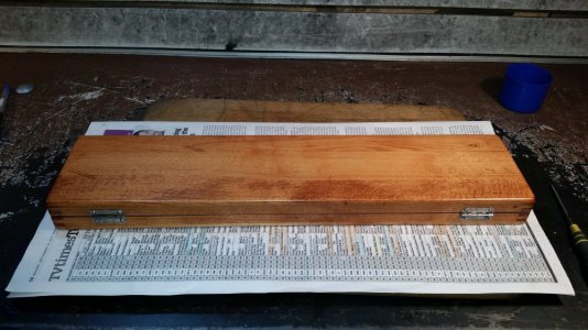

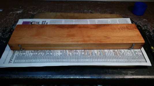

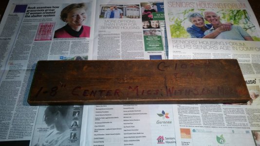

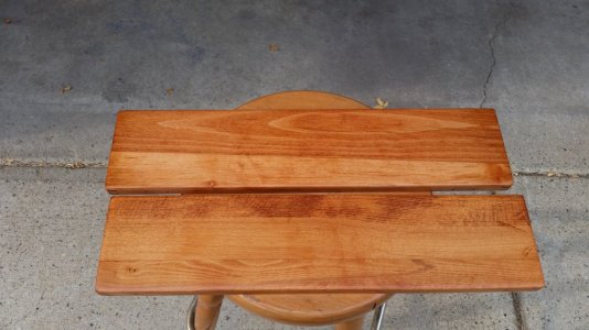

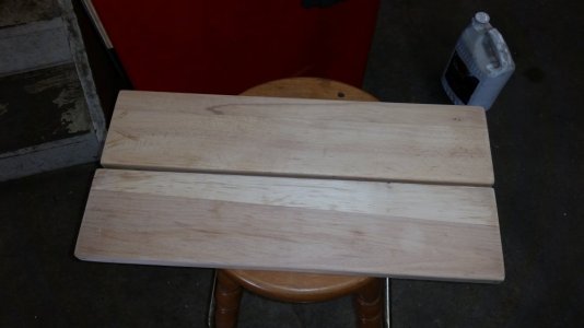

I got a good deal on a Sorensen Center Mike on eBay but the mahogany box was in rough shape. The finger jointed corners were all loose and the finish was in rough shape including some permanent marker writing on the outside. I re-glued all the corners then stripped, sanded and restained it then sprayed it with low gloss Varathane. I also cleaned up the measuring tool and gave it a good coating of light machine oil to prevent corrosion. The tool itself is in great condition, the only real flaw is a number someone engraved on it and the standard. It worked out nicely I think.
