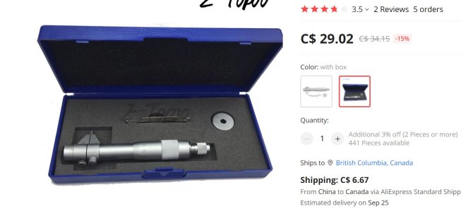

@trivn what is the advantage of your Mitutoyo Round Pin Inside Micrometer to calipers?
Never use one so I assume the round pins center quicker and easier inside a cavity!
The Mitutoyo round pins are more accurate because the circles make contact tangentially & with a little bit of wiggle they find the max diameter across the span. Kind of the same contact principle as bore gages which have hemispherical ends. The Mitutoyo also has a clutch for consistency. Its a great tool. Caliper inside measuring blades are OK for quick measurements, but its not really a good bore measuring device if you want to be accurate (say +/- a couple thou). The blades are sharp but are still rectangular in section under magnification. Hope this makes sense.

I have real trouble getting a consistent measurement with the calipers. If I was a little mis-aligned with the bore, the measurement would be 5-12 thous small. The two little pins seem to be much easier to get in straight and get a true measurement.

Just as I thought, I also have the same difficulty measuring with a caliper. Always end up doing 2-3 measurements sometimes more with none of them being the same numbers. Pricey little devils wish I lived nearer a good used market place.
https://www.kbctools.ca/itemdetail/1-808-145193

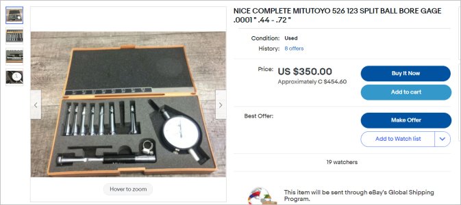

Why not just use a bore gauge if your trying to be super duper accurate ? Aren't those pin mics more for shallow hole where a bore gauge won't fit ?
Kind of depends on the part/application. The pin style is limited to shallow holes. But its reasonably quick & accurate. I don't recall mine having vernier on barrel so you are eyeing between the thou marks I believe. The pins kind of self align axially whereas bore gage or snap gage you swivel out & watch for maximum needle, so you kind of need a minimum depth dictated by anvils. If you are measuring a hole in a mill setup for example, the pin style body orients horizontally which is convenient, does not require the vertical height of bore gauge. Bore gage or snap gage can measure deeper into holes if that's the requirement. But depending on the bore gage set, minimum diameter might be say 0.8" whereas this pin style inside mic is 0.2". Bore gage is more accurate if you have say a tenths indicator mounted. There's also split ball gages which goto smaller bore sizes, nice but spendy even used.
