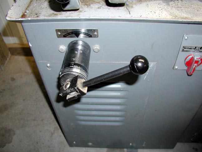

Is this the speed changer or what am I looking at here?

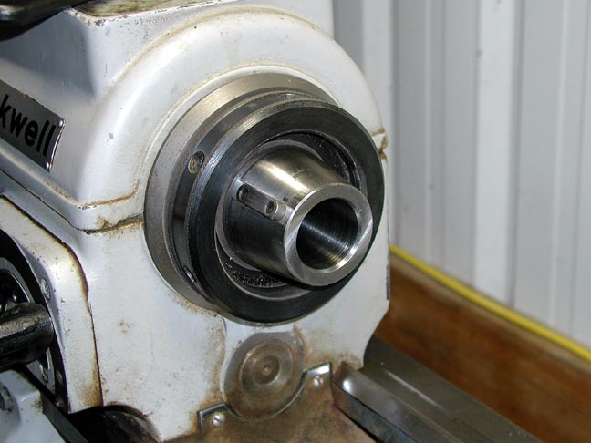

What kind of spindle nose does it have?
You mentioned collets one day, do you mean just getting a collet chuck & set or one of those collet closer thingy's?

@PeterT The lever you posted there is to switch between Direct Drive, Loose Spindle, Locked Spindle, and In Gear (low RPMs) The speed select lever looks like this:
(not a photo of mine, just Google Image Search) it operates this system:
122437d1416442169-mid-60s-rockwell-lathe-variable-speed-help-imageuploadedbytapatalk1416442166.067722.jpg
(again, not my photo) so that jack-shaft moves up and down with those two adjustable sheaves on it to change the drive-ratio.

Sorry @PeterT I forgot about the second part of your comment. I currently have a threaded spindle that accepts threaded chucks. It's a decent system, but it's old and it makes turning in reverse very dangerous since the chuck could just unscrew and come off. There was an option available on these lathes (at no extra cost apparently!!) to get an L00 spindle, which is a tapered spindle with a key on it. It accepts chucks with a ground taper in them, is very precise, and allows the use of collets mounted directly in the spindle (no chuck) which is very useful for a variety of reasons (holds VERY tight, reduces vibration, doesn't mark the surface of whatever it's holding, ultra-precise, allows for extremely quick changes or advances of material being machined...)
I can't find a photo of the threaded spindle (I'll try to remember to take a shot of mine when I have a chance) but here's one of the L00 spindle. There's one on eBay right now, but money is too tight to justify it (don't judge me if I cry)
