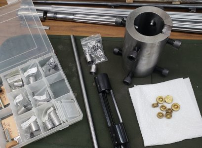

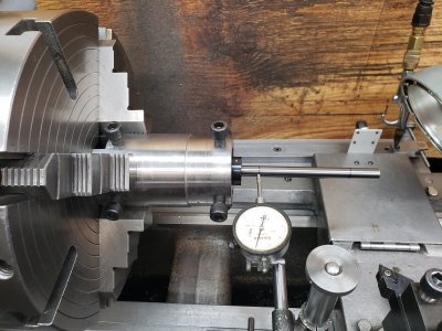

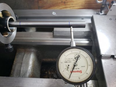

Yesterday I machined 10 flutes onto a barrel. Today we start the action and bolt truing. To achieve maximum accuracy in a rifle, all the surfaces which make contact with the barrel have to be true. The internal action threads, the action face, the recess where the bolt lugs lock into, all have to be concentric to the bore of the action where the bolt slides. They seldom are. So first we have to put the action into the lathe so we can do the work.

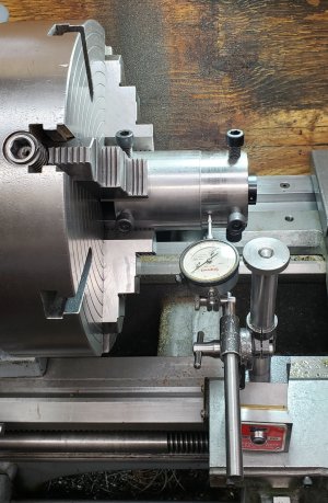

thestelster

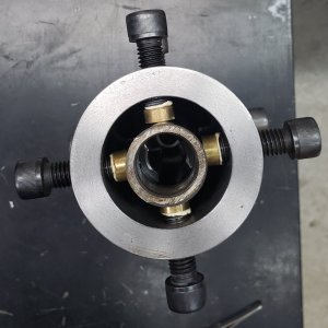

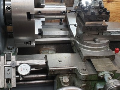

I purchased a number of 3/4" OD, 1/2" ID hardened bushings and using a mandrel, between centres on the lathe, turned them down to a number of different OD's. The bushings get positioned in the action, front and rear. The 1/2" dia. 12" long carbide rod goes through the bushings and sticks out past the action face. Then using a dial indicator you go back and forth zeroing front and rear using the spiders' 8 bolts. The spacing is 4". This takes a while! Once everything is is running true, pull out the rod, and now we can now start machining the required areas.

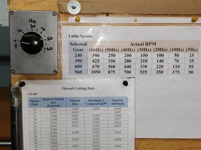

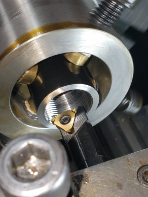

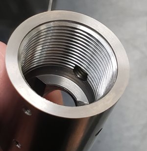

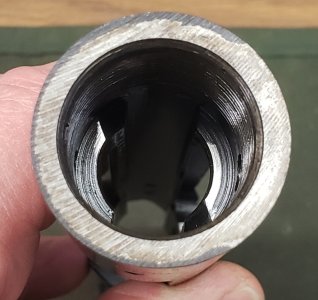

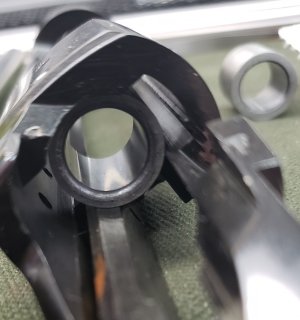

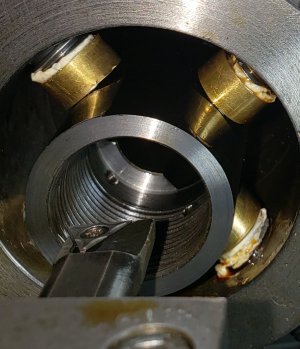

Once the locking lug recess, and action face is trued up, its time to chase the threads. If you thought cutting threads is tricky. Try doing internal, and virtually completely blind because the tools and holder and post is in the way. I am not cutting new threads. Just going deeper to get rid of any inconsistencies, which there are plenty, not concentric and not round! So we have to pick up the existing thread. Start the lathe, in slow, making sure that the cutter will not touch any part of the thread, engage the half nuts. As the cutter just enters switch off the lathe but don't disengage the half nuts. Now move the cross slide towards you, and with the compound (oh, which is parallel to the lathe axis) move the compound forward or back 0.001" at a time, and moving the cross slide towards you until you feel it bottom. Keep an eye on the dial number. You're at the bottom of the thread, when the cross slide is closest to you. Put your dials to zero. You can try that procedure a couple times but take note, that if the threads are oval or not concentric, you'll get different results depending on where the lathe stopped, so don't worry about it too much. Now you have to worry about the length of the treaded section. I set up the dial indicator on the carriage stop. I move the cutter in to the point that I want to end the thread. Then move the carriage stop so that the dial indicator compress 1 full turn, lock the carriage stop and zero the dial. Don't use a hard stop. So what will happen, is that as the cutter is moving into the action, the carriage will touch the indicator probe. You now have one full sweep of the needle to disengage the half nuts and move the cross slide away. This happens pretty quick, so you need to practice at a different section of the lathe. When you're ready to go. The compound is at zero, and we said that the bottom of the thread is zero, but start at say 5, or 10 on the dial. With every pass, move the cross slide towards you 0.002". You will keep going until you've cleaned up all the threads. You will hear when its cutting and not cutting, and when go to start another pass, examine it. There is more information I need to mention, ie. Thread root flat and crest flat.

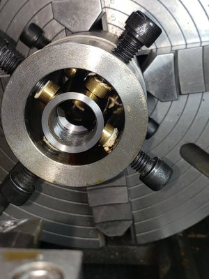

Nice. What is the cream colored stuff on the ends of cap screws? Is the threading tool a Vardex? What size thread are you cutting?
That's a lot of coordination to get exactly right within 1 dial sweep at the end of the dark tunnel, bravo.
thestelster
Hi Peter, that is just thick grease. The grease allows the brass pads to stick to the cap screws while I'm positioning the action in the spyder. The threading tool is a Sandvik. The Remington Model 700 action uses 1.062" x 16tpi. After single point cutting these threads, the new dimensions are 1.099" x 16tpi. This is the new dimensions I have to machine the barrel to fit. So, obviously, the old barrel would be loose as a goose in this action.
thestelster
I occasionally have to do that with metric threads, so you can't disengage the half-nuts. Adjectives describing that: trepidation; fear; worry; and hopefully never remorse. Though I have changed it up last year to run in reverse on the back side. But you still can't disengage the half nuts.

I never had a lathe that was large enough to work on rifles or barrels until I bought my South Bend. The work holder that you machined for the action, would it be considered a spider or just a work holding jig. It’s genius. I’m on a learning curve. I guess everything can’t always be held in a 3 or 4 jaw or faceplate.

thestelster
Yes, its called a spider, I think it goes by some other names as well. And yes, it is quite ingenious. Solves a lot of alignment issues.
Some call it a spider, some call it a double spider, and others call it a double cats eye. Mine is a triple.
It's actually easy to hold an action in a 3 or 4 jaw. But holding is not the problem. The problem as @thestelster explains, is positioning the internal raceway of the action across its entire length to be concentric with the rotating axis of the spindle. Only when it is fully concentric end to end can it be machining such that the threads, lugs, and face are all square and true to the rest of the final assembly.
