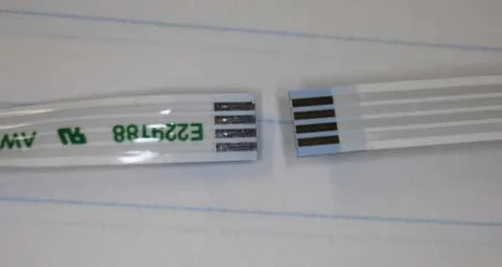

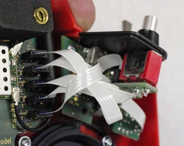

Any of you electrical savvy guys recognize this kind of ribbon cable? From memory its about 5mm wide x 1mm thick x maybe 60mm long, 3 gold metal contact pads on one side. It slides into a matching socket receptacle.

It does look like that, thanks John. I tried a couple keywords with 3-pin/pad/connector.. mostly the count is higher. I think I need to extract some info off the cable & try searching on that
Yes I was on that site. I couldn't narrow down the search so will have to see what i can read off my cable. I may also be wrong about the number of pins & that's why. Looking at my pic I see 4 contacts on the plug-in receptacle, maybe I'm wrong about 3.
found this on ebay, getting warmer...
RobinHood
Can you not just use the number of conductors you need and cut off the excess strands (or leave them, if you have space)?

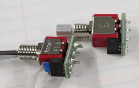

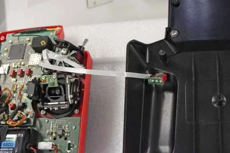

My issue is I would like a slightly longer ribbon. I want to relocate a switch & suspect this one will be too short to reach. Both ends have these teeny copper pads which plug into a corresponding contact receptacle. I could do some micro soldering splicing preserving the ends but yeesh it’s tiny & would be in a pickle if I buggered it up.

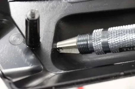

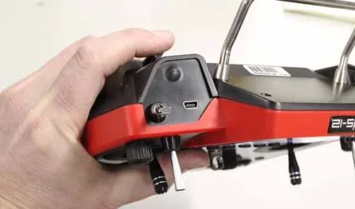

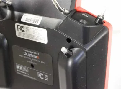

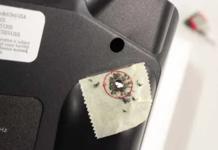

I ended up sourcing ribbon cable through Ebay supplier. Dirt cheap & fast delivery. The switch relocation went as planned. The magic smoke stayed in. The longer length allows me to open the TX like a book. Now I have a tactile push button positioned exactly where I want & no longer have to put grip tape on the unit.
