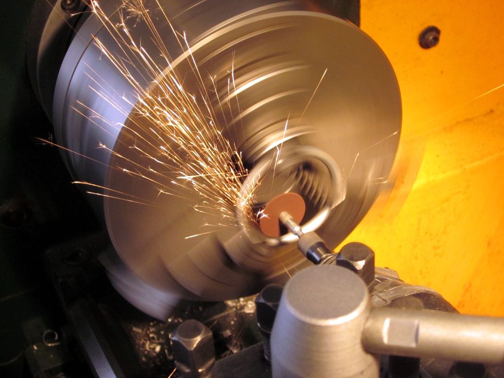

A while back I was making some heavy duty washers for a gear puller. I sawed four 3/8" pieces off a chunk of 1 1/4"
round stock and chucked all four of them in the lathe to drill them. When the centre drill hit the first washer it spun in the chuck.

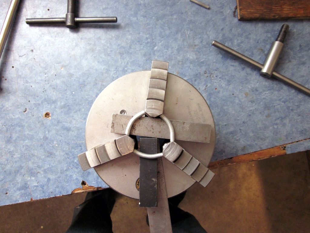

I took some pieces of scrap aluminium from an old cleaning rod and made spacers so I could tighten the chuck jaws with them still open.

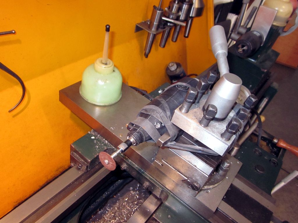

I attached a Dremel die grinder to the tool post using a 3/8 key and rubber bands made from an old motorcycle tire tube.

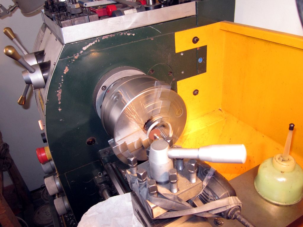

I fed the grinding wheel back and fourth on the chuck jaws grinding very lightly for the better part of half an hour.
I put some Play Dough at the back of the jaws to keep the grinder grit out of the scroll plate.
Once I was done I took the jaws out and cleaned the chuck and jaws well.

Wow a low tech simple way of doing things, I love it! I'm a bit surprised that the Dremel tool mounting gave precision results.
terry_g
The Dremel fit into the slot in the tool post tight and did not move.
I had a lot of rubber bands holding it and I ground very lightly.

Looks a bit like a set up i saw on a u tube vid a while back, He made a bracket to hold a little better quality grinder.
Swharfin'
Out to pasture Red Seal Millwright
On my Dremel the thread under the plastic nut on the tip is 3/4' unc, I cut up a pc of 1" key stock and threaded a hole to clamp in the tool post.
