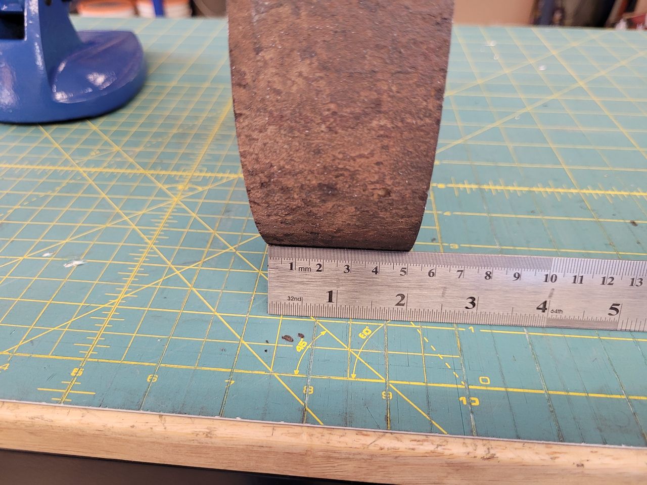

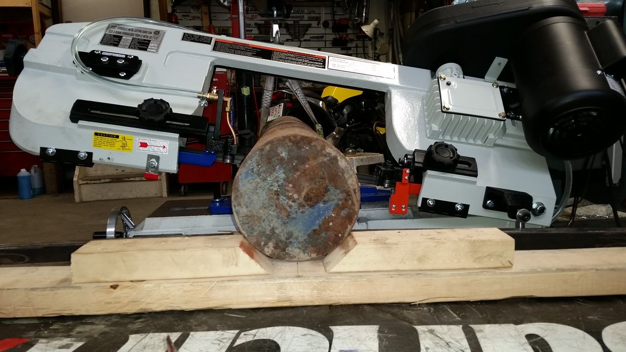

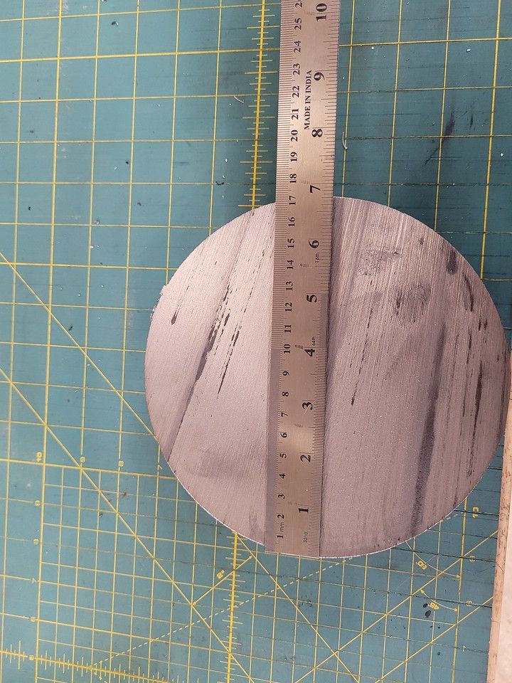

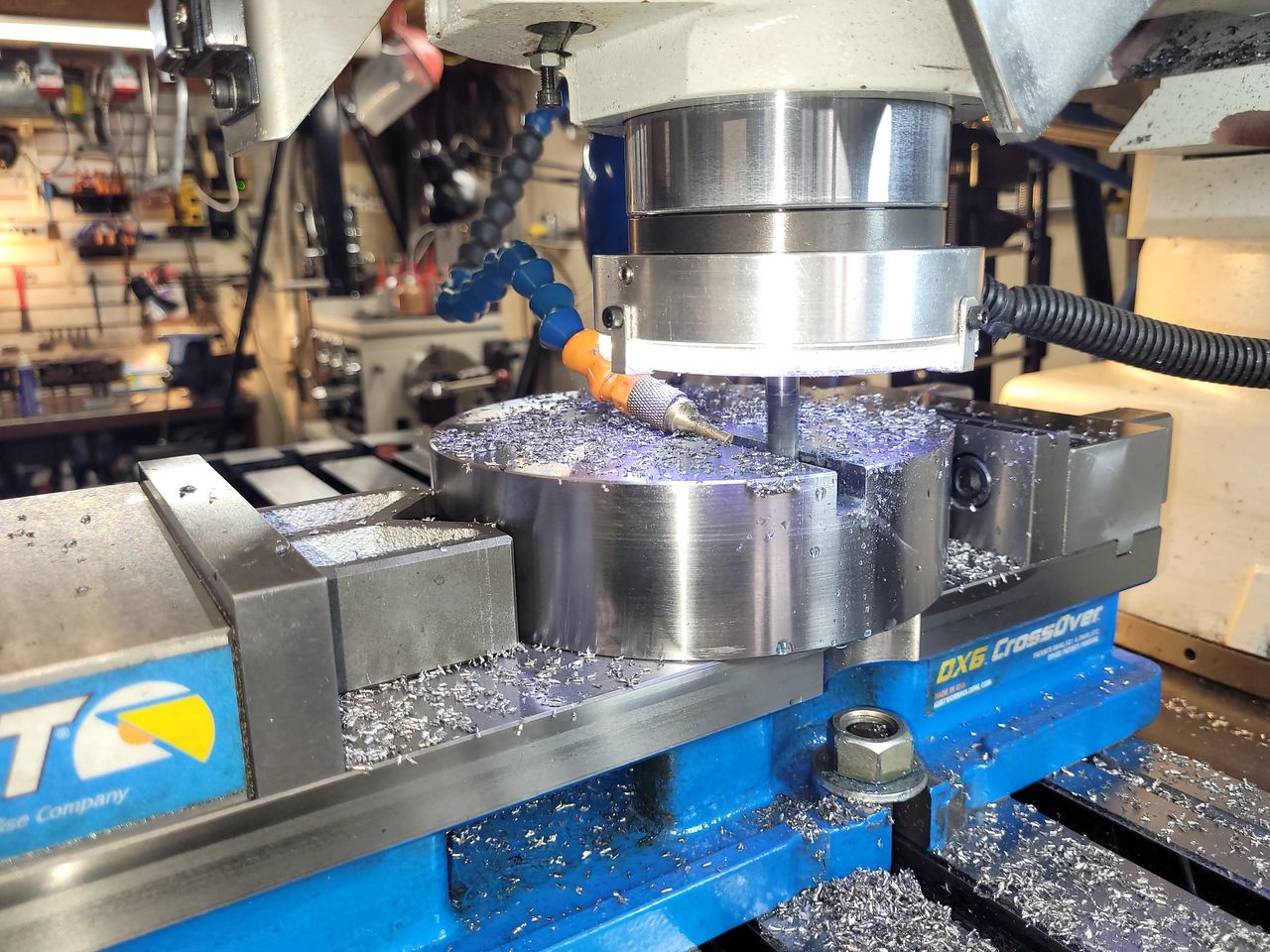

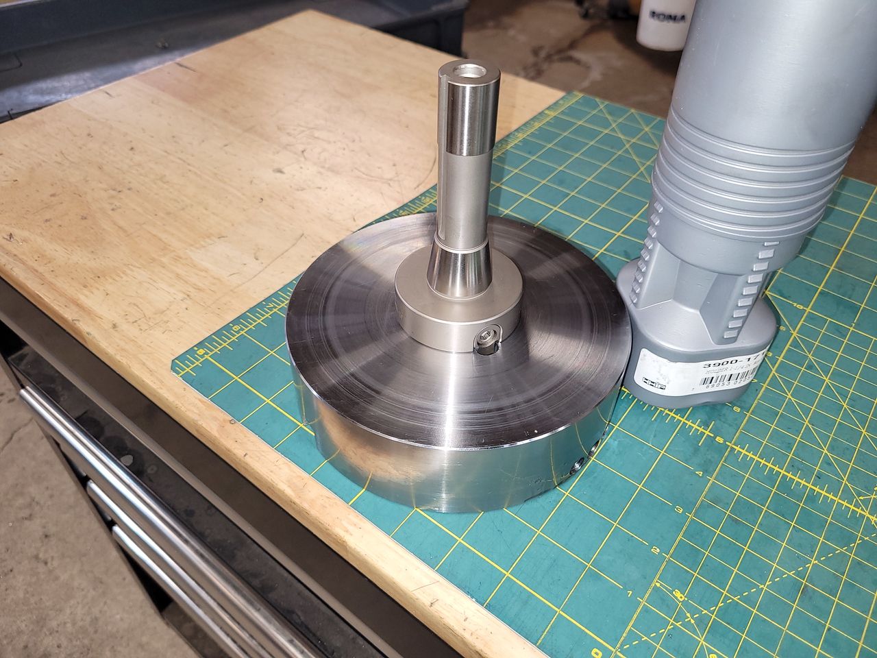

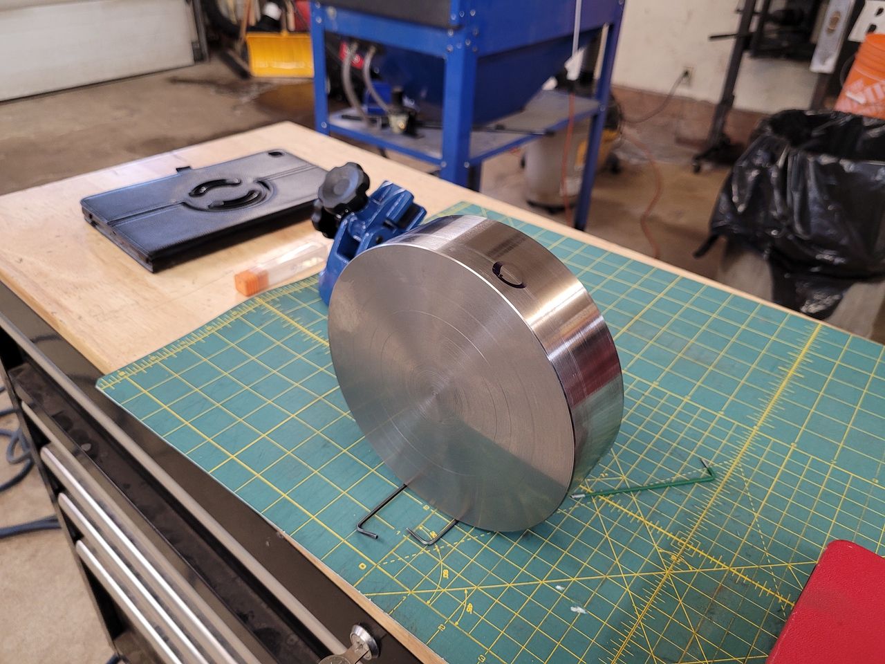

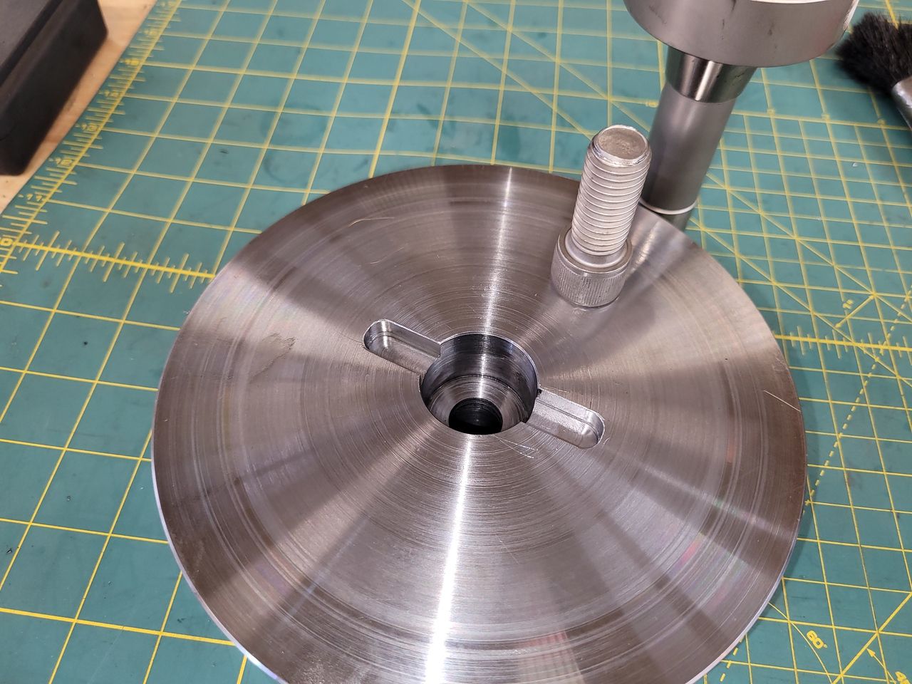

I have a flycutter that I made many years ago. It’s served it’s purpose and works OK for machining pieces less than 6” across. I have used different 5/8” shank lathe tools, both positive and negative rake with varying results as shown in these pics.
When I’ve tried to use it at larger diameters it has proved to be not rigid enough and starts to chatter and produce and poor finish. I have recently seen a few large diameter flywheel style type flycutters on youtube and ebay that got me interested in making one myself. None of the info I found gave me a feeling that one design was better than another or that 1 insert cutter type was preferred. I decided to build one that can use any style insert that I can make or buy a holder to fit. I bought a 1.25” R8 facemill holder on amazon and used a 2” thick slice of 6.75” 4140 material from the log I got several years ago.

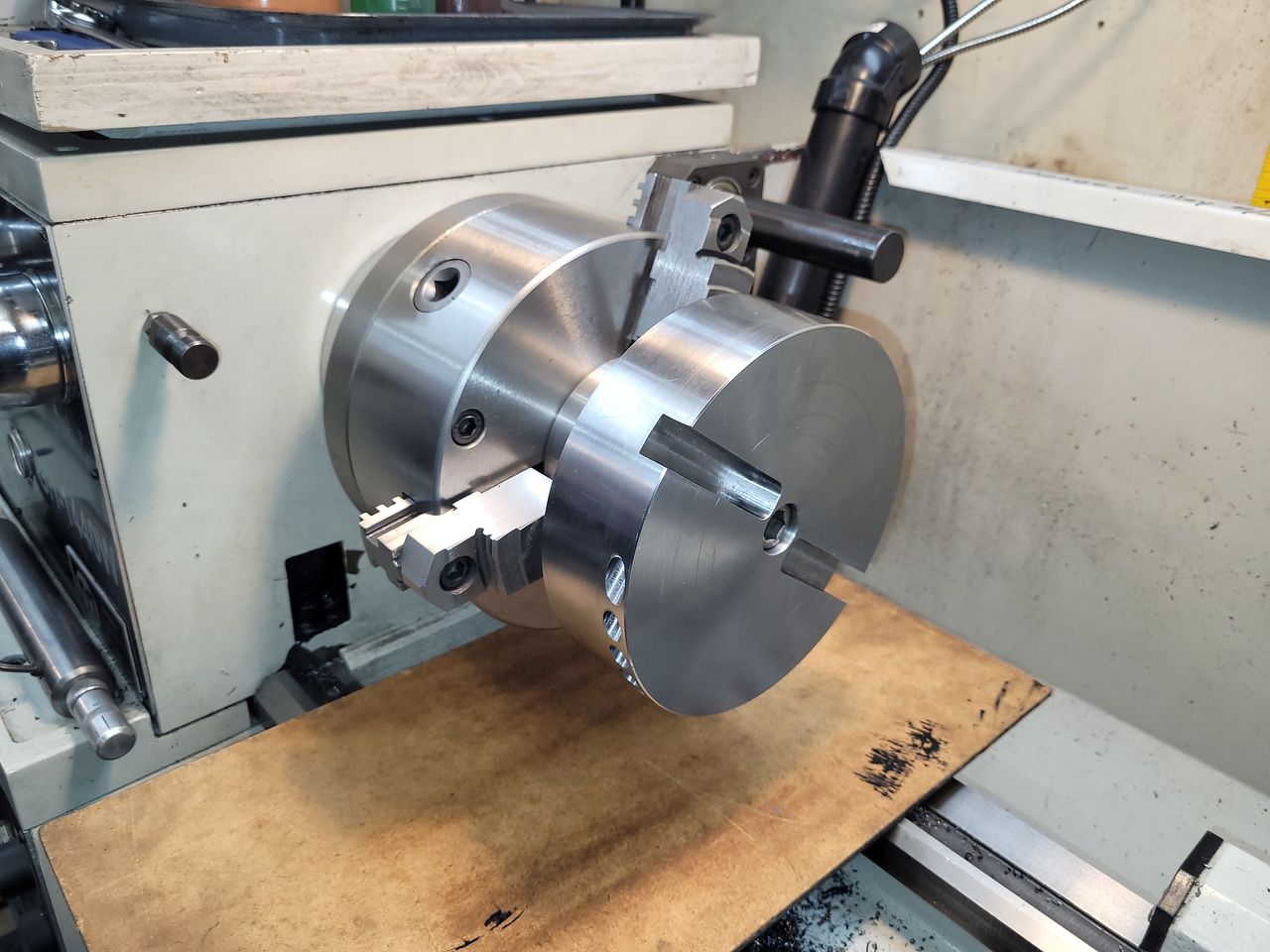

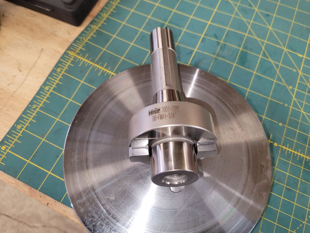

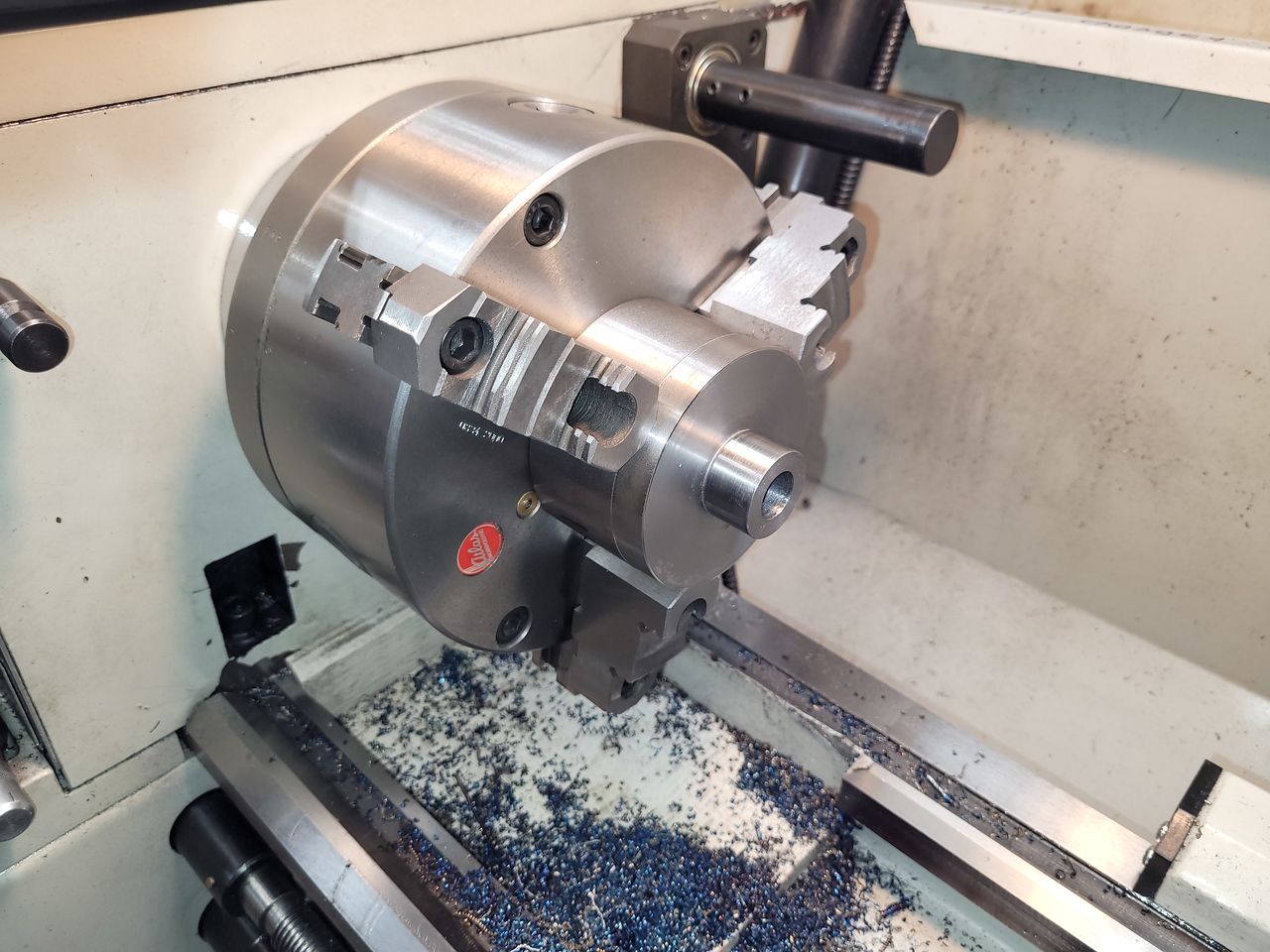

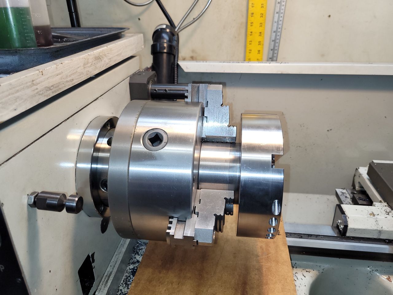

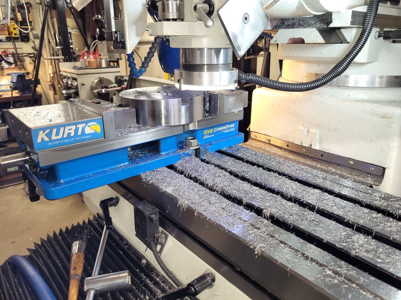

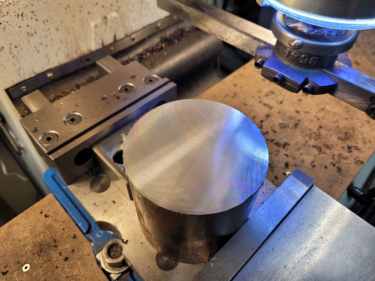

I trued it up in a 4 jaw chuck on the lathe, to be finish machined later.

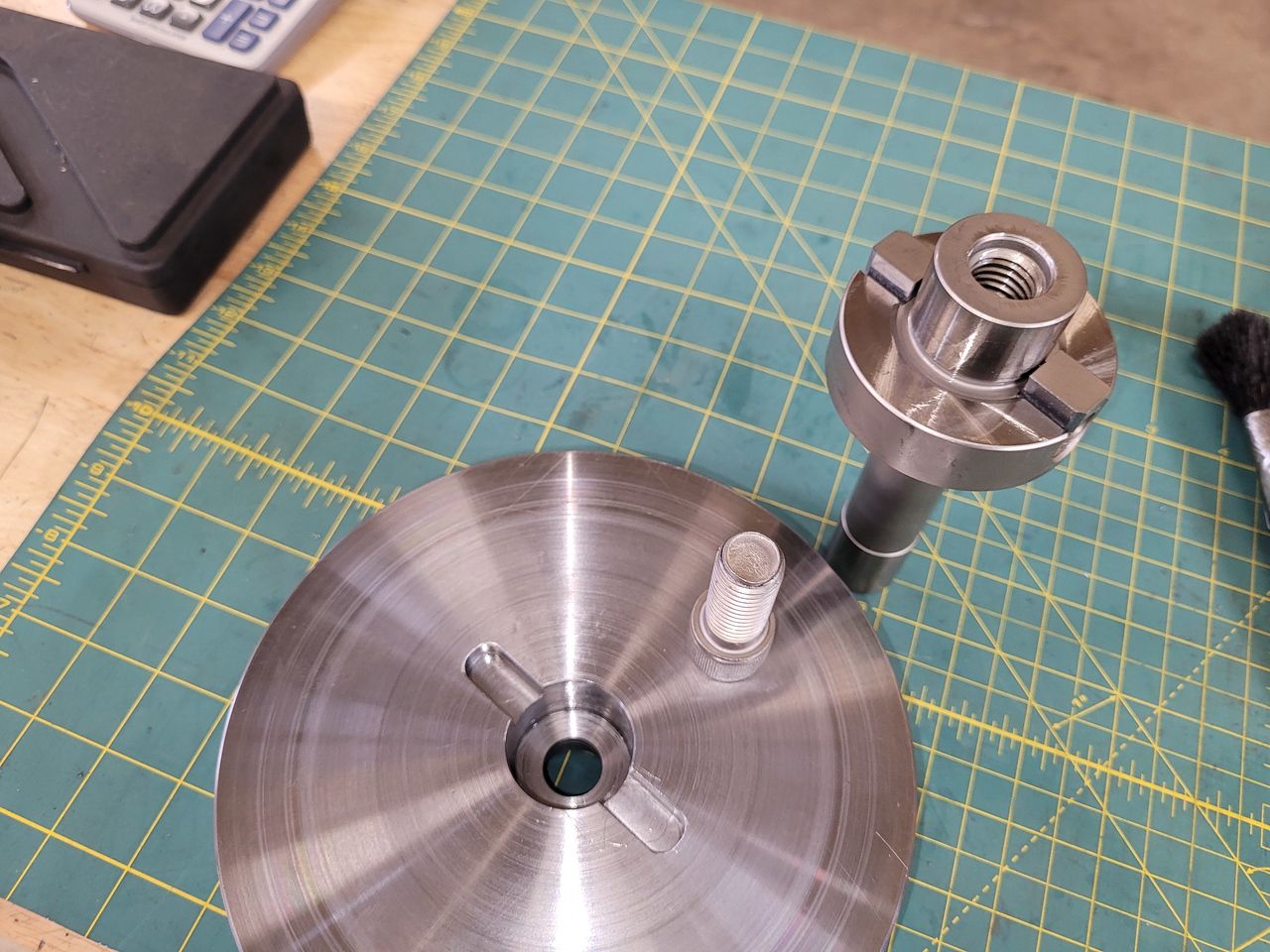

First I machined the 1.25” hole and the pockets for the keys on the face mill holder. I found that the 2 keys were different thickness so I machined them both to 7/16” wide and milled the pockets for a tight sliding fit. The round hole is a .0001” inference fit onto the R8 holder and can be installed or removed with a few taps with a dead blow hammer.
To be continued.

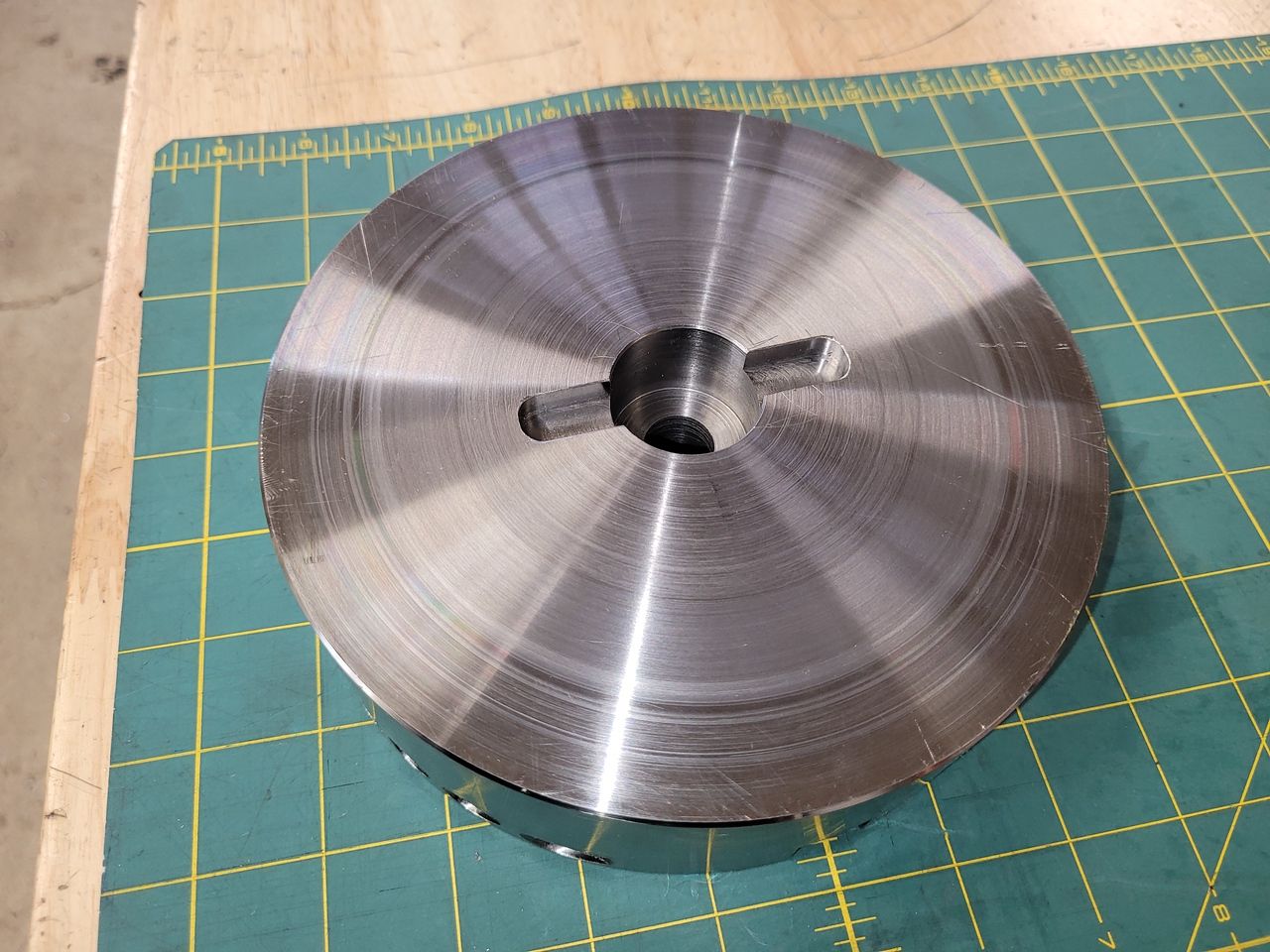

John Conroy
member

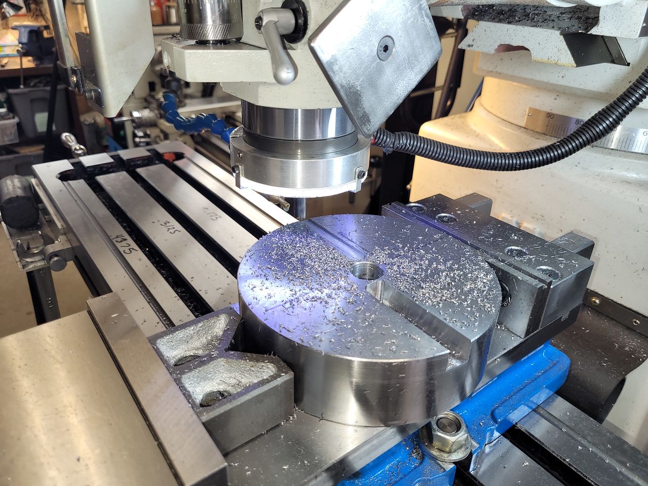

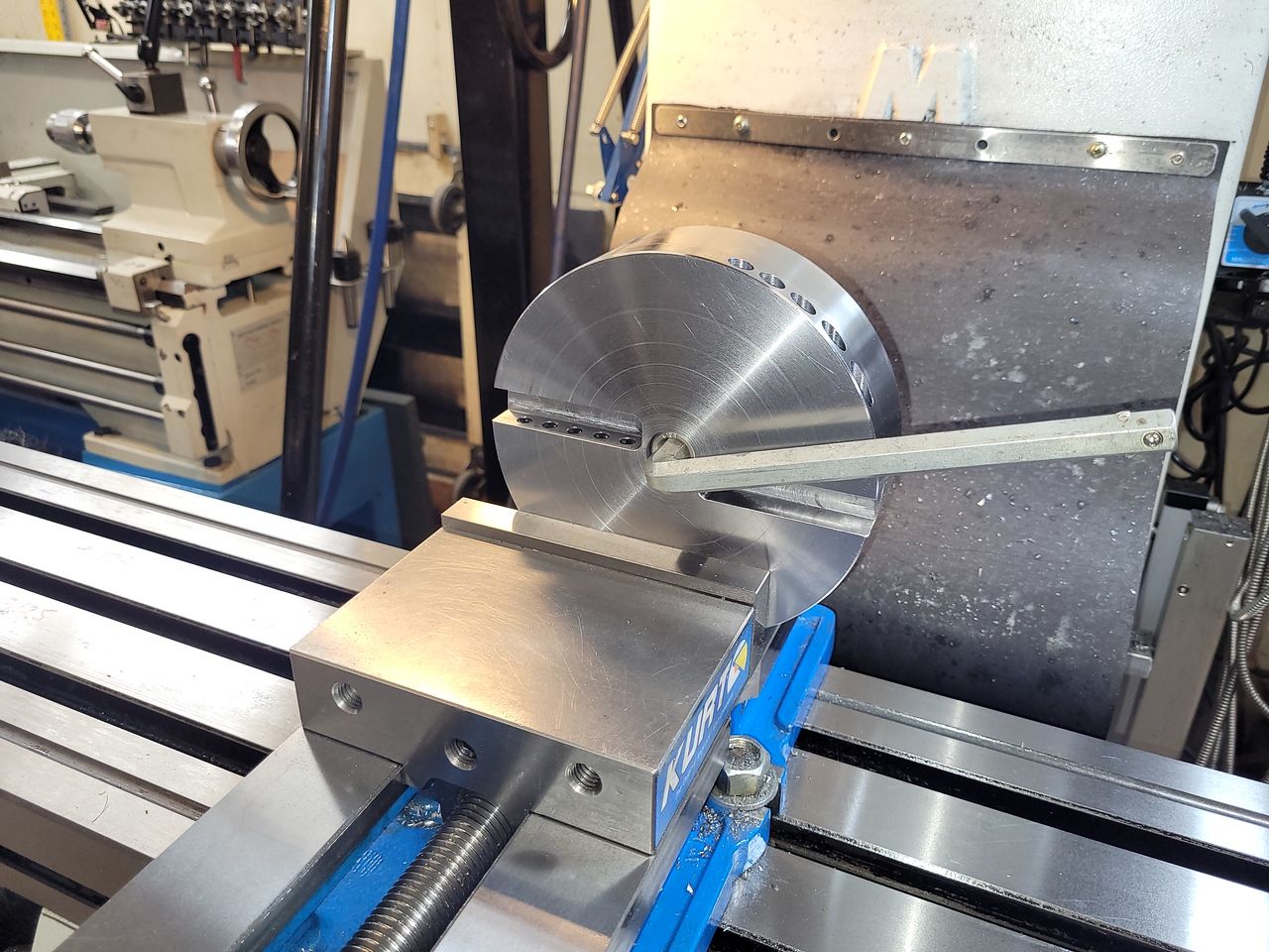

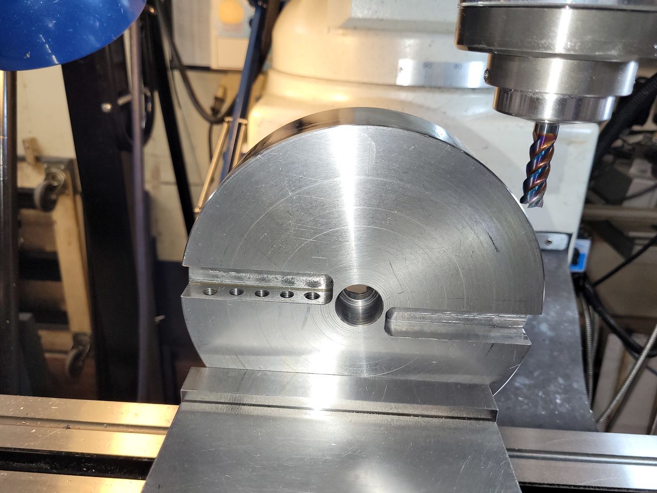

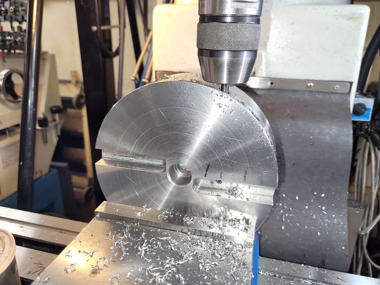

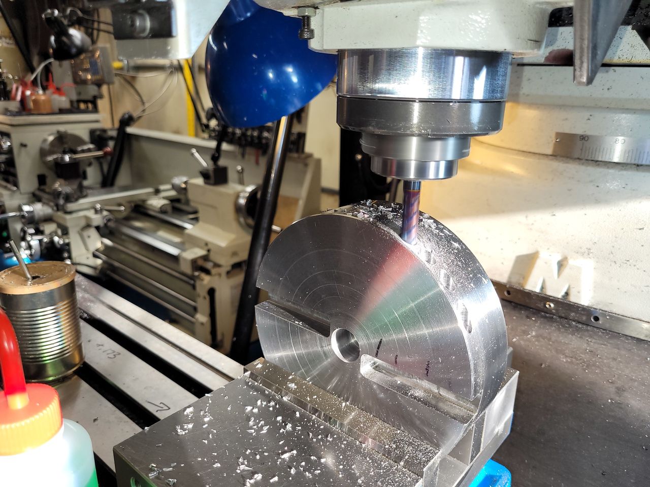

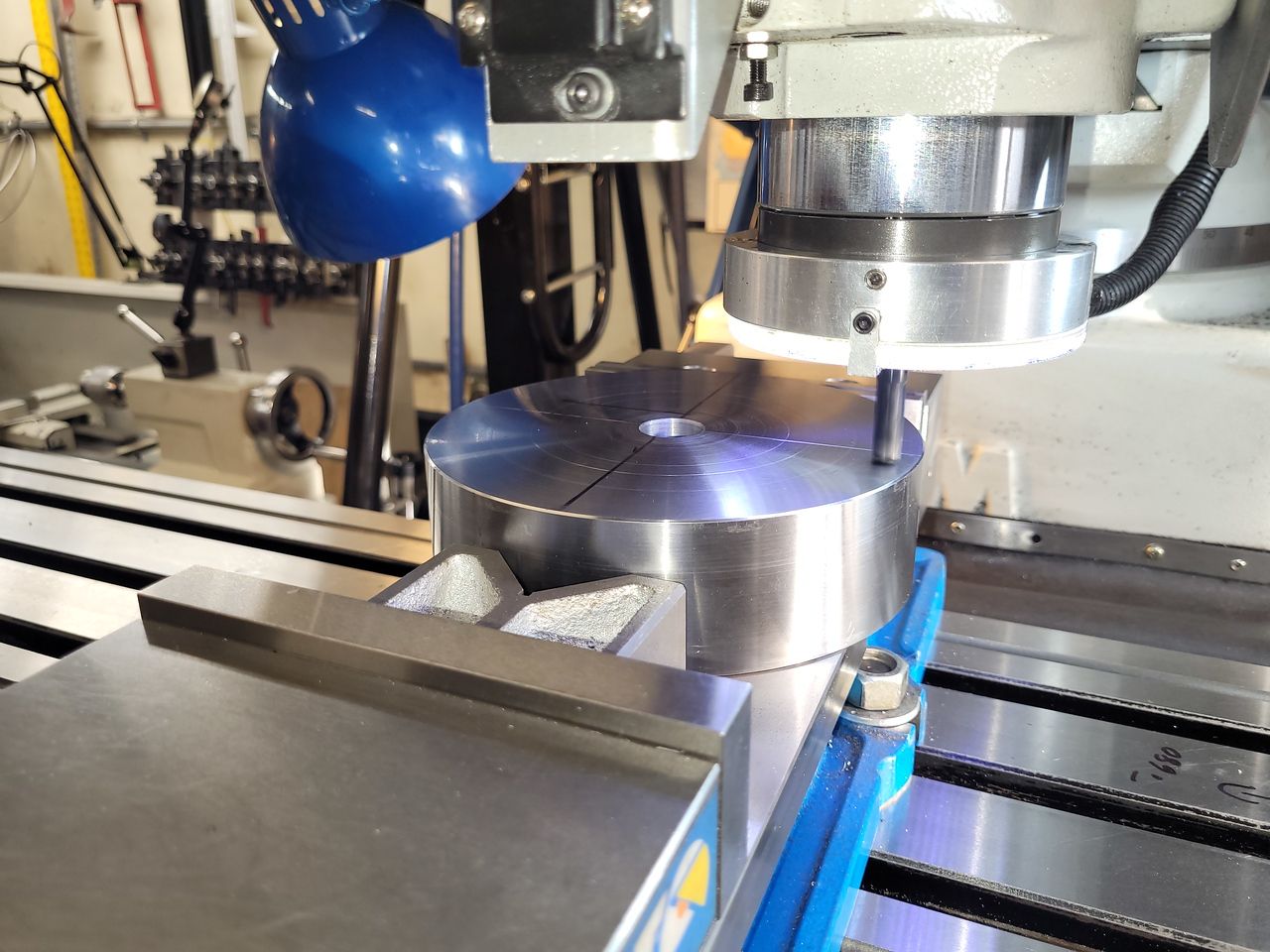

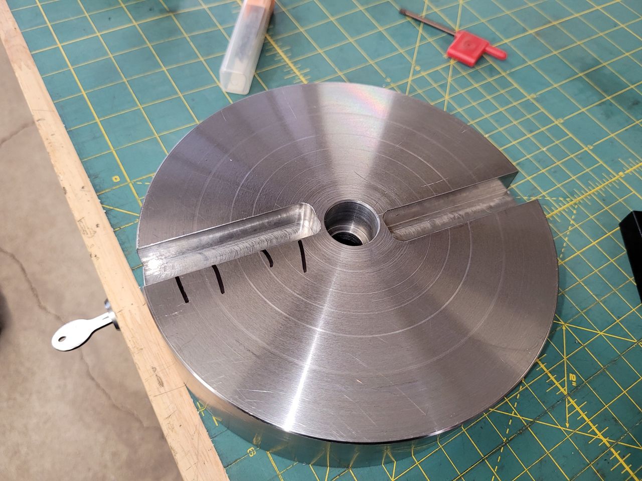

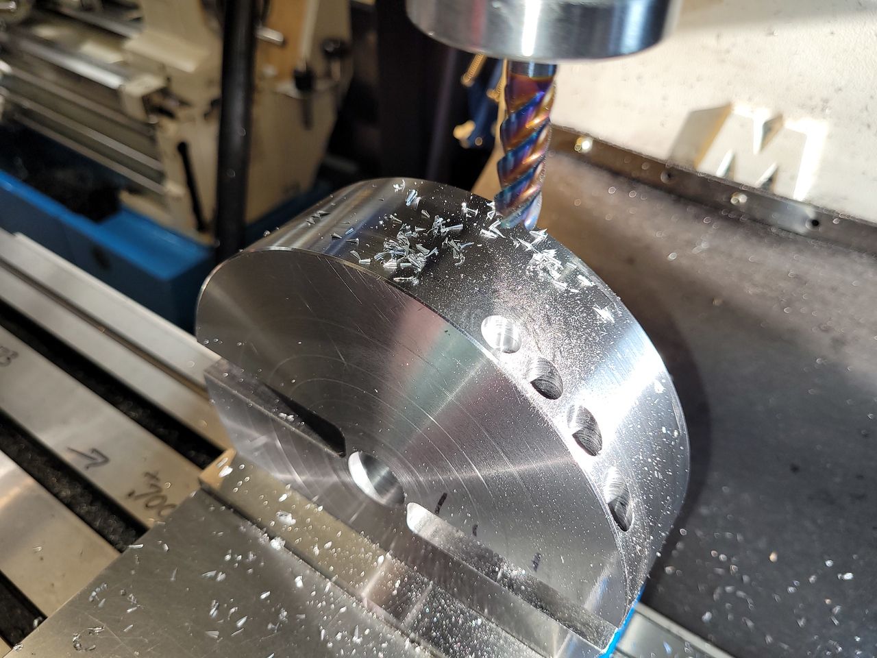

Then I flipped it over and milled the 2 slots to hold the cutter and counterweight. I used a 3/8" four flute carbide end mill with mist coolant cutting .100 depth on each pass at 1600 rpm. The slots are .630" wide by .550" deep and 3" long. I offset the slots so the cutting edge is on center to be sure the correct cutter geometry is maintained.
John Conroy
member

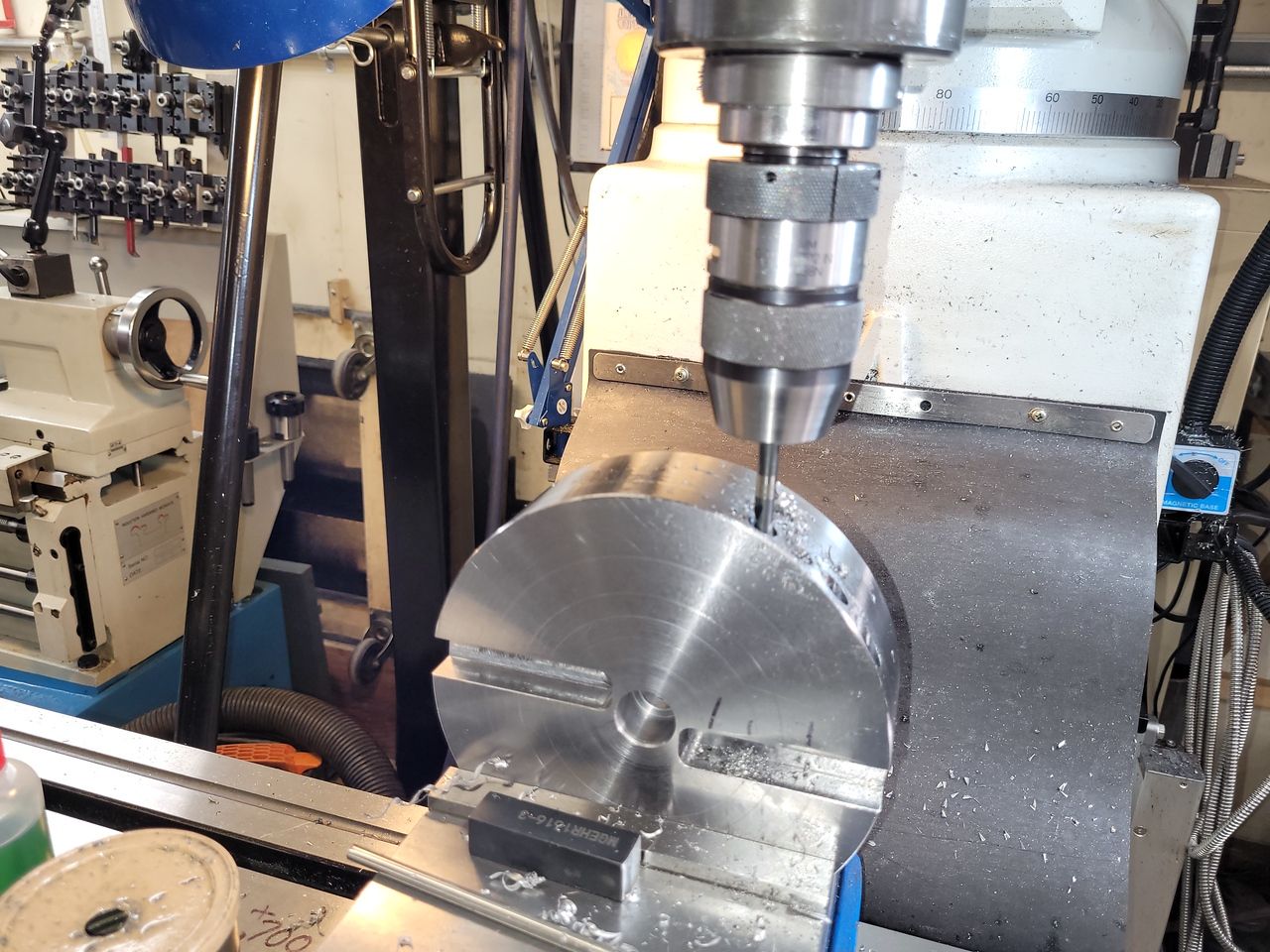

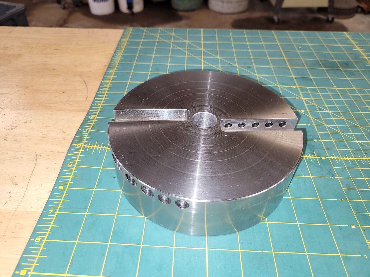

I plan on using left hand insert tools so the spindle can turn in the normal forward direction and send the chips toward the rear when traversing right to left as I normally do. Not knowing exactly what type of insert tool may be used in the future I wanted to have five M8 set screws spaced .5" apart in each slot the make it as adaptable as possible for varying diameters and tool types. I set the disc on edge in the vise and indicated and adjusted it until the slots were level with the table.

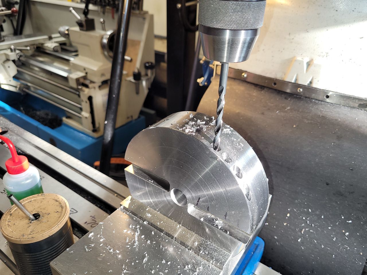

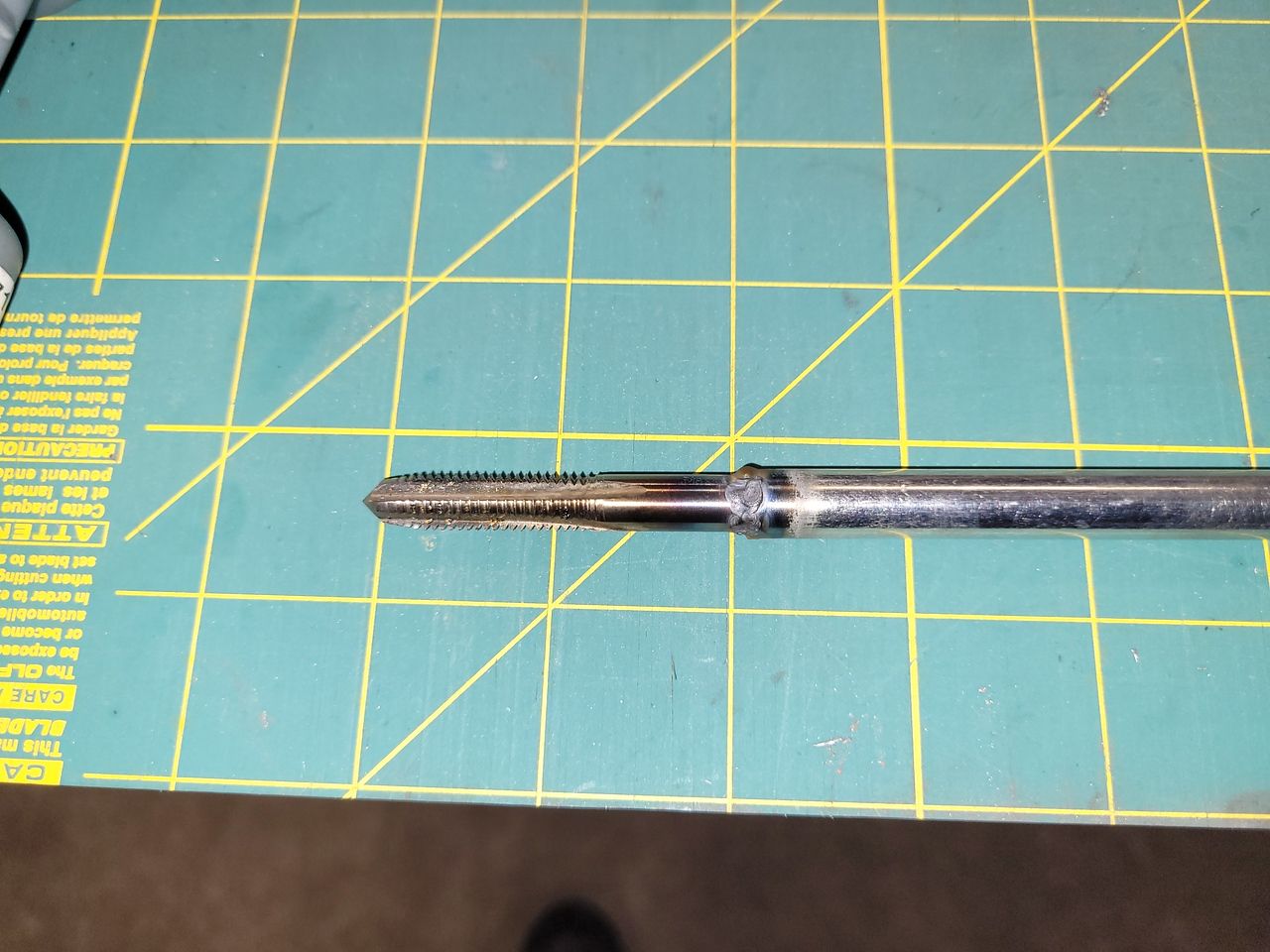

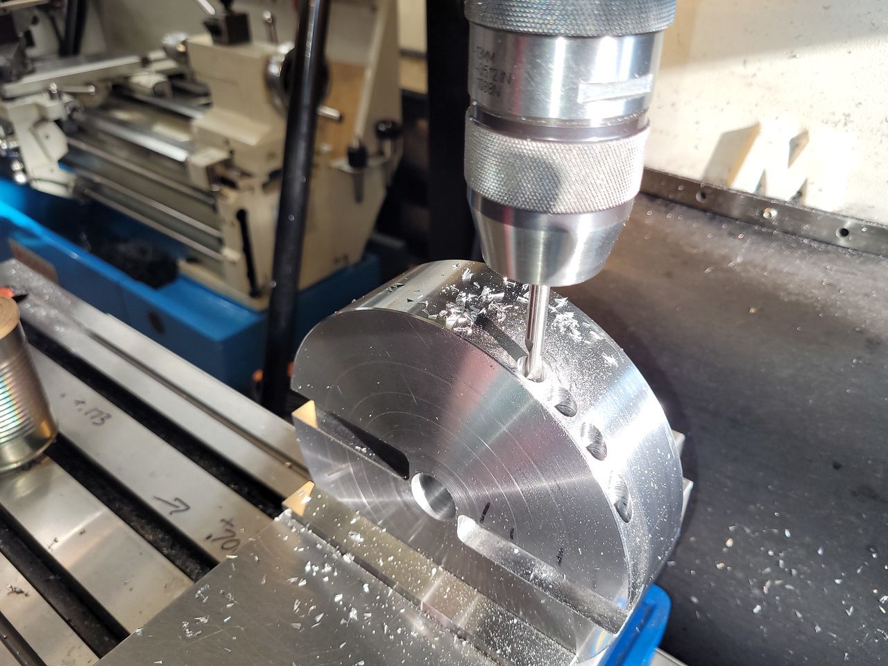

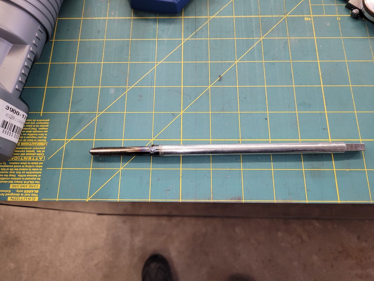

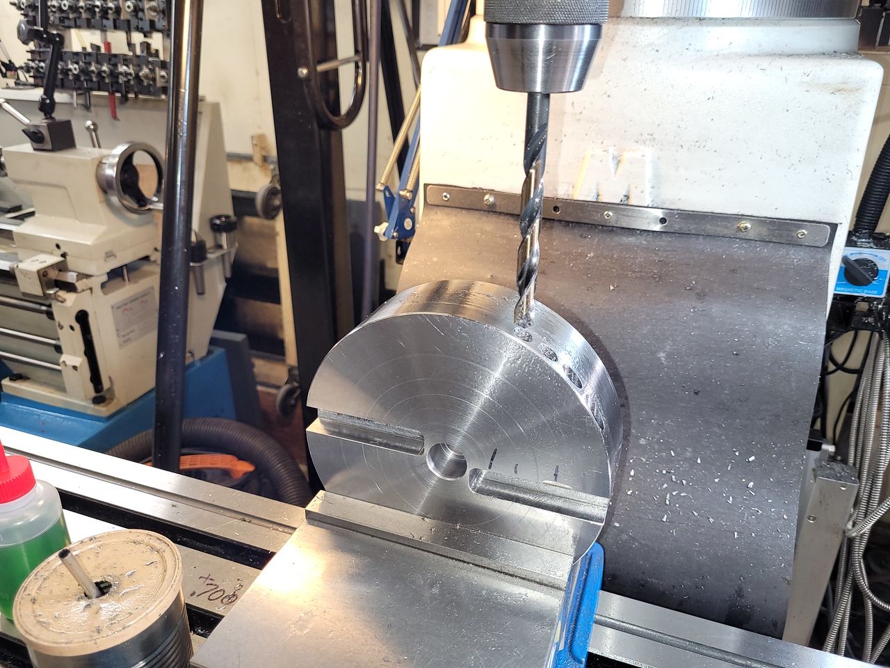

I could not find a M8 pulley tap or extended tap so I used a KBC house brand taper tap. I bored a hole in a length of 10mm drill rod for a light press fit onto the tap and pressed the them together with some red Loctite. That proved to be not strong enough so I tig welded the tap in place. I milled a square on the other end of the drill rod for a tap wrench. I think the off gassing of the Loctite caused the problem I had getting a good weld puddle but it held together for all 10 holes.

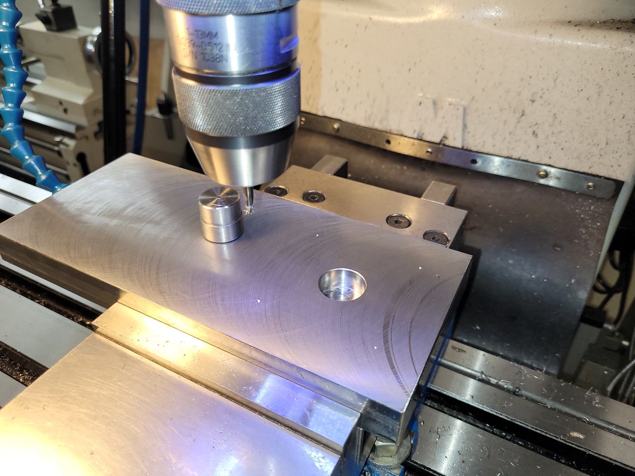

The process for each hole was to start by making a flat hole pocket with a 10mm end mill.
Next a 1/4" spot drill to get the hole started on center.
Then drill all the way through to the slot with a new 1/4" drill bit.

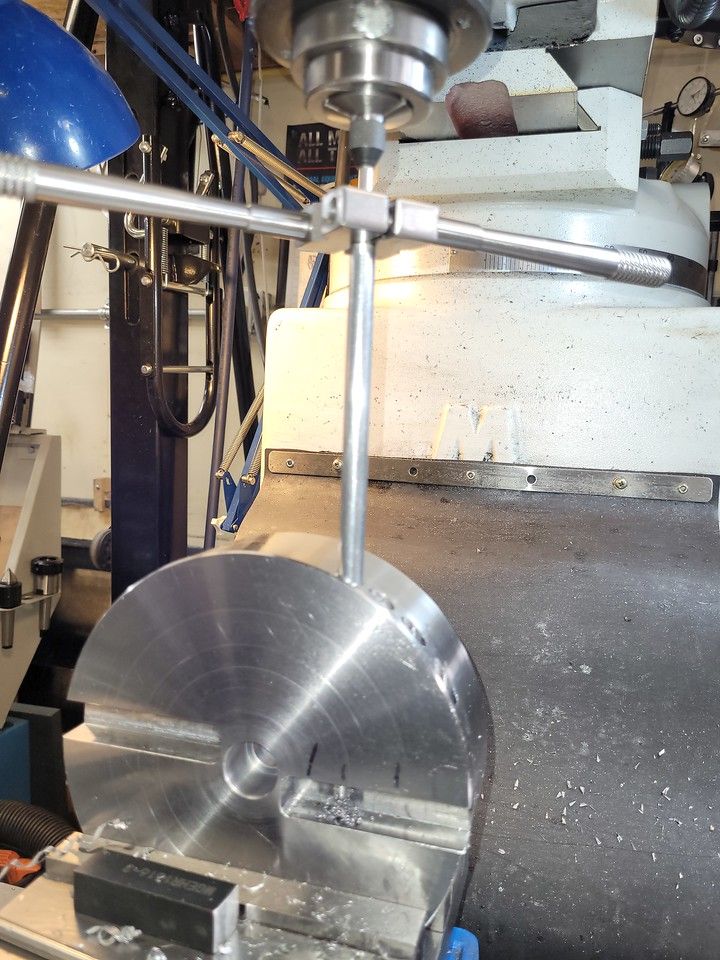

Followed by a 10mm drill bit leaving .600" at the bottom of each hole for M8 thread for the set screws.
Next a letter H drill bit that is the tap drill size for M8.
And lastly the tap. Of course I had to flip it over to do the second set of holes. It was a long process getting all 10 holes done but it turned out perfectly.
John Conroy
member

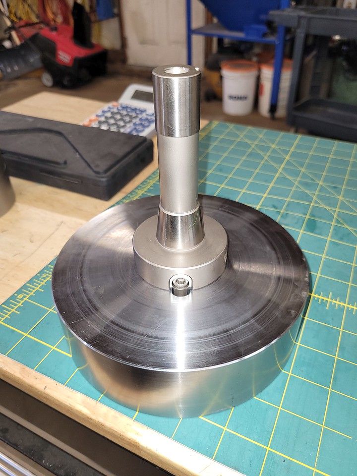

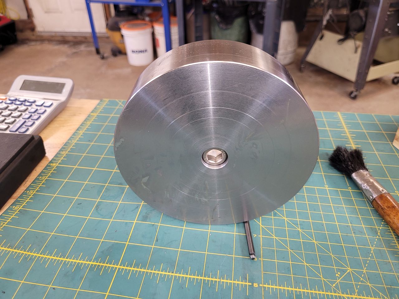

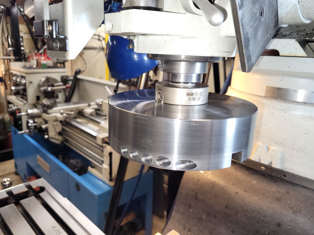

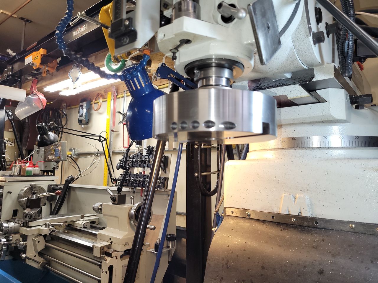

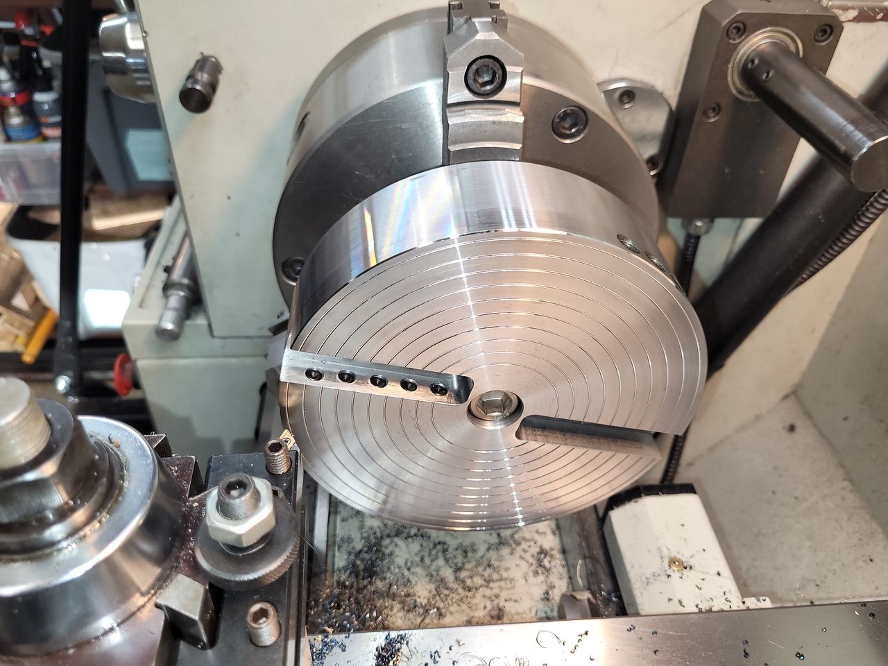

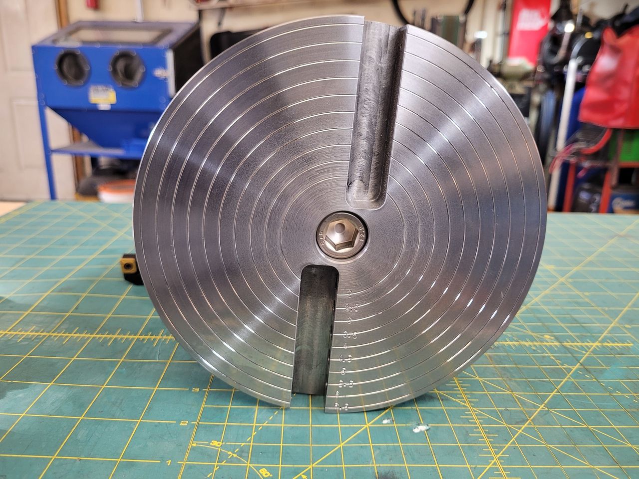

With the slots and screw holes done I cleaned up and assembled the parts and installed it in the mill to check the results.

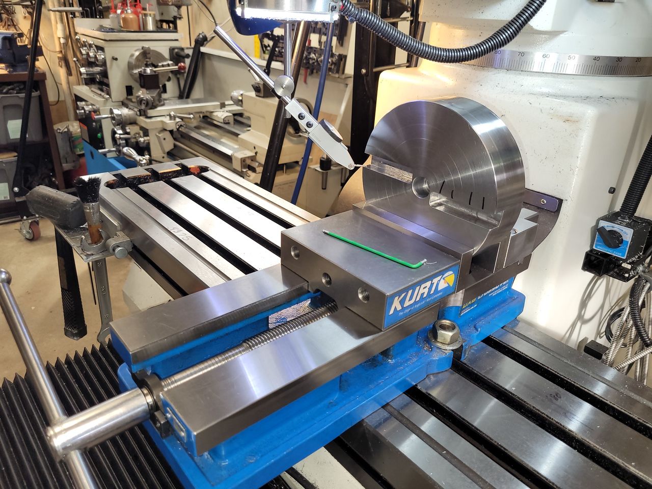

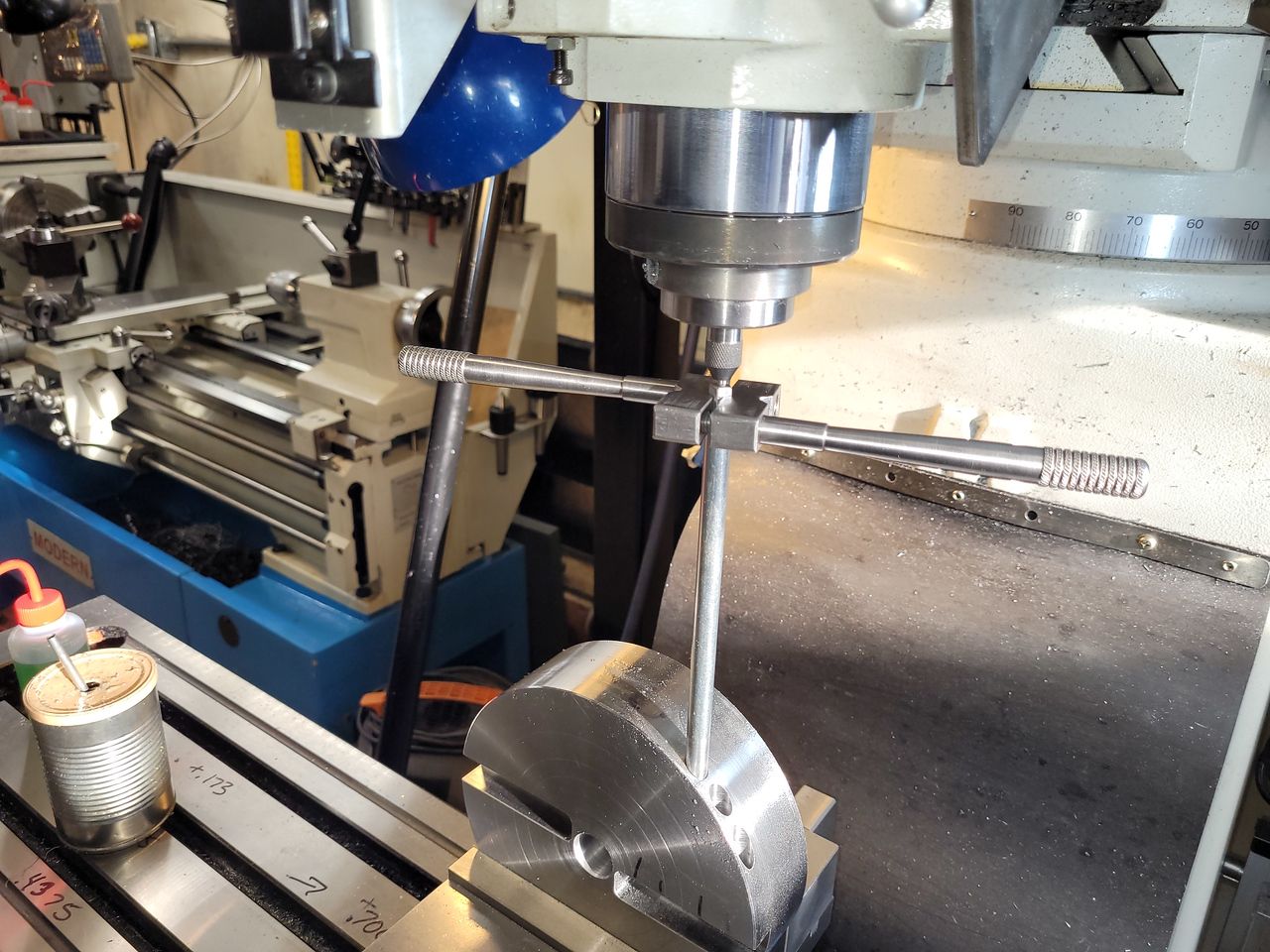

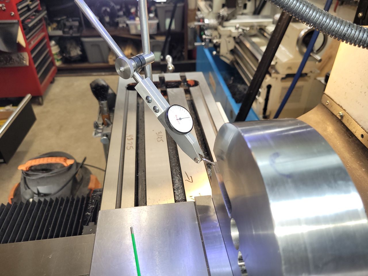

I checked the runout and as I expect there was about .002" on the OD resulting from having to flip it in the chuck when I first machined one side at a time. It would probably be OK like that but it bugged me so I machined an arbor with a 1.25" hole to a snug fit and ran in some 5/8 NC threads for the mounting bolt. then without disturbing the arbor I mounted the disc on it and trued up the OD and front face.
I also machined grooves in the face spaced 1/4" apart and stamped them to indicated size based on location of the cutter,

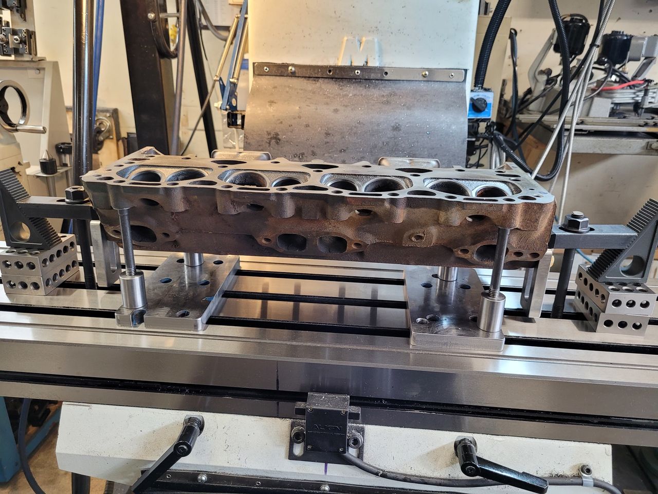

I do quite a bit of work on small block Chevrolet cylinder heads so years ago I mad up a set of head stands that allow a head to be adjusted to level for gasket surface machining or measuring.
The 4 studs fit into 4 bolt holes in the head and can be adjusted up or down with an Allen wrench from the top.
This head is a scrap piece used for this trial. The video shows it has a .005" low spot in the center.
Link to video

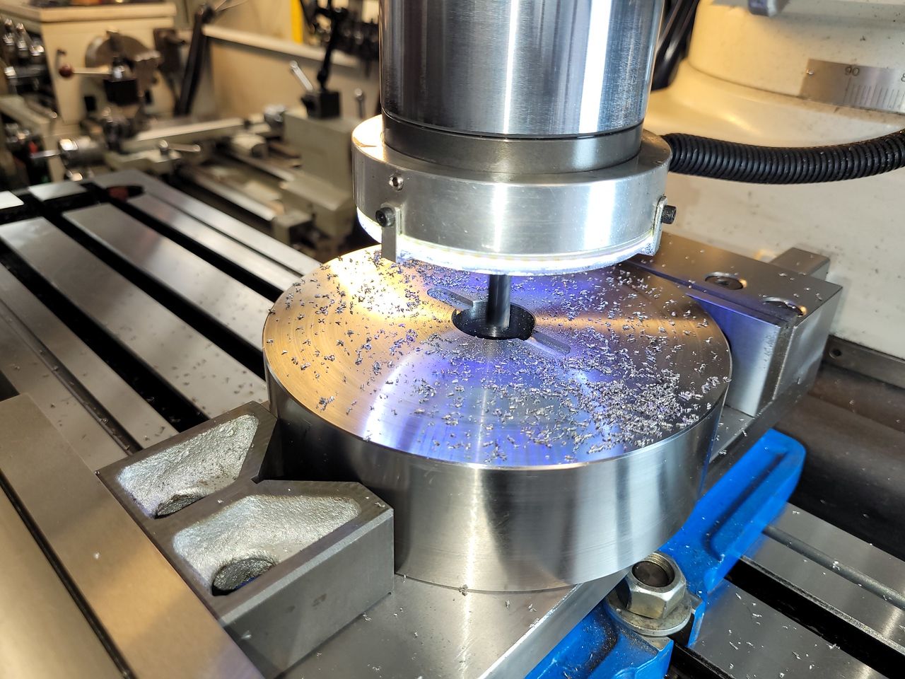

I installed an insert tool in one slot and a piece of 5/8" square for a counter weight in the other. With this much weight I made sure to keep the spindle fully raised and made a .002" deep cut at 350 RPM and a very slow feed rate. The produce a mirror finish but did not fully clean up the hollow. I made a second.004" pass at the same rpm and feed rate. this completely cleaned up the head with a very nice finish. I shot a video of 1 pass. It is long and boring but go ahead and watch if you are bored.

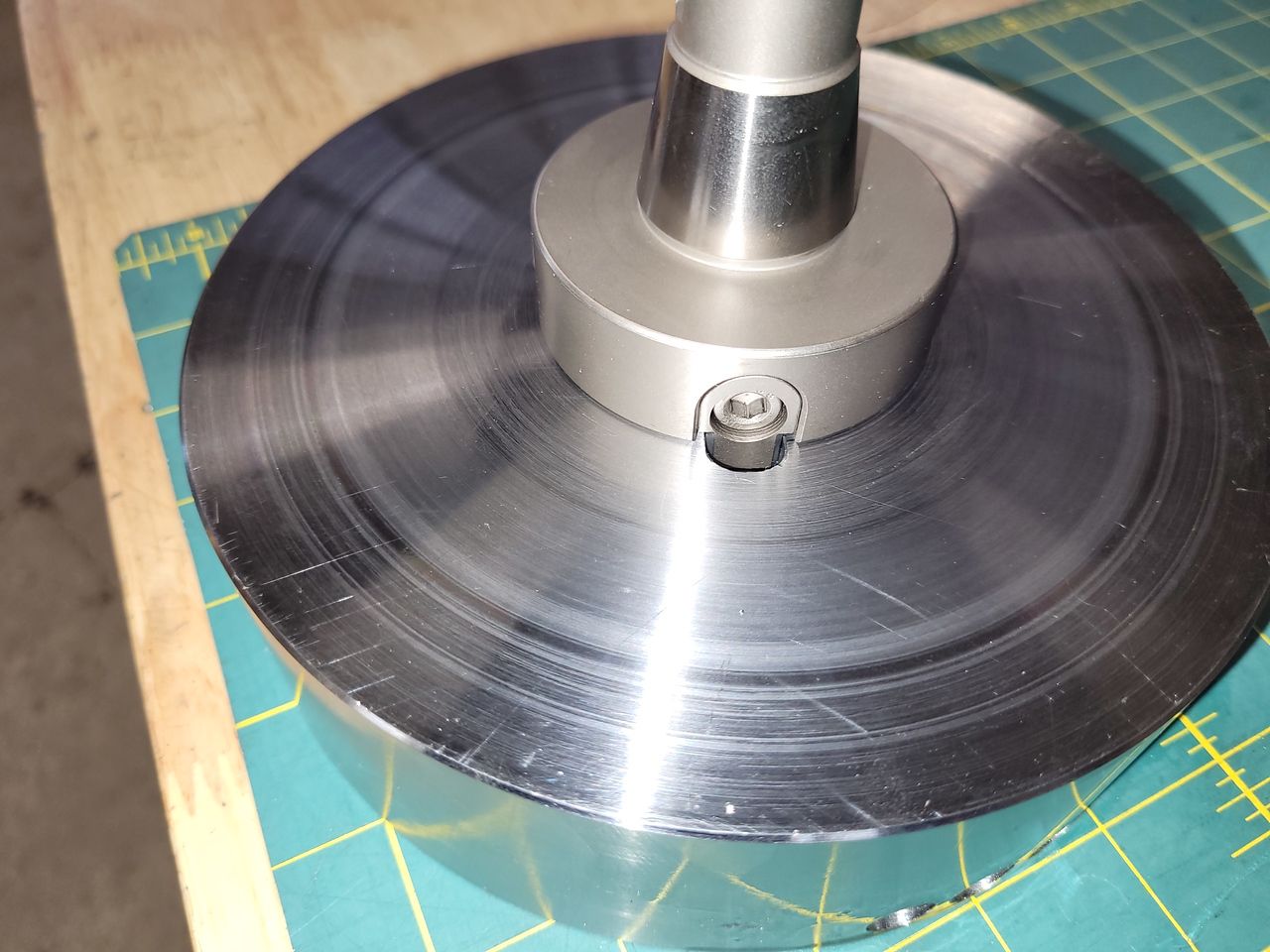

Some points of interest regarding flycutter use. If your mill head is trammed normally the cutter will always cut on both sides of the spindle. If you set the depth of cut a .005" for example it will cut the .005" the first time the cutter passes over the part and will just rub on the second cut that is behind the spindle based on direction of feed. This rubbing affects the finish and I don't really like the look of it. I watched a video on Youtube where the user trams his head off to one side .003" in 8" sweep. No more second cut and much better finish but I was concerned that the cutter will render a dished cut. I decided to try his method today and the result is a much nicer finish. I swept the across the surface with tenths indicator and there is a dish affect to the finish but it's only .0003" over the 8" width of the head so not a concern.
Thanks very much guys! We'll talk about Smugmug when we meet later this week, it's a long story.
I have always wondered about this but never tested it. Thanks for doing it and especially for letting us all know.
8" fly cutter eh! Wow! At 3 inches, my biggest is less than half of that!
Nice. That is a healthy cutting tool! What is your procedure to set the cutting tool edge relative to horizontal datum surface when the cutter shanks get mounted?
I've also read about different fly cut approaches & opinions. Some say its in the dynamic balance, some say in the head mass, some say the chunkier the shank the better, some say do away with the shank & put inserts directly on the body... Then you have different machines & rigidity. I guess if you have the finish now, you did it right! LOL
I like the surface finish of my face mill but its only 2". It has that slight 'back swipe' finish you were mentioning. My tram is about as accurate as I can get but I still see Zebra stripes between the extremity of overlap even if I traverse in same direction (full width cuts). Its really hard to feel anything with a fingernail. Usually 800# paper makes everything go away so I know I must be close. Not surface plate close of course. It has 4 inserts. One day I got wondering how the insert edges might vary vs datum surface between the 4 inserts. I set up my tenths DTI in a vise & rotated accross the ball. I would have bet a coffee they might be engineered to be depth staggered between inserts. Maybe 0.0002" I dunno. But my indicator said within a tenth or. I removed them, put new ones on, similar measurement value, but random inserts. Which tells me they aimed for the 'the same' but this is how it turned out given pocket tolerance + insert tolerance. Maybe that's just my model & others are different.

My feeling is that my smaller flycutter has too much flex so the extra leverage the tool has causes lifting and chatter. So I think rigidity and sheer mass make a huge difference. I have also read that insert geometry make a difference. That's why I chose a 5/8" slot, so I can try different insert styles. Some say large radius, some say small. Some say negative rake others say positive. I think rake angle is important based on how rigid the tool is. My thought is the a negative insert tends to push the tool away from the work while a positive rake tends to such the tool in. I have no idea which would be better with a less rigid tool. I plan to experiment with this stuff. I modified the dcmt insert holder I'm using now by milling a 3 degree angle on the top of it to give the insert some extra clearance back from the tip. The first edge of the insert did not survive the .004" cut but seems fine at .002". I also ran the rpm up to 500 for a short time on that first insert corner so that may have killed it. I see some guys saying to run a 8" flycutter at 650 rpm. I think the sfm would be excessive plus the chips would be pretty speedy. It took me a couple of hours to clean up the cast iron chips from that head, they fly a long way even at 350 rpm.

The surface finish is really nice with the single cutter, hard to get a good picture. I'll have to try some different lighting and angles to get better pics. This vid of checking the flatness shows to finish pretty well.

How did the TIR indicate when installed in the spindle?

Thanks Eric, it weighs just over 20 lbs with the arbor. I took 2 short vids of runout measurements, .0009" radial and .0005" axial run out.
I don't think i'll do any coating, I just spray everything down with fluid film when not in use.
