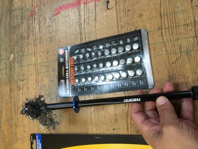

i was at the PA north store and found a swarf magnetic cleaner for $2.50 and button batteries for $1.88.
Bofobo
M,Mizera(BOFOBO)
Interesting wand for sure, does it release the swarf? And the battery's are always a great deal, even if you don't use all the sizes they have, other packs are also a great deal like the 2032 size
Janger
(John)
The swarf wand does release with a pull handle and it works surprisingly well. I was cleaning out crevices on the lathe and the floor easily. They had two shopping baskets full of the things.
