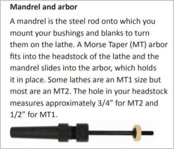

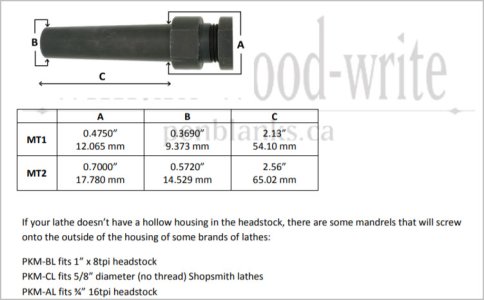

Looking at some of their beginner how-to guides, they show some mandrels, typically MT1,MT2. So guessing this corresponds to smaller lathes like Sherline, TAIG etc? So if I want to use my regular (14x40) lathe, would I use the straight shank [PKM-CL fits 5/8” diameter (no thread)] or make my own?

I fell down that rabbit hole more than 10 years ago. I started out making those kits that you saw on the web site. Now I make all my own parts.
These kits a really designed to be made on a wood lathe. The MT2 is the standard spindle bore on most wood lathes, big or small.

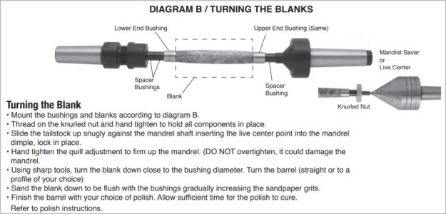

The basic premise of these kits, is to glue a brass tube into a piece of material. Then mounting it on the mandrels you saw, with a set of bushings, and turned to a specified size. These bushings not only hold the brass tube and material, they act as gauges for the size required.

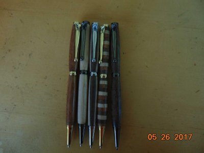

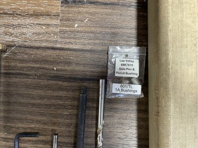

What ever you do, do not buy the pen kits from Lee Valley they rip you off, buy from AliExpress, I’ve made quite a few, a pen blank is supposed to be 6” by 3/4 square, old pallets are sometimes made from what we call exotic wood, check them out, pen blanks at Lee Valley are anywhere from $6 and up. It’s great fun very relaxing and they make great gifts, pic is a few i made a few years ago. I am actually selling all part of my wood turning stuff, i bought 100 pen kits from AliExpress for i think $180 about 5 years ago and still have over half of them left lol. You have to have a separate set of bushings for each type of pen kit and there are many different styles of pen, I suggest you start with a slimline kit.

Pen turning requires a pen mandrel for the headstock and a live centre for the tailstock, a drill chuck is not required, a barrel trimmer is used in the drill press to level the blank with the brass tube in the pen blank. Although if doing it in a metal lathe it could be faced off in a similar way as metal turning but would require a 4 jaw chuck. Pen turning 101 is a good video . Don’t use epoxy, super glue works or super glue gel is my fav, I mean Dollar store stuff, cheap cheerful and it works.
