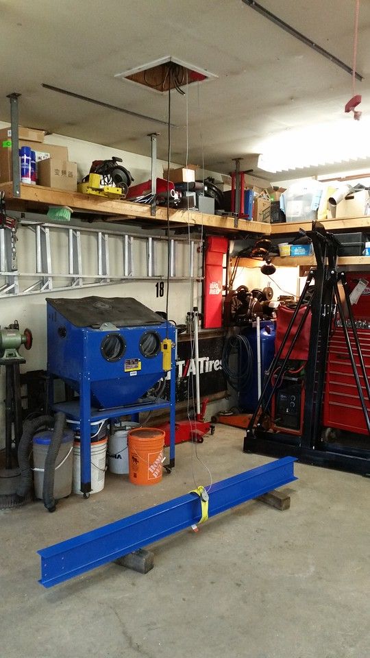

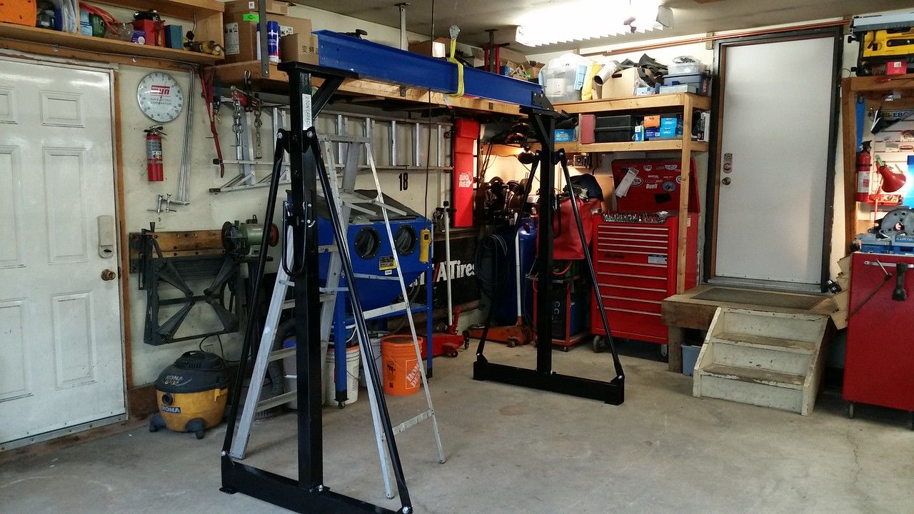

So when Princess Auto put their 2 ton gantry on sale last week for $800 I couldn't resist. I brought one home. I would wager you couldn't buy the steel to make your own at that price. I just discovered however that whereas their 1 ton gantry is a fairly easy 1 person assembly project the 2 ton is a challenge! All parts on the 2 ton are a lot heavier and the overhead beam is close to the limit of what one person can manhandle. I was fine getting the first vertical post attached but attaching the second safely was hard without special equipment or additional helpers. I ended up using my engine crane to lift it part way and manhandled it the rest of the way onto a temporary scaffold I made out of scrap lumber. The scaffold held the second upright in place and provided a wider more stable target for the beam to rest on before it was aligned and attached.
It was so much trouble getting the thing together I can't see myself keeping this disassembled for storage and putting it together again every time I need it. The assembly is close to permanent and will have to stay outside to brave the elements. So I expect to make some kind of plastic envelope around it to protect it from the elements. The thing has about 60 bolts in total so not designed to be easily dismantled for storage as far as I can see.

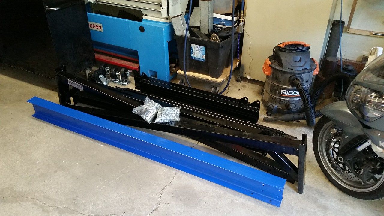

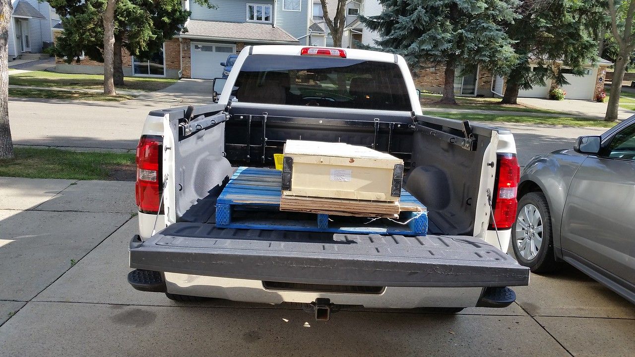

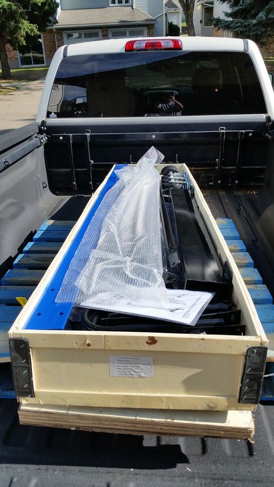

We got our 2 ton crane yesterday. I picked it up at the Purolator Freight yard in south Edmonton because they could not deliver it when I will be home. After taking a few measurements I can see some problems. I thought the total height in the lowest position was going to be 94" but that is the height to the bottom of the top beam. Total height is 100". My 8" garage door only has a 94" height at full open so I'll have to come up with a plan to make it fit. The wheels are 6.5" tall so it will fit through the opening without the wheels but of course that would be pretty inconvenient, LoL. We are heading out camping for a week so I'll have some time to think about a solution.
As you can see the bottom was blown out of the crate and after I cut the strapping off it just fell apart. Pretty flimsy crate so I'm surprised it made it here from China in 1 piece. No big deal as I planned to unload it piece by piece anyway.

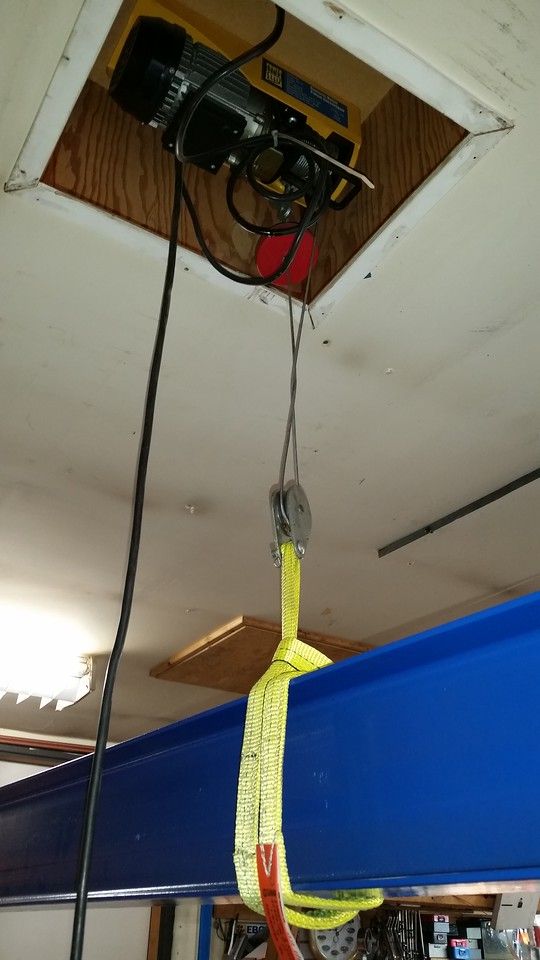

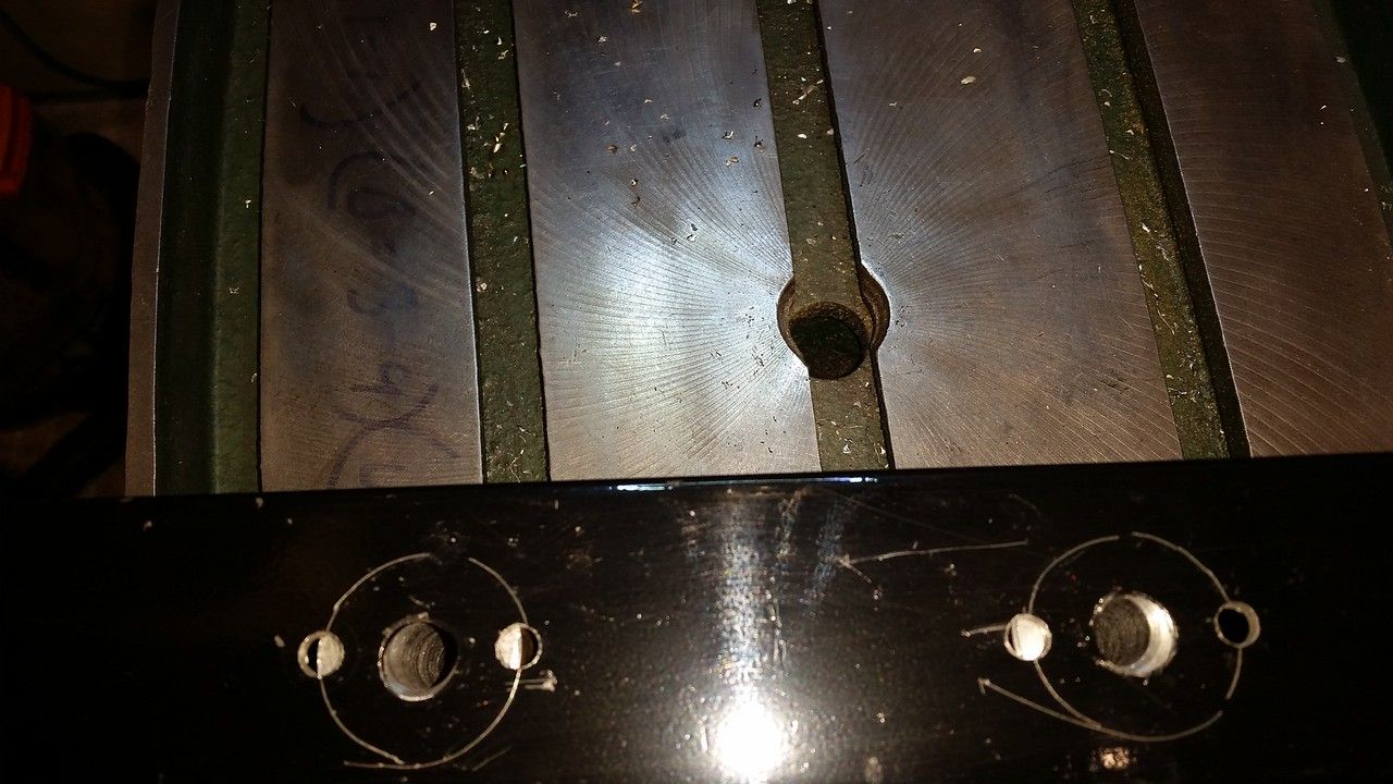

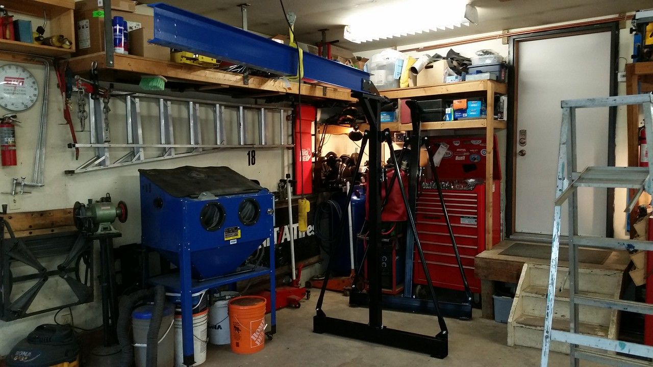

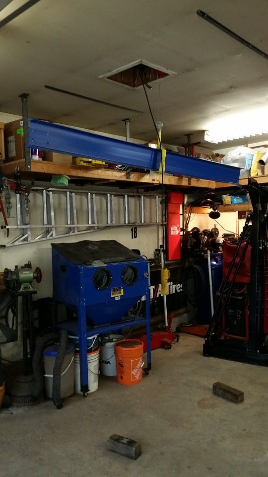

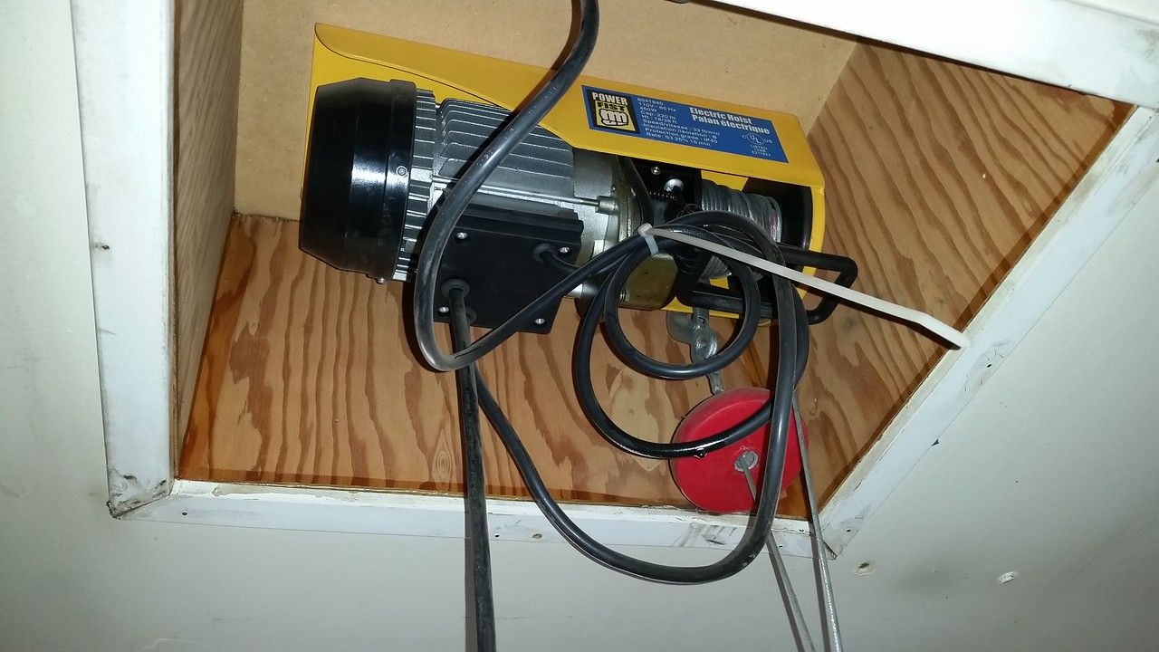

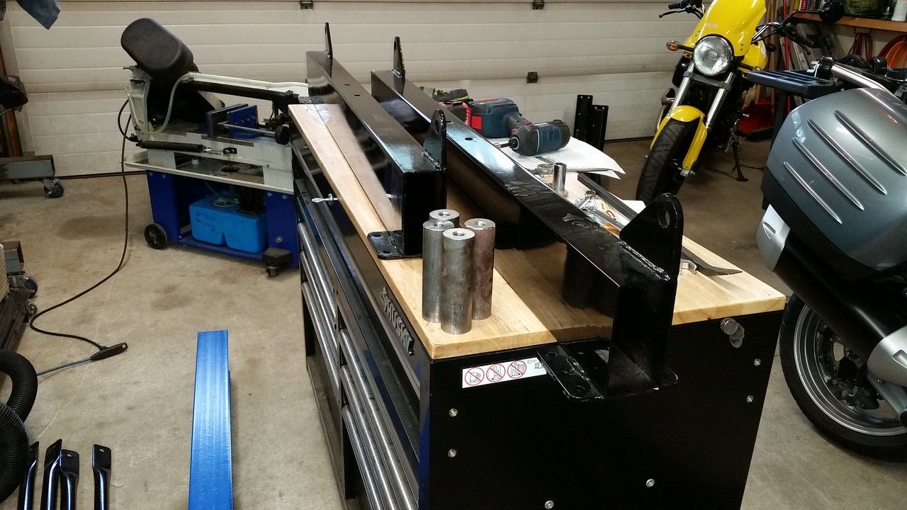

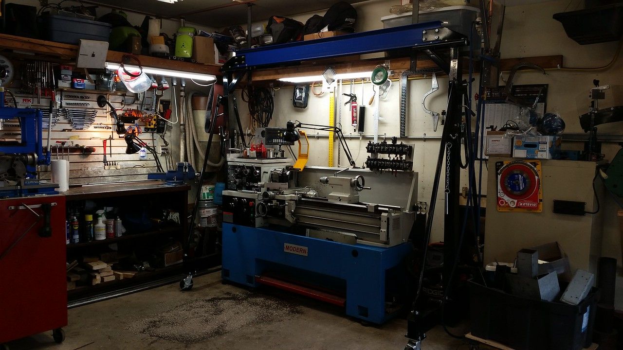

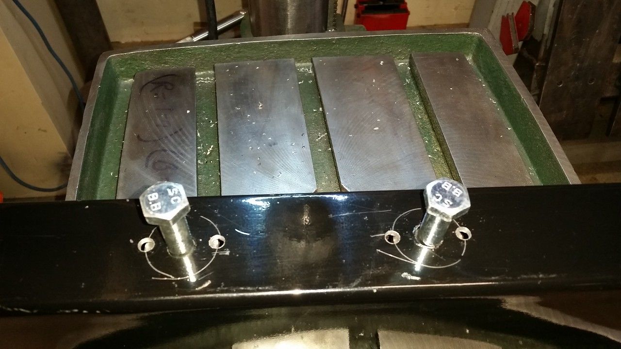

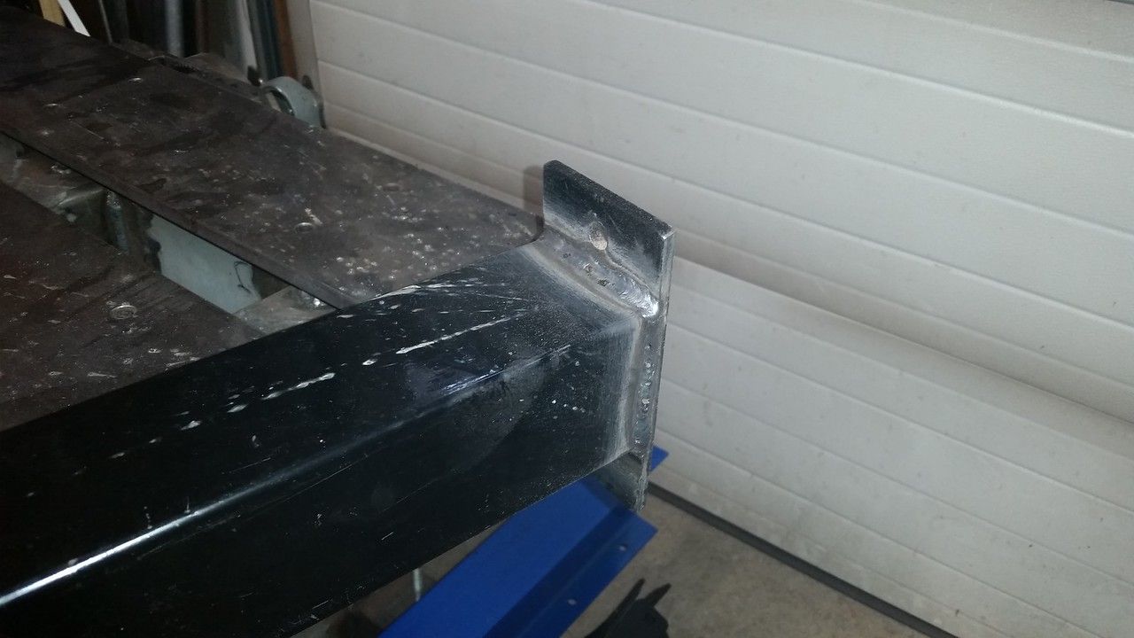

I got the crane assembled after a few modifications. I didn't like how much the horizontal bottom beams tended to crush when I tightened the bolts that hold them to the vertical tower pieces so I machined some stuffers from 1.25 hot rolled. The are .010" shorter than the inside dimension of the rectangular pipe that makes up the beam and the bolts now tighten nicely without feeling like the pipe is crushing. To get the clearance needed to get through the garage door I cut 7" off the bottom of the inside and outside vertical telescoping tubes so the total height when fully extended will now be limited to about 132". I had to cut the mounting feet off the outer tubes and weld them back on after shortening the tubes but that went smoothly. I also had to shorten the 4 diagonal struts. The are made of 1.5 round tube so I just put them in the press and flattened the spot on the tube where the new bolt holes would be and cut off the excess. Over all I am pretty impressed with the quality of the crane, all the hardware is decent quality and all the holes lined up properly. I assembled it by myself using the little PA 440 lb electric hoist that I have in the ceiling of my garage. I used that to hoist the overhead beam up to the proper height and then just stood up the assembled towers. It was easy working off a step ladder to then get all the bolts installed. I was worried about how much space it would occupy in the garage but I found a spot where it snuggles up against the wall and sits over top of my lathe. It's pretty out of the way there.
These are the stuffers I made for the bottom tubes. I drilled two 1/4" holes at the end of each stuffer and tig welded them in place.

Nice! I never expected to see a winch cable coming out of the ceiling but it’s not a bad idea.
I went the other route and have the Haas going into the ceiling.
