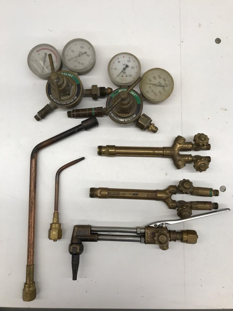

I wanted to add oxy/fuel capability to my shop.
I looked at a couple of rigs for sale and was under impressed.
So I sourced a used oxygen tank and today I picked up a set of used Victor 350 torches and regs.
I think I got a sweet deal: two torch bodies, one with built in flashback arrestors, and brazing, cutting and rosebud heads.
Picked up new Type T hoses as I’m planning to use propane as fuel.

Oxy-acetylene- you light the acetylene then add oxygen
Oxy-propane- you need to have both oxygen and propane flowing before lighting
Other than that they are pretty similar, besides the above mentioned tip difference

I can get a oxy/propane rosebud attachment, looks like part MFN vs. MFA which is for acetylene. I may be able to just swap the tip.
The Victor info on brazing tips is a bit harder to decipher. I will call ESAB to get some clarity.

Hi Peter, I don't have an acetylene setup so just trying to sort out what necessary to run propane.
The Rio Grande torch looks interesting though I think to add oxygen you would need a completely different torch. Otherwise I don't know how that torch would mix the acetylene and oxy.
My thinking on propane is that I can get a 20lb tank at the corner gas station for $20 vs $70 for a similar sized acetylene. So the low cost of propane is attractive. That said it takes approximately three times as much oxy to run propane vs acetylene. I exchanged my 125 cu ft oxy tank yesterday for $33 at my LWS so that's pretty cheap. Does it offset the low cost of the propane? Hard to say but I doubt it.

Back when I was doing a lot of heavy cutting I estimated it at one 20 lb (BBQ) propane tank to 10 K sized (largest size) of oxygen
It used to be $50-60 for a tank of oxygen, and $20-25 for propane, whereas acetylene was around $100
Plus every hardware store and gas station has propane when needed. No tank purchase or rental fees for an acetylene
I always hear oxy-propane is unsafe or doesn’t get hot enough or whatever. I know one salvage yard that used oxy-propane for 30 years, and most salvage yards around here that’s all they run. I would think businesses would look at numbers pretty close on consumables, especially stuff like cutting torch gas that they use a lot of.

Yes, my needs are heating and cutting. I can't see myself welding though brazing is an option. I do have TIG available but I've never tried it for brazing.
Brent H
@David_R8
most of the ship yards and fly by night repair/ship work folks are Oxy/propane - it’s a lot cheaper and most of the ship yard cutters/fabbers are pretty unskilled and wasteful. Makes perfect sense to use cheaper consumables like gasses etc for jobs.
for @Chicken lights set up It makes perfect sense as the poor lad is always on the road. -
what is the pressures you are dealing with for the propane? Acetylene is only about 5psi for thicker stuff - do you need to run the propane higher?

David your regulators might have flash back arrestors but I do not see any on other pictures. The Rio grande torch seems to be missing it too. I was told by the weld instructor they are required in Alberta anyway. Be a good thing to add to any torch setups.

I should look but I want to say 5-10 psi on propane and around 50 psi on oxygen
