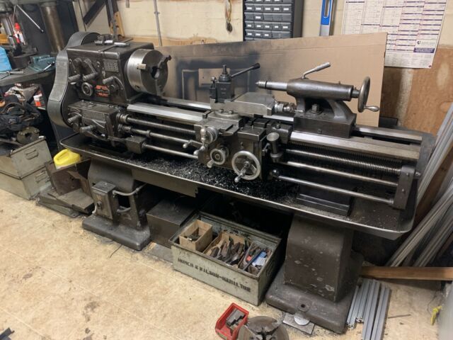

Oh man - this could be a great deal.... 13 x 48 ....some nice additions $2500

3” x 49” Henry Milnes Lathe. Made in England. 1960’s. 220 volt 3 phase Has gap piece in bed for turning large diameters Comes with: Quick change toolpost - wedge style. Not cheap piston style. 3 jaw chuck. Internal/external jaws 4 jaw chuck Collet chuck Slotted faceplate Steady rest Follower rest Dumore precision toolpost grinder Beautifully made machine quality that you just can’t get anymore. Comes with everything you need to make parts. Original brochure and maintenance manual in prestine condition. She’s old and a little sloppy but still runs good. Hooked up and can be demonstrated Asking $2500 Buyer responsible for moving costs. Can refer machinery mover for serious buyer. Weight approximately 2,000 lbs
Besides the truth of what @Brent H says about us always being willing to spend others money..... This does sound like a beauty. It is what I was once looking for until I gave up and bought a new one.
This paragraph gives me mixed emotions:
I love that it comes with a nice tool post grinder! I love that it comes with the manuals. And I love that it is hooked up so you can see it running.
But those words "it is old and a little sloppy" scare the heck out of me.
The description isn't clear about whether the bed gap has been removed before either. My experience with removing the gap is not good. I have never removed the gap on mine and baring an extreme emergency, I never will.

That offering, its the sort I always looked for, in fact waited for; it has everything. 3J, 4J, collet chuck, steadies, faceplate etc. I'd pass on most lathes until one like that came along (assuming its not clapped out junk)....if you don't get one with it all, it takes so much time and money to collect it all afterward
Since grinders are famous for spewing damaging abrasive dust all over it begs the question as to how much wear exactly there is on the ways. According to http://www.lathes.co.uk/milnes/ the weight of 2,000 lbs is about right and the spindle is just a simple thread on which I do not like. Otherwise it looks like a heck of a deal if you have the space and the ability to move it.
The grinder is part of the lathe??? That possibility never crossed my mind! I would not like that at all!!
Abrasives are not allowed anywhere near my lathe. I have home made spinner for that, and sometimes I cover the ways on my old antique lathe and use it.
Don't really trust screw on chucks much. Really hard to use reverse. Had the chuck back off on my antique lathe once. Didn't come off, but that was no fun at all. Scared the bejesus out of me. Have not investigated, but somebody must have come up with a lock system of some kind by now.

Not really, there are good techniques for proper cleanliness when using a toolpost grinder. Contrary to what one faction says, they don't ruin a lathe - lack of cleanliness and improper use can ruin a lathe.

For sure! But the question in my mind is did the owner use such proper techniques or was he in a hurry cutting corners frequently. My guess is this lathe was used in an industrial setting and was probably used quite a lot. Any way you cut it, it looks like a pretty good deal if you have the space and ability to move it.

Its all speculation unless you get access to the lathe...even then, lathes wear out from use, lack of oiling etc that have never seen a grinder. For that matter, just because there is a TPG, maybe it was used 2x in 20 years? who knows.
End of day, wear is wear. The key is to assess how much and whether you can live with it (A little doesn't make the lathe useless, a lot can be problematic, like when the carriage stops riding on the V lol) or fix it. (reconditioning, BIG job, make sure the lathe is worthy).
btw, Grinders don't put out much abrasive except when dressing (then its a free for all). I try and give extra protection when dressing, e.g. cut out carbard box to contain a lot of it. If you've much grinding wheel wear is very slow so there is not much abrasive come of during grinding. If you example the sludge after the coolant dries(yes, I lead a charmed life :) ) its chips (fine) not abrasive. I have a T&CG set up for cylindrical grinding so don't often use a lathe, and while I'd prefer to minimize it, I'm am not adverse to it. I can only internal grind at the moment on the lathe for example. Everything gets sealed off with paper twoels held down with pot magnets (rags can be dangerous around machinery).
as for the spindle, in larger sizes (threaded is the norm with smaller sizes), a threaded nose is pain in the rear compared to cam locks However it limits very few things you can so is infinitely better than no lathe :)
