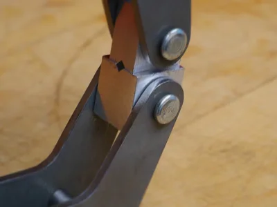

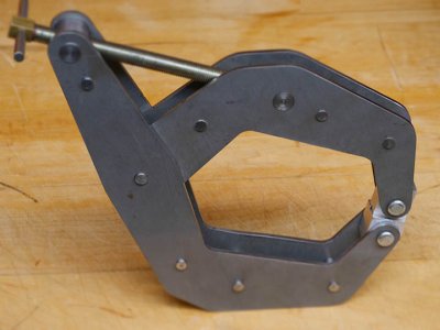

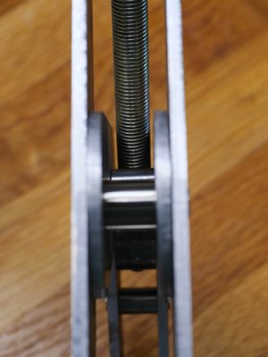

This summer I have been designing and building my own version of Kant-Twist clamps in 3 sizes - 2.5", 4.5" and 6". I have the 6" one finished and will include pictures. I am happy with the design and have learned a lot from the process of building my first clamp. I had a decent quantity of the various arms manufactured locally, using a laser cutter, and this has worked well. Of special note is that the design includes all necessary holes - very precisely located to make the clamp go together accurately and work smoothly. I created a document with many more details and will attach that for anyone who wants to read the fuller story. This documents covers the flaws in the clamps I purchased, the major design goals of my re-design, the process of making the first clamp and some prices.
Happy to make available sets of the arms to anyone interested - details in the document attached. My thinking is that only a few of you would want to read 5 pages of details on this subject! But, for anyone interested, the complete story - so far - is in the attached PDF file.

Just finished making some of the larger arms look nice, using a 1" abrasive pad. One new image shows a pair of the short arms - one as it comes from the fabricator, the other after using the abrasive pad. The second new image shows a complete set of the arms after treatment with the abrasive pad.
Mcgyver
those look great, good job! Kant and parallel clamps are the ones I use the most, you just can't have too many of them!

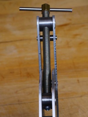

I've reviewed your pictures and the PDF quite closely now Brian. Post more pictures! Nice job. I have a few questions:
  1. Are the peened standoffs holding the arm sandwiches together the only thing holding the arms on? I don't think there is any peening or anything else at the pivot parts with the threaded rod or the main pivot point?
  2. Related to this is the threaded hole standoff - it looks like it just rotates in the hole and is held in place by the clamp arms? Yes?
  3. The aluminium clamping pads are attached with clevis pins - in the pictures the cotter pin isn't visible. Did you use that kind of clevis pin or something with retaining rings? or some sort of chicago bolt setup?
  4. Is there a "quick" version of a kant-clamp where the threaded rod can be moved back and forth without turning for gross adjustment and then the nut engaged for clamping? Kind of a half-nut arrangement for kant-clamps?

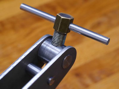

one more question - how exactly does the threaded rod mate with the end that pushes and pulls the arm? #10 screw ok with a bit of loctite holding it - I assume the screw is a bit loose and the buttom of the head pulls the clamp open? What about the pushing end in the block? Any lubricant in there ?

Insightful and, in the case of your No. 4 - most interesting! Here are some specific answers:
1. Yes - only the "standoff" pins are peened. All the rest need to rotate.
2. Yes - held by the peened standoffs. Note that my redesign has added an extra pin in each arm to make this a lot more sturdy than the original. This especially applies to the third point below:
3. None of the above! I took a standard, 2" clevis pin and shortened it to the right length. Then, when drilling the hole in the aluminum, I made sure to choose a drill bit that would result in an interference fit for the clevis pin. Then, just pounded it through! So, the aluminum block does not rotate on the pin, BUT, the whole assembly rotates in the holes near the ends of the arms. Cannot get loose because there is an arm on each side. Big plus: Easy to replace these pads if ever it becomes necessary. Just pound them back out!
4. What a great idea! That would save tons of twisting - especially when you use a 7/16-20 threaded rod like I did. We need to get our heads together on this. See below also:
5. I would welcome your help with this. I tried to learn EasyCad, but that is not going too well - there are so many basics to learn before you can actually do anything! I also tried using just Microsoft Word - and that has possibilities - but just 2-D of course. As it stands, my plans are, er, sketchy to put it mildly, but for the most part, understandable. Can I get these to you somehow - or, even better - bring them to Calgary? Send me a message outside the forum (or, call me...) and we will make this happen. I would be more than pleased to meet with you - or whatever you think is best.
Thanks for the informed and useful response. Cheers,
John
I turned down the threaded rod to 5/16" for about .750". Then, after turning the smaller diameters on each end of the "push/pull" part, I milled a flat on the "top" and "bottom" of the rounded section of the 7/8" steel rod I used for this part. Made the flats 180 degrees from each other of course. This left the distance between the flats at a bit less than 3/4" - so the turned-down portion protruded maybe .010". I made sure the 10-24 bolt would fit properly, then used my sander to shorten this turned-down part so it just barely clears the "width" of the flats. This is finicky of course, but it only took a few minutes. Net effect - there is very little "play" in this part of the mechanism - perhaps 15 degrees? I could get it closer perhaps - but then differences in the shop temperature might make it inoperable!
No lubricant in the other end, apart from what might remain after the lathe work. Could easily be added if it ever needed it. Another great idea! Cheers

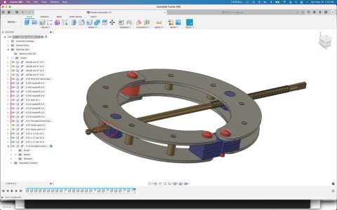

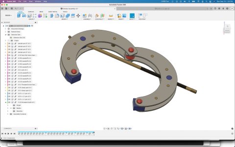

I got busy and designed up a version of the dimide in Fusion 360. This is about a 6" throat depth version.
I've been mulling over options on how the threaded rod would exert the clamping pressure. The area in red circle is still to be defined. I was thinking of using two locking collars on the threaded shaft - one on each side of the stand off - probably with flats or even holes going right through the threaded rod for a pin. Any suggestions on this? I see on the starett 164 there are two square blocks on the shaft. The one located on the threaded section is clearly threaded and moves back and forth exerting the clamp pressure. The closer one at the handle end though is not so clear what it is doing. It seems it must be fixed in place yet also allow the shaft to spin - @eotrfish how does that part work? Perhaps the knurled handle part presses on the square block and the rod simply spins inside the block? Is the threaded rod and handle all one piece? and thanks for posting that disassembled picture it's interesting.
Does the far end of the threaded section have a screw on stop?
I also like the standoffs are internally threaded and use machine screws for assembly. And the bend in the arms means you only need one length of standoffs and only one clamp pad depth - very clever Starett. (Edit -> well not quite looks like there are a few different lengths of standoffs) And I see the standoffs holding the clamp pads have a different head diameter - I wonder why they did that?

Probably one piece shaft there’s a shoulder and a circlip, pinned is also possible as no forces are in that direction.
Tom O
Another thing you might consider is the clamp faces being flat like most clamps I think it would be useful to have a v cut in opposite the main gripping flat that way they could be rotated to hold round to flat or round to round without skating they could have a spring and ball locating the position keeping them in place. I would cut the v on both but at 90* to each other for 2 directions of holding.
