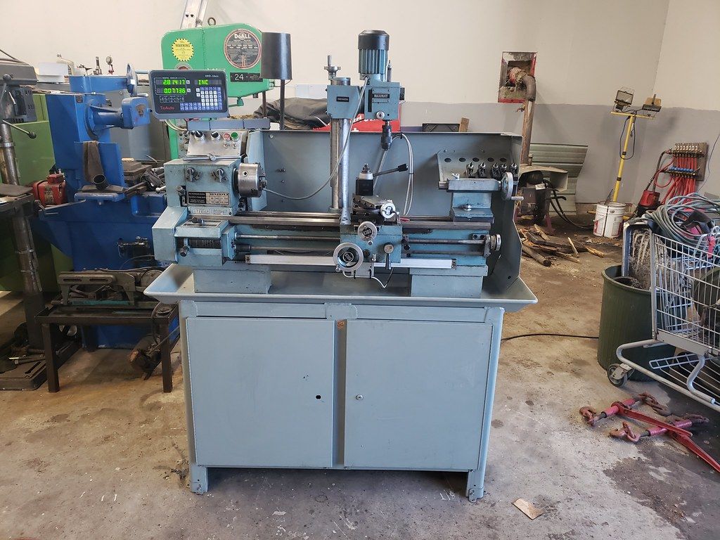

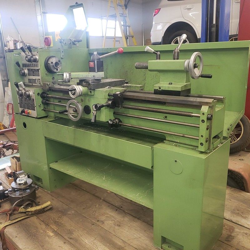

This is my newest aquisition. The much sought after Emco V13. I won it on Govdeals and drove 48 hours round trip to get it home. After a good cleaning it turns out that it is pretty much in new condition.
Ripped out the old guts and installed a VFD. This motor has a brake so i added a 6amp 24vdc power supply and a relay controlled by the vfd. It works very well.
This was my Emco V10p that i recently sold after I got the V13 home. I'm going to miss it. It was a great small lathe. I need to get a DRO on the V13 soon.

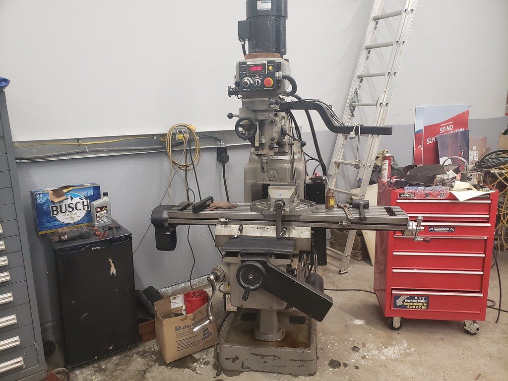

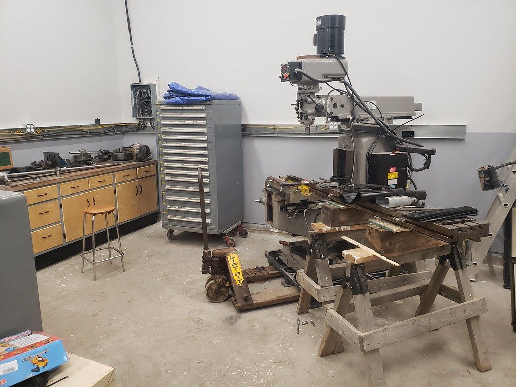

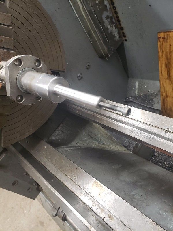

This is my mill. It was a CNC mill that the students at our local college somehow crashed with bad programming and they bound up the X axis ballnut on the screw, wrecked the scale and a few other bits. Unable to buy a direct replacement ballscrew, they put it up on Govdeals. I found a ballscrew on ebay and ordered it before i even bought the mill. Only problem was that it was a 32mm screw, where the factory screw was 25mm, so i had to do some mods. The screws are on the bench in the background.
A wee bit bigger.

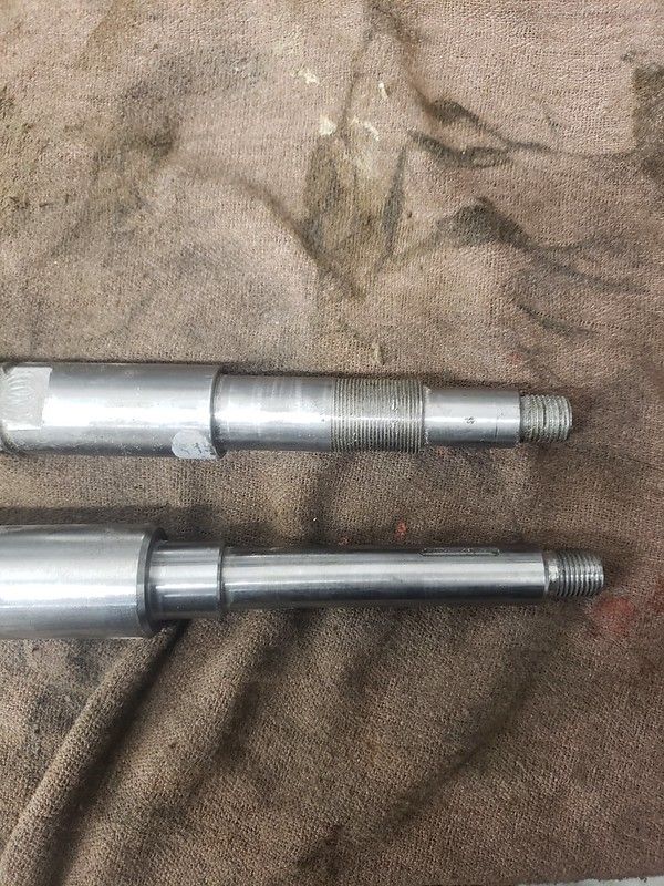

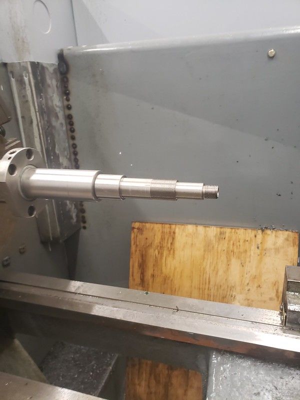

Old screw on the top, i had to transfer the end to make it work.
I turned off the end of the new screw to 1/2" and drill and tapped the end for a 10-32 retainer screw

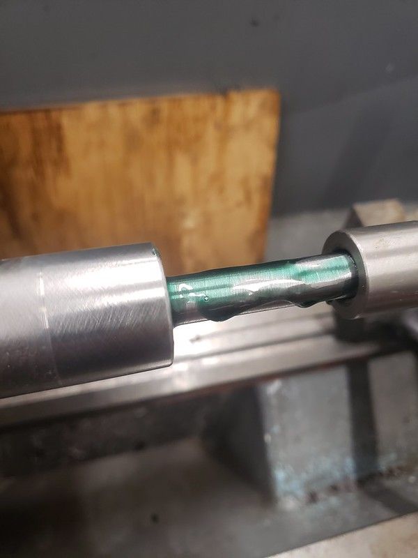

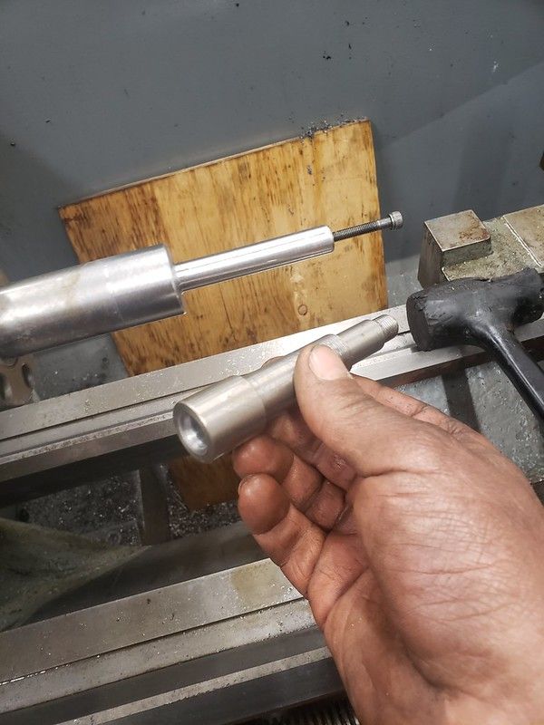

cut the end off the old screw and bored it to a sliding fit onto the 1/2" spigot
and glued it on with loctite retaining compound.
Like brand new
All back together.

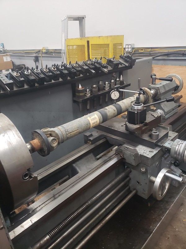

I forgot about the Yoke mods. The larger ballnut required a larger bore in the yoke, which required a larger lathe. So i had to get my SM 1660 up and running.
I had to swap out the 7.5hp 575v motor for a 10hp 240v motor. I found it on Facebook marketplace, same frame size. I then added a 25hp VFD and all the required bits
https://live.staticflickr.com/video...GEzZmE5MjRiZjIyZjBhMjkzM2M0OGExYmMiLCJ2IjoxfQ
typical work on the big lathe

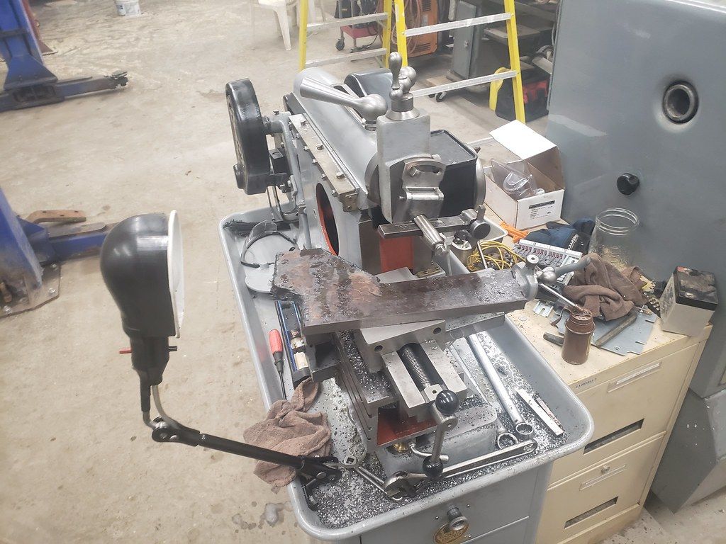

My South Bend 7" shaper. I love this little machine. Its relaxing like a campfire.

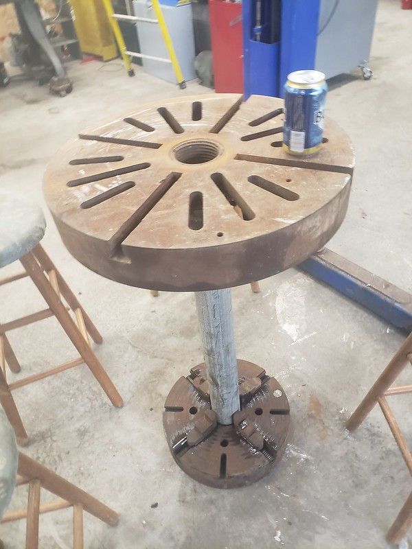

Every shop needs a cocktail table. 16" Burnerd chuck and a 22"ish faceplate
