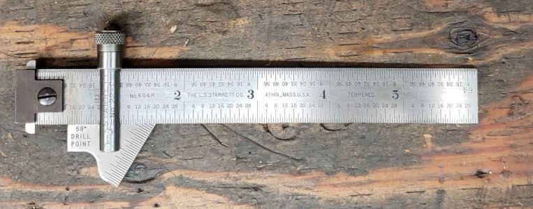

I have a similar set (not Mitutoyo though), which protractors I use depend on the application include the one @Susquatch initially posted. Believe it or not this is more designed for drill bit measurement and used as such will do very well (provided it was manufactured correctly and depends on the luck of the draw).

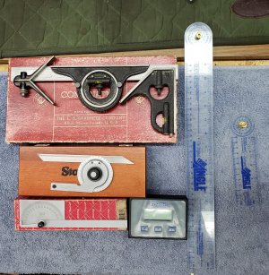

These are what I have. I use Starrett Uni-Bevel protractor (in the wooden box) 90% of the time. The chrome protractor is handy, but also useless. The combination set very handy, mostly for wood working. The Fowler Digital level for measuring camber on my track car. The plastic true angles for drawings.

I'm not sure that the one the @Susquatch
shows is for drill bits, but this one is (which I've almost never use!)
I'm surprised that your favorite is the bevel protractor. I'll have to google how the "BEVEL" function works.
Which one is the "Chrome" one?
