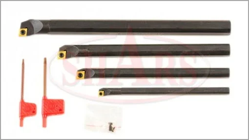

How deep does the 35mm (1.378") diameter bore have to go? If its under say 4" this is classic boring bar weapon of choice. You would pre-drill the hole from solid stock. That's really the more typical hogging/roughing operation. Then use boring bar which will give you more dimensional & finish control over a bit anyway. There is kind of a stick-out rule of thumb like 3X boring bar diameter to minimize deflection & harmonics, but that's kind of a function of other parameters. You can get the insert style boring bars from Ebay/Ali or go the style with HSS toolbit. Wouldn't surprise me if they cost the same.
Tubing would save some swarf but may not get lucky with the size. I don't machine it much so I don't know if its extruded this way or seam welded & normalized?

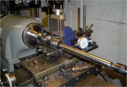

Ideally I need to go 4-5" depth, meaning I'd have to enter from each end and I need to maintain concentricity so unsure how well I could pull that off. if it was 1-1/4" ID tube to start then easier...1-3/8 ID tube would be awesome but I dont know if that even exists in thick-wall.
Ok boring is probably not appropriate if that's the dimensional requirement. I can visualize 2 options:
Forgot the correct name but lets call it 'line boring'. Similar to a boring bar but has adjustable HSS cutter mid section. The bar is driven by the headstock & supported by tailstock center. The tube stock is rigidly held on the cross slide via vise/attachment in apron & you traverse feed. Each pass adjusting the cutter stickout, re-measuring, rinse & repeat. Never done it myself.
Do you really need gun barrel bore contact conformance down the whole length? If not, you could use larger ID tubing to whatever clears the part OD & then machine 2 ends with exact contact ID & attach to either tubing ends. So rather than 10" section it could be 2+6+2=10 total & of course the 6" mid section is un-supported.
