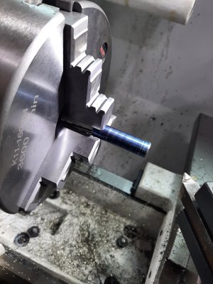

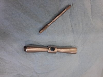

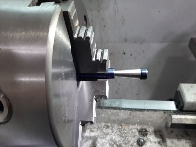

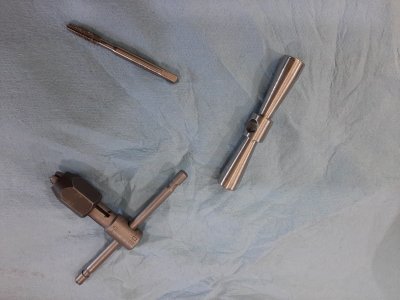

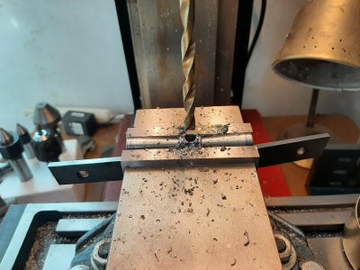

Finished a little project this morning. Would have been a one day project if I stayed with it...:rolleyes:
Joe P did a small tap holder that I thought would be handy to have. My main Tap and Die set is just a Mastercraft set, although I did end up with another tap holder somewhere. The M/C one leaves a bit to be desired but has gotten me by for years.
Material is stainless, .480" for some reason. Joe made his from 3/8 stock and I think I started going there, starting with 1/2" stock, then decided to upsize a bit. I don't use #4-#6 taps much but do use 1/4-5/16 lots so this should be ok for that.
As usual, it was an exercise in basic skill development for me..... The piece was so narrow that to drill the center to the final dimension, I would have drilled into my parallels so after drilling a small diameter pilot hole, I used the parallels at either end (looking precariously perched in the photo) to support the piece while I drilled the final dimension. My fixed jaw does not have a groove to support round pieces. That would be another good project, or use a machined sacrificial piece of aluminum or probably any number of other ways to do it but this worked out this time.
For scale, that is an M5 tap in the photo. I used it to tap the threads for the lock screw.
