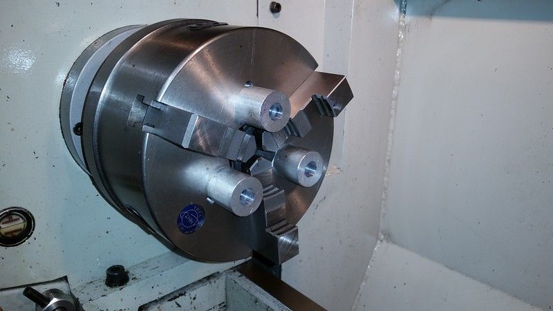

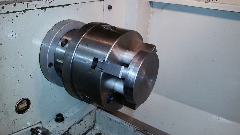

I got this idea from Joe Pieczynski on youtube.
I drilled and tapped 6 M6 holes in my 3 jaw chuck and made some stand-off pieces from aluminum. Free and easy to make any height you want.
John

John Conroy
member
I measured the thickness of the front face of the chuck and it's .700" thick. I drilled the holes to a depth of .600" so I have at least 1/2" of threads. I am making some parts for my 8" bench grinder to compensate for shaft runout and this method allows me to achieve parallelism withing a couple of tenths easily. More on that project later.
