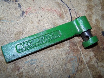

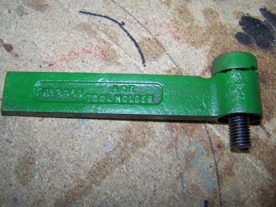

I have an Ace tool holder No. 2060 That is missing the nut. The thread is 16 tpi but a 3/8 nut is too small. WTF?? I s this a "special size?? Thanks for looking...........................Daniel

7/16 should be either 14 tpi or 20 for NF I believe..................Chawbeef
Read the article I linked to. The original nut was 7/16-16. https://www.wisconsinpartsdatabase....haper-tool-holder-parts-armstrong-ace-2060.pl
Here is a 7/16-16 tap and die set. Make your own nut.

I've never seen a 7/16 X 16tpi before. I also see the nut has an integral washer. Cool....................Daniel

According to my Starrett thread guage it is 16 tpi..........................Chawbeef

One thing you will learn hanging around here. Thread standards only apply when the maker follows them...... I think I am the master of getting screwed by screws. Here is what I have learned the hard way.
Step 1 - is identifying the thread pitch using a thread gauge. If one fits EXACTLY, you get to go to step 2.
Step 2 - is the diameter. But don't forget that the diameter is usually reduced for thread clearance. If you are lucky enough to find a diameter that matches the tables for that thread pitch, you get to go to the next step.
Step 3 - test fit a nut or screw. If you have been lucky, you have nailed it.
If not, throw the thread gauge back in the drawer. Time to figure out what you really have...
Your tool holder is a lantern style rocker tool holder. They often predate thread standards. Which means they might match a standard or might not. Praying does not help. Ask me how I know.....
That is clearly a specialized screw. I would not mess with it unless you have the skills and equipment to duplicate it. That means you must find or make a nut to fit it.
Don't get hung up on what the standards are today. Just go by what your measurements tell you. You can often buy specialized taps that don't meet modern standards.

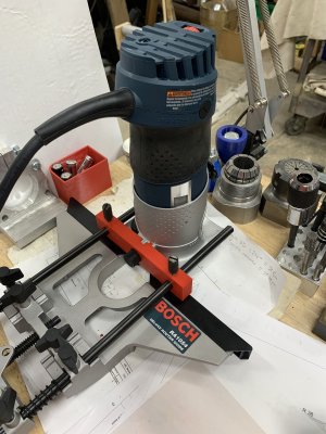

I made this red adapter for my router. I was positive the finger bolts for the rails were 1/4-20. I measured it with the calliper and the thread gauge. The bolts would not go in past a bit of a turn what the heck? I printed it again and same issue. So I recheck the bolts carefully and a M6x1.25 is a thread pitch of 20.32”. The thread gauge is a little bit tighter on the threads with the metric gauge but still pretty good with the imperial. Subtle…change model to M6, reprint, and the bolts go right in without even retapping.
