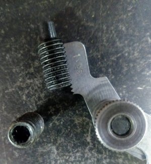

Anybody have a line on where to get 10x20x1.25mm screws at a good price for AXA tool holders?

Are these for your tool holder clamp screws or the adjustment screw?
Thanks for the links, I'll check them out. They are for the tool holder clamp screws. Mine are also made out of a poor "cheese substitute".
Don
Seems odd they would use a fine pitch 1.25 vs the more conventional 1.50 pitch for M10. That's why I was asking.
DPittman
Ya I wondered about that too but heres a pic...

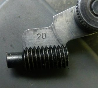

How does a 3/8-20 gauge look on it?
nominal M10 OD ~9.8mm = 0.385"
nominal 3/8=.375" <--- pretty close
1.25mm = 0.049"
20 tpi = 1/20 = .050" <--- pretty close
DPittman
Pretty close but not as good as 1.25mm. The picture looks like a better fit than it really is. I should be able to interchange....I'll give it a whirl...

No not suggesting you interchange. It may well be 1.25mm pitch. Its just that it would not be the first time a badly made fastener actually starts to resemble a different spec thread!
I have some offshore SI fasteners where IMP hex wrenches fit better & visa-versa, so one just starts to logically think.... must be an IMP. And that's new, not galled or anything.
But as I was mentioning elsewhere, these tool holders in particular can have some strange screws, at least the older ones.
