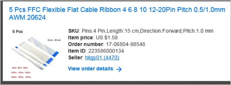

Can anyone tell me what the flat connectors that are used in laptop to connect remote components to the motherboard are called? And the clamp type connectors the use are called?
I'm not referring to ribbon connectors used in desktop pcs but rather the stuff in the pic
TorontoBuilder
The product I was looking for is called flexible flat cable and the FFC/FPC connectors are a type of connector intended to connect FPCs (Flexible Printed Circuits) and PCBs (Printed Circuit Boards).

I wanted to know the name to input into google since I was striking out on my previous searches and getting inundated with ribbon cables.

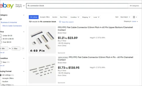

There are several styles of connectors and tapes. That connector is for a tape that has physical pins added to the strip.
The type I'm after just clamps the tape to a block and is thinner. It of course will also be in the same pocket as the pcb itself so that there is room for the connector, and yet it is much smaller than typical read head.

The items in the images are just one commercially available encoders on a chip. These are designed to be embedded into the manufacture of industrial machinery that require multiple positioning sensors for high degree of accuracy. Hence the type of connecters chosen. They equipment is designed with hard mounting pockets and channels where the heads are generally fully enclosed.

One is the read head to be fully embedded in the machine with a 4 pin FFC connector as shown above
The other is a pcb with both a FFC connector and a 4 pin aviation type connector.
This will allow a 4 pin FFC cable to be encapsulated in a .25 mm deep slot in the machine using epoxy, with a different on pcb at either end. Then the regular stainless steel shielded cable will run from the waterproof aviation connector to the DRO unit. this design will allow the two boards to be mounted any distance apart on the machine. It will allow multiple mounting options from small external brackets to machined pockets that do not remove much material. It leaves the guts fully protected, and provides a very secure aviation connection that has a very low profile on the exterior of the component it is mounted to.
