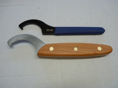

Well I bite the bullet and bought the Precision Matthews ER40 D1-4 chuck. I haven't spun anything yet but it dialed in with less than a needles worth of movement on the DTI and seems very well made. I bought a 15 piece collet set as well that also seem to be well made.
The only thing I don't like is the wrench, it is made to fit 55mm to 62mm so it doesn't fit the ER40 nut well. Will it work? yes, is it pretty? no. I expected an ER40 chuck to an ER40 sized wrench. I didn't realize that the 55-62 stamped on the wrench was the sizes of nut the wrench was supposed to fit, I thought it was just a part
number. I sent an email to PM about this and just got a generic blah blah response.
Damn, looks like I'm going to have to find some wood and rivets and make a new wrench that will actually fit the nut. And as the lathe doesn't have a spindle lock I think I'll make a wrench for the chuck as well.

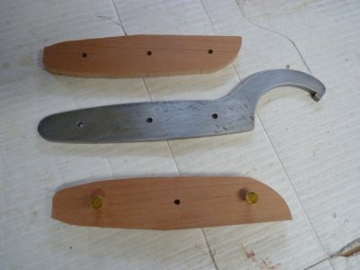

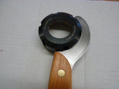

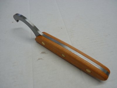

I finally got the wrench done. I used some 3/16 fb that was kicking around, rough shaped with a cut off wheel on the little grinder and then to the bench grinder for a bit more fine tuning. Used the belt sander for some close enough until the handles are on shaping. The inside arc was done on the milling machine with the rotary table and filed the tooth to shape. Then it was on to the handles, a bit of left over cherry from another project, some epoxy and rivets to secure them to the wrench. Back to the belt sander to bring the wood to the same shape as the steel, router over the edges (of the wood), sand smooth and add four coats of teak oil. Done! Much nicer fit than the wrench that came with the chuck.
I'll try tightening with a strap wrench on the chuck and see if it comes tight enough, if not I'll make the same style wrench for the chuck.
