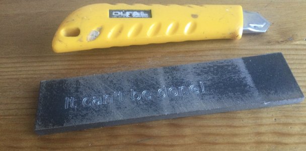

Prior to COVID I picked up a little 3018 CNC router off Facebook. Other than playing wit CNC I wanted to mill my own circuit boards. There is an active Facebook page for the 3018s. Yesterday someone asked if it could engrave steel. One of the responses was “not a chance” so........

I’ve looked at those and wondered how capable they might be.
Johnwa
They are OK. They can’t take big cuts in wood so small(tiny) bits are required. Therefore they are rather slow and small projects are the best. To cut out my circuit boards I do it in two passes with a 1mm bit and a feed rate of 350mm/min. Best part is that it can drill all those holes quite accurately. For circuit boards there’s a bit too much play for my liking. For engraving and wood carving they’re fine. Upgrading them can become a money pit though, you fix one weak point and then run into the next. I’m trying to avoid that.LOL

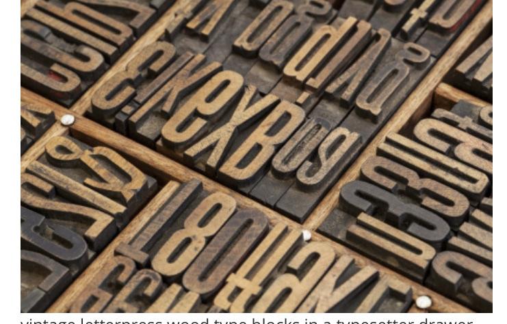

"wooden type" ????
Yes, wooden type for printing presses.

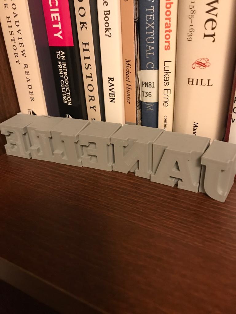

We have a small press and I’m designing a large screw type press to print larger formats.
Wooden type is highly sought after and can be fiendishly expensive.
It’s typically carved out of a fine grained hardwood like cherry or maple.
This is 3D printed type I made as an experiment.
This place has the largest collection of wooden type in the world.
https://woodtype.org
