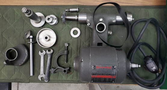

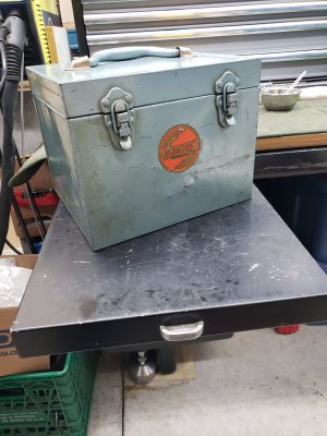

I just picked this up from Facebook Marketplace. It's missing a few pieces, but the motor sounded good, no noise from the bearings, and no play or looseness. It is designed for lathes between 8"-14", and my lathe has a 16" swing, but I'm sure I can make a new mounting post to make it work.

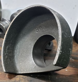

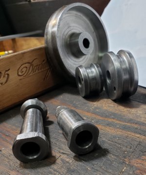

Well, I just quickly went over the unit. I should have titled this post Caveat Emptor!!

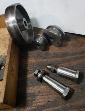

I'm a little disappointed. The bearings and motor feel and sound good, but the unit comes with 5 pulleys for speed changes. Two of them have been modified, and made useless. The chuck assembly for mounted stones, and small wheel arbor, have been modified and made useless. The belt guard assembly is missing. The wheel guard seems to have been modified and the wheel guard face plate is missing. I was so excited at finding this I didn't do my due diligence research. So checking the Dumore site, to replace all those parts will run me $677.00US, not including shipping, and taxes. Oh well, it is what it is.

Well, if the motor is good, the rest can prolly be saved. If anyone can do it you can.
You can make your own pulleys.
You can make or adapt your own chuck - prolly way better than the original.
You can also make your own gaurds and face plates better than the originals.

There was no belt guard on the old machines. At least on mine there is no provision for one on the belt side.
Your wheel guard looks complete. There is no face covering. It is held to the spindle body with a single machine screw (which you have). Wheel guard is only used for OD grinding.
Yes, the motor runs in only one direction. It has LH thread on the shaft. Both sides of the spindle have RH threads so that either the pulley or the grinding stones/mounted stones have a tendency to tighten their respective threads during grinding.
I believe there are only 5 pulleys. You need the 2” and 3” one remade (or purchase them, as they are precision balanced).

and it does show belt guards, and wheel guard front plate.
I will be purchasing the pulleys from them. They are crowned wheels and balanced, and I think it might be difficult to get the crown radius correct without tools that I don't have. I would think that if the crown wasn't correct the belt would slip off, or at least be off to one side. Besides, Dumore sells them for about $20.00 each, and I only need to replace the #2, and #3 pulleys, the others are good. What really sent me for a loop was that the Chuck assembly for mounted points, and the wheel arbor for small wheels get screwed into the shaft of the main spindle, but somebody drilled out the threads of those units. The wheel arbor is easy enough to make, but those chuck assemblies would be more difficult, they run about $75.00 each. The belt is $20.36, which seems fairly steep for what it is, so I will check with McMaster-Carr or a transmission supply like you suggested.

I believe I have that same Du More kit. If I remember right I think mine is a one half horse I haven’t used it for a while it’s still out in the box sleeping. If I can help you with information just let me know thanks

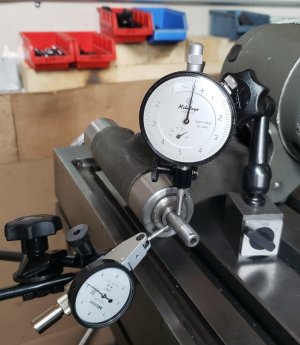

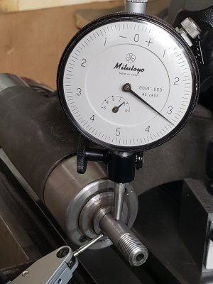

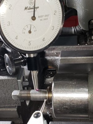

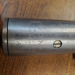

Well, I did some measurements at both ends of the spindle, and the faces. At the motor end, the spindle runout is almost zero, with a tenths indicator it just twitches. At its face, .0003" runout. At the wheel end, spindle runout is 0.0036", and at the face, 0.0011" runout. If you have a look at one of the pictures, you can see damage at the end of the threaded section, which incidentally corresponds with the low reading. Oh well, c'est la vie! I'll test the whole unit and see if it gives me acceptable results.

That’s too bad about the runout. My guess is it had an unfortunate accident while in use or it was dropped with a stone/wheel mounted.
So went and checked my #44. There is in fact no provision for either a face cover on the wheel guard nor for a belt guard on the drive side.
I think @trlvn is correct that there must have been updates to the grinders over the years as OSHA rules were tightened.

That looks exactly like mine. Thank you. I really appreciate you going through the effort.
So at least now I know I don't have to buy extra stuff, unless I decide to retro fit the belt guard (which is the least important part of this endeavor at the moment).

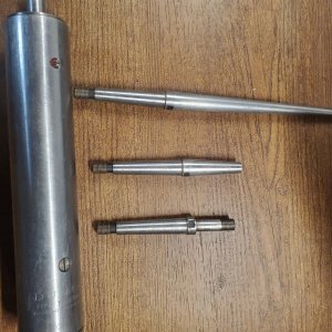

I might be able to help with the spindle. I have one that I purchased with some collets if I remember correctly, thinking that for the price it would be a cheap spare for mine. When it arrived, I drug mine out only to discover that mine is a South Bend. Lol.
I put it in a drawer and have been doing my best to forget about it. I think there's three stone adapters..... I can try and get some pictures of what I have later. There's no pulleys though....
I think I am into them for around fifty and shipping.

Hi Don, yes please. No rush. At your convenience. Thank you.
To be truthful, I know nothing about these things, but I think two are for internal grinding and one is external. Only the longest one has what appears to be enough pieces to mount a stone. The rest will need washers and mounting screws etc. I think the bearings feel smooth.......
