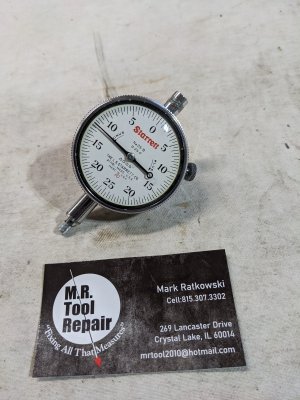

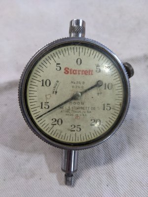

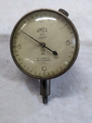

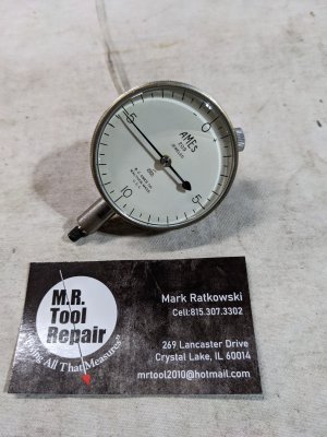

Well isn't this timely. These appeared in my post box after my last post. Mark at M.R. Tool Repair did a fine job
When I shipped them they were completely gummed up. Cleaning, refurb, and new glass. They work like new. Here's before and after. All in including GST, shipping and US/Cdn exchange was $148.51 for two. Was it worth it?

Well they did turn out very nice. If they are accurate and have any "historical" value then they are likely worth the refresh they got.
Mcgyver
those look fantastic, looks like they did a great job. They seem quite a bit a cheaper than what I've heard Long Island is, $100 - 125 US? You also tipped the scales a bit spreading shipping across two indicators.
Worth it? You're the only judge of that that matters. My opinion? There's a big spread between the bid and ask, i.e. if its "without this fixed I'd be ordering new and they would cost me $350"... then for sure it was worth it. otoh, I don't think I could sell the two for $150 so its not worth $150 having them fixed (not that I'd be bothered fixing just to sell, just that its a measure of worth). There's no right/wrong in the grey between the bid and ask, its just what works for you.
