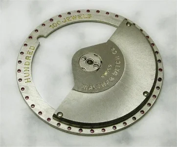

There is a fair bit to oiling a watch. You're correct its a very small amount used, indeed different amounts for type types/sizes, and its not all one kind of oil. Getting it right and controlling the amount is a big deal, takes special tools and experience.
The reason/logic is that the oil stays in place because of its surface tension, geometry of the jewel and amount of oil. All three need to be right or the oil runs off. I tried to explain this in the link above. The problem is this does not scale to indicators. Have a look at the photo of a typical indicator jewel beside the largest watch jewel I had (I have a lot to pick from lol). Its to big for the same surface tension mechanism to work so will run off in short order. Thats how hair springs get gummed up and the indicator starts feeling 'sticky'. that plus about 1 / 100,000the duty cycle compared to a watch
If you're going to service them every few years its all good and oil won't likely harm them....but is that is rarely the case that they get serviced/cleaned with most indicator users, so I maintain they shouldn't be lubricated
