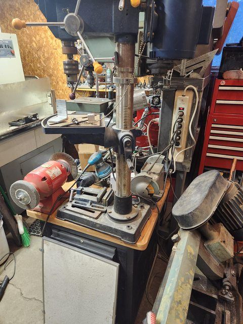

Right now I have this setup.
It "works" for now, but it definitely could be better. It's a much better arrangement than it was a couple months ago. I've learned over the course of my life that things need to be out and ready to go for me to be productive. I'd rather work in a messy, crowded shop where everything is out, plugged in and ready to go exactly when I need it than have to get tools out and put them away each time I use them. It's just the way my brain works. It's tough to accomplish in a small space, and compromises need to be made, but it's somewhat doable.
