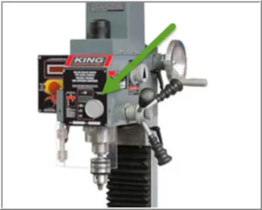

These machines are way better than a round column Mill drill but they do have some distinct disadvantages over a knee mill. The big one is I cant quite figure out how to plunge with an endmill to cut a keyway or a slot. You could feed in with the quill handle but thats not very rigid. And if you unlock the head and try to feed it in with the hand wheel you will be fighting the backlash in z if the cutting forces equil the weight of the head. It was enough to scare me away. Decent knee mills go for $1500 on kijiji every now and then. I didn't pay more than that for mine and it weighs over 2500lbs
Super good point Alex. I haven't looked at these particular machines up close... just assumed that's what the front knob was for. (So what IS the front knob for?). Conventional mill typically has some form of gear reduction on the quill to gradually increment depth. (You can also go drill press mode by releasing a tension knob, but for milling, yes fine feed is necessary).

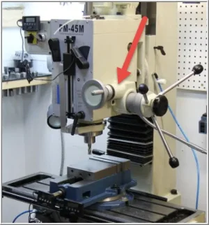

So this whole keyway grabby thing - are you guys saying problem is mostly averted by 'lifting' the table/work up into the endmill (kneemill) vs. feeding endmill down into work via the fine spindle feed ... or?
Isn't the bottom crank handle moving engagement distance via a screw in the same manner? Or maybe its because against the table weight its always zeroing out the backlash (and I assume head/quill is now locked). Hmm... I always assumed the lift handle was kind of a coarse 'get it roughly into position' thing & then you controlled depth on the topside the same manner for all mills. (Can you tell... I don't have a 'lifter' model :)

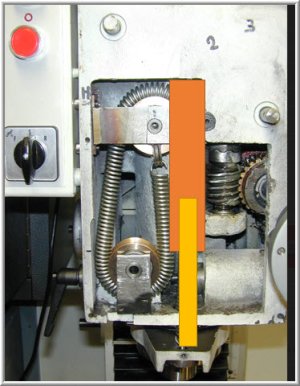

One guy on another form went to great lengths to try to work around that issue with his PM 932, it is an interesting read.
http://www.hobby-machinist.com/threads/pm-932m-pdf-experience.22195/
When I cut a slot on my PM 932 and hand feeding the quill was needed because the slot was closed a both ends, I would use a smaller end mill than needed and hand feed down in small steps until the totals depth was achieved. Then feed the table laterally to widen the slot to the correct size with the quill locked. This method makes it possible to get very accurate dimensions with little risk as the small end mill does not create much downward pull.
Janger I watch all of Keith Fenner's videos too. He's a very skilled guy and it's great that he is taking the time to pass along his experience and knowledge to others with his videos. When he makes a mistake he doesn't edit it out, he explains what happened so his viewers can avoid the same error.
Thanks John. Good link. Funny, I was just thinking along the same lines - 'anti-backlash spring'. He had a novel way of winding it up & hiding inside the box. My idea was a little <ahem> uglier. There aren't many easy solutions to this from what I can tell. You need some sort of worm gear to get the fine depth resolution & probably some mechanical advantage too. So any backlash - which any gear train is going to have to some degree - is going to see this issue to some extent. Hmm I'll have to pay more attention to this. But yes, I can now see in certain milling situations this is a heads up deal. I think maybe my 'partial friction' technique with the spindle lock nut wasn't solving the problem, but maybe dampening the kick? Mind you so far I haven't faced this plunging situation many times. But its inevitable.
I wonder if one could rig up a teeny 'gas spring'? Kind of like those weight lifting assist cylinders on my hatchback, but in reverse - giving some constant-ish force to the spindle? Probably hard to accommodate the z-travel range without a longish cylinder?
