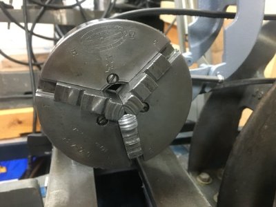

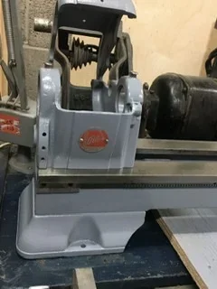

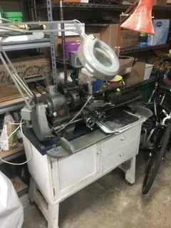

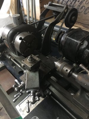

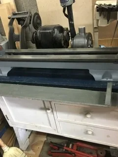

Bought this little lathe a few weeks ago. Took it apart to clean it up and just couldn’t put it back together without painting. It has some wear but is usable and limited to light duty. Came with custom made bench and drawers full of accessories. I have started the project already so I will post the pics that I have and maybe some more along the way. Enjoy!

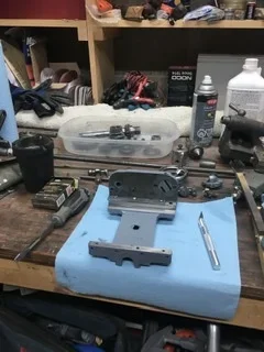

This is where it’s at today

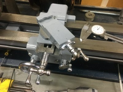

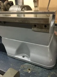

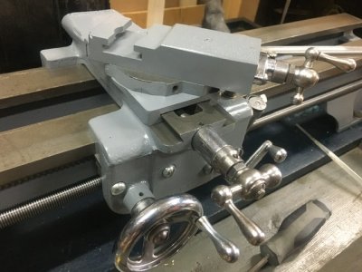

Progress!

trlvn
Looking good. Your compound slide looks a bit different. I wonder if it is from a later 'Mark II' lathe?
Mine looked like this before I repainted it:
Huizer
Member
I have noticed that the slide was different, missing those nice sweeping curves on top of the casting...
I also thought it might have been a DIY job but after cleaning it before paint but I don’t think it is. I guess it most likely is a Mk2 version.
The gibs were a pain though, they were bent and beaten. Tried to straighten and file as smooth as I could. Still not perfect might have to address later. It’s a very fine line between too loose and too tight!

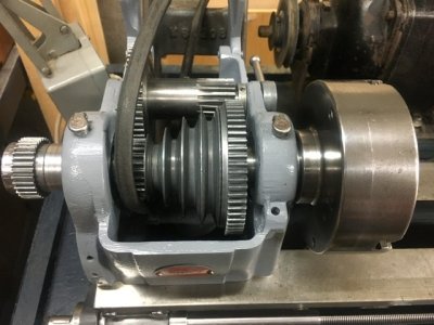

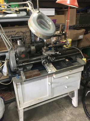

It’s been a while, but I got to work on the 618. Sort of forgot how the gears go on, checked manual, got them sorted I think. They are pretty noisy. Manual says to grease them but what kind of grease would you use? I have some red wheel bearing grease, would that work?
Also, couldn’t resist to put a piece of aluminum in and try a few cuts!
Dan B43AD704-2325-4E67-BB57-8241AB4F8200.jpeg 6264C50C-E6E6-430F-8007-D9A0D07AFBE3.jpeg
DPittman
I always use a red grease from princess auto on my lathe gears and I think it is totally adequate. I think practically any grease should be fine as the gears are not under great load and speed. I suspect others will disagree with me as to what is a suitable grease tho cuz well there just are different opinions.
Proper clearance between the gears and bit of grease should make them reasonably quite running.
francist
I believe in some of the Atlas literature the recommendation was a graphite grease but those are not so easy to find these days. I did get some from the UK a while back and that’s what I use.
However, there are many that will argue that grease is prone to swarf and chips getting stuck and thus embedding in the gear teeth, so they say a heavy or tacky oil is better. I’ve done both — the oil works fine but you need to apply it more often and it slings all over the place. Atlas machines are oily little critters at best, so adding to the party isn’t really what I wanted to do so I stick with my grease.
I sincerely doubt you will have any problem using your red grease. As said above, much is personal preference and what happens to be available or on hand. Anything is better than nothing.
