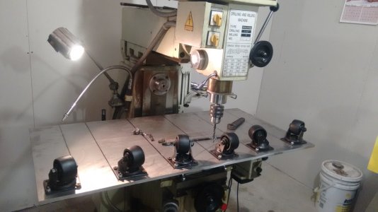

The project is to create some aluminum carts which are easy to carry but could also support a lot of weight. I thought it'll be handy to have one to move my milling machine and CNC lathe around.

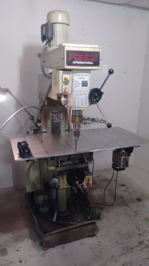

First I drilled 1 hole so I could bolts each castor into place.
After each wheel was in place I drilled the rest of the holes IMG_20151126_193434945.jpg
I will post again once I have one cart finished. I am going to try rounding off the sharp edges with a wood router. Has anyone tried a wood router on aluminum?

Here you go. Video evidence that the wood router works like magic
Looks great. Sounded like the router was slowing down a bit, that right?
Makes sense, it is carbide after all.
Thanks @Alexander I'm sure not all of us would be brave enough having not seen it first hand.
Alexander
Yeah it slows down a bit. This one has variable speed and I found around 20,000 rpm works best. It doesn't kick or make a mess as long as you hold onto it good. This router operates between 11k and 30k rpm

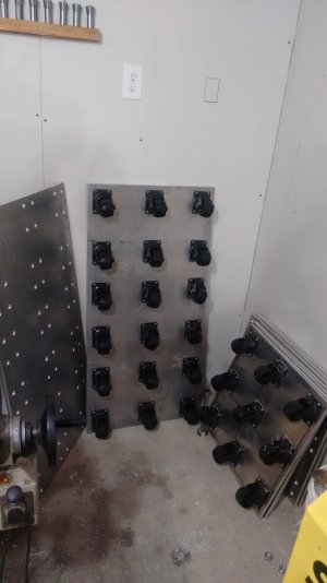

I have been a busy guy. With the help of a good friend we drilled and chamfered 575 holes this weekend. As for how much weight you can throw on the big one literally tons! IMG_20151130_165835368.jpg

The heaviest machine I own is probably only 2000lbs. These carts will be applied to much bigger tasks than just moving my little shop around.
