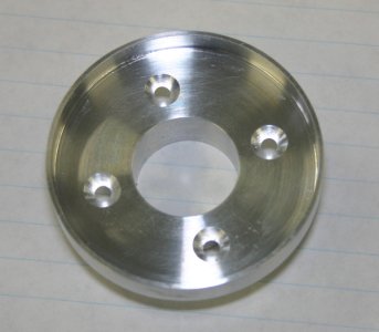

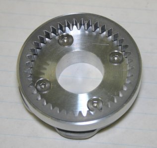

These (I guess you could call them 1-flute) cutters just seem to work with a lot more control. I had to do some very fiddly chamfering for M3 screw heads & I could control the chip right down to the thou. I'm not exactly sure how to sharpen them if you grind the whole body down, or if you can somehow dress the angled through hole which makes the cutting lip itself. They have some mystery coating that's kind of a bronze color, not like the gold TIN (or in some cases gold spray paint I swear LOL).

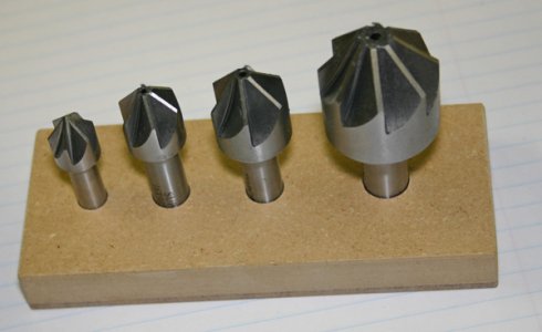

#5
Well, this topic came up on another forum so thought I'd post. Another fellow mentioned there is nothing wrong with multi-fluted cutters if they are of decent quality & used properly. By that he meant rigidly held, relatively slow rpm & controlled down feed. It occurred to me up until now, I mostly used them in my drill press (or drill press action in my mill) & moderate speed. So I gave it a shot in the mill at low rpm & fine down feed, work secured in vise with table locked. Sure enough, much better results. No harmonics so wavy peripheral cut. So I have become friends with them again & even made an MDF toolblock for unwittingly throwing them under the bus.
