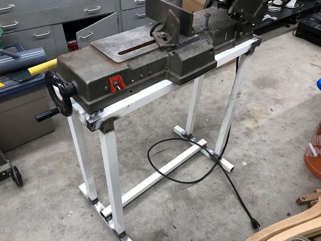

I hated the stamped metal stand on my bandsaw. It threatened to flip over at the slightest hint of imbalance.
So I chopped up a Gap display table base (the source of my steel bench top) and turned it into this stand.
Still needs casters, chip tray and brackets to hold the saw.

Aside from the flimsyness it was also too low to take advantage of my Ridgid saw support stand.
That looks like a really useful stand.
Did you MIG or TIG?
How is the saw mounted to the frame?
Looks like you made 45-deg miter on the top frame. How is that done? Like grind a bevel & fill with weld or just fuse it? (that's not the right word but I cant remember what the term is).

Thanks Pete!
I MIG welded it. I should have tried TIGing it but honestly I need more helmet time on coupons before actual projects.
I cut mitres for the top frame using the bandsaw. I scribed marks in the powder coating to make sure I had precise lines. I have done a bunch of work on my saw to make sure it cuts accurately. When the frame was dry-fit it was square using a 6' engineers square.
I clamped the frame to the edge of my table and tacked the corners. It stayed square so long as I didn't try and fully weld each corner.
I think I'm going to put casters on the back and adjustable feet on the front so your links are timely!

I already had the stand for use with my table saw so it just seemed obvious to use it for the bandsaw. One tool, two purposes.

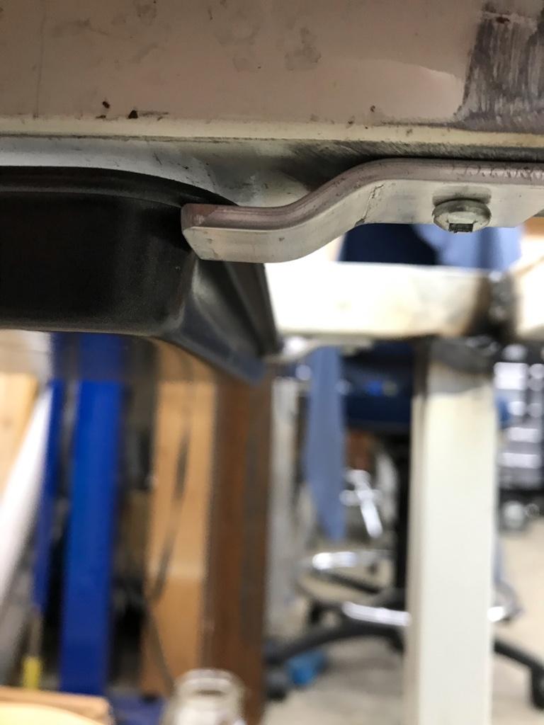

Made and installed the chip tray holders this afternoon.
DavidR8
Scrap maker

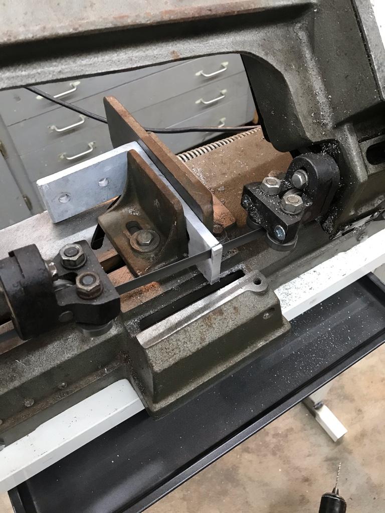

Chip tray in place, saw is bolted down.
Very sturdy. Just needs paint.
