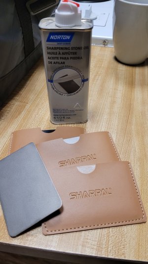

A coworker is a wood turner (dead tree carcasses are his jam)
We were discussing our tooling needs and uses between our two disciplines
He brought up sharpening, which I hadn't even considered. These Ali-xpress inserts are cost effective enough to almost not bother.
But he offered his kit for tuning edges, so I gave it a go last night.
Found a wore out insert in the swarf under my lathe, gave it some love on the 600grit card. It worked. Or at least I think it did. I didn't check what material the pin I turned was made of.
I'll shoot a quick video tonight...if I have time lol
KeeponDragon
Ok, so no video...but you can see it works not half bad...
I maybe put a dozen passes on each edge of the insert.
Wasn't trying for big DOC or anything. Ok, one pass at .020, but that was one time
@Dabbler thanks for commenting sir, nice to know im not the only cheap SOG here...

Could you describe the process in words if no video available. I'd be interested in trying it. Plus where do you get the sharply cards from. Thanks.
Hullo Tom, I purchased the 2 cards from KMS Tools here in Kelowna. They were on clearance, so it was a bargain at 35 bucks or so for the pair.
All I did, really, was a few drops of oil on the card, then ran the card against the insert in the same direction that stock in the lathe would travel against the cutting edge...
if that's NOT the correct way, someone will let me know right lol
