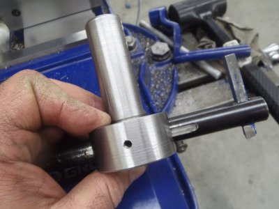

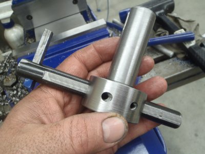

Here is a finished flycutter I made early this year... it is based on a design from Hemmingway. A similar design is sold commercially. The cutter holder is the 90° half of a double ended Busybee boring bar. The boring bar holder is machined from some awful gummy hot rolled round stock that I was happy to find a home for. The two set screws bored hold the boring bar in position. A groove and set screw on the back side limit travel. It can sweep just north of 7".
It is designed with a flat and is held in a 1" end mill holder. Alternatively, could have been left without the flat and held in a 1" (or whatever size you want) collet.

Thanks! There are a few gaffs in it, but nothing that affects the operation. It works very well but with shallow depth of cut only. Reasonable finish.
The tool holding bar is half of a BusyBee 1/4" lathe boring bar. They are less than $20 I think - 90° holder on one side and 45° on the other. I used the 90° half.

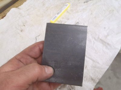

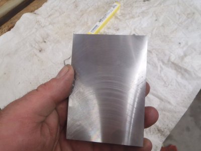

However, here is a pre / post shot of hot rolled steel, and a table for my Harold Hall grinding rest project... all surfaced with this tool.

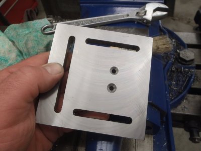

Also, using a (poorly designed / ground) trepanning tool... I cut these discs from light aluminum plate. The one with holes in it is a jig for repairing a garnish on a motorcycle exhaust. The jig held some threaded bushings so a friend could TIG them into place.
The numerous grooves were to get the sizing correct for the application...
