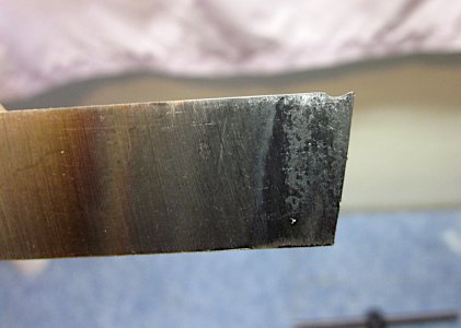

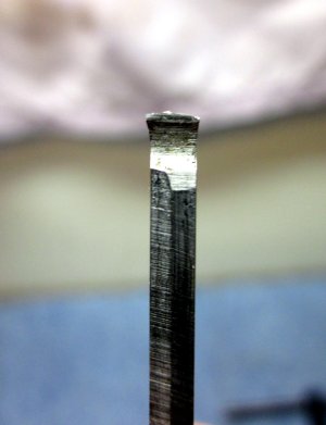

When I got my SouthBend 10K lathe years ago one of the things I could not do was part.
My employer hired a mechanic that many years prior was a machinist on an aircraft carrier,
back before carbide tooling. He told me to bring him my parting blade. He took the blade and
clamped it in the vice and heated the tip with a mapp gas torch to a dull red and peened
it slightly so it had a bit of side clearance, then he ground the cutting face slightly rounded.
He knew what he was talking about as I was able to part very successfully with it.
The blade pictured is a 3/4" Eclipse.
The tool holder I used it in is the steel block on the left with the drill chuck on the other side.

The tool @terry_g shows above is how I grind my HSS parting blades. But I like T-blades cuz they don't need to be peened.

It seem a lack of side clearance is also a problem, even with t-blades, likely due to heat expansion as cutting. Thus making the peened blade easier to use, and don't need to set blade at a perfect rite angle to work.
Many times while parting deeper cuts, have pulled back and shaved a little extra off of one side for clearance. But, not able to in every circumstance.
