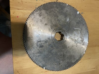

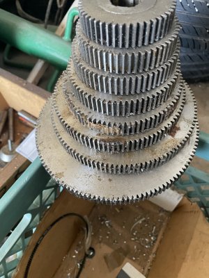

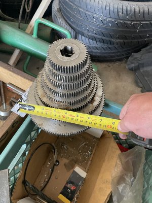

I love it when your I'm right gut instinct is so wrong and I am so glad I am able to put blind faith in Lapua's counting skills and not stare at a picture for an hour;).
Other than the odd number, that gear could still be used instead of a 127 tooth. The error would be less than 1%
Yup. 0.79%
But surely it wasn't intended for that. Just as easy to do it right.
forgive my ignorance, but why is 127 a special number for gear teeth?
There are EXACTLY 2.54 cm in one inch. 254 / 2 = 127. So a 127 (or a 254) gear provides for a perfect metric imperial conversion.
A 254 gear is too big. 127 is the smallest gear that can serve this perfect function.
in combination with a 5 tooth gear? Surely it is the ratio that matters. This must be some kind of standard that I know nothing about
Yes, it is the ratio that matters.
Maybe it's obvious, maybe it's not. But after you have a gear that provides for an exact conversion, you can then add any number of other gears to get to the desired metric or imperial pitch.
But 127 is the smallest gear that will get you to an exact conversion. It isn't a standard per-se. It's just an exact mathematical conversion factor that needs to get stuck into the gear train somewhere.
If you write out a formula for getting any pitch from metric to Imperial, that formula will contain 254 or 127 or some multiple of that. That just the way it is. We can be grateful that it's not some flaky number like 2 276390234767.
